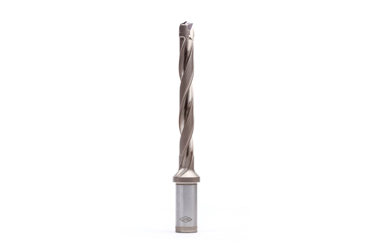

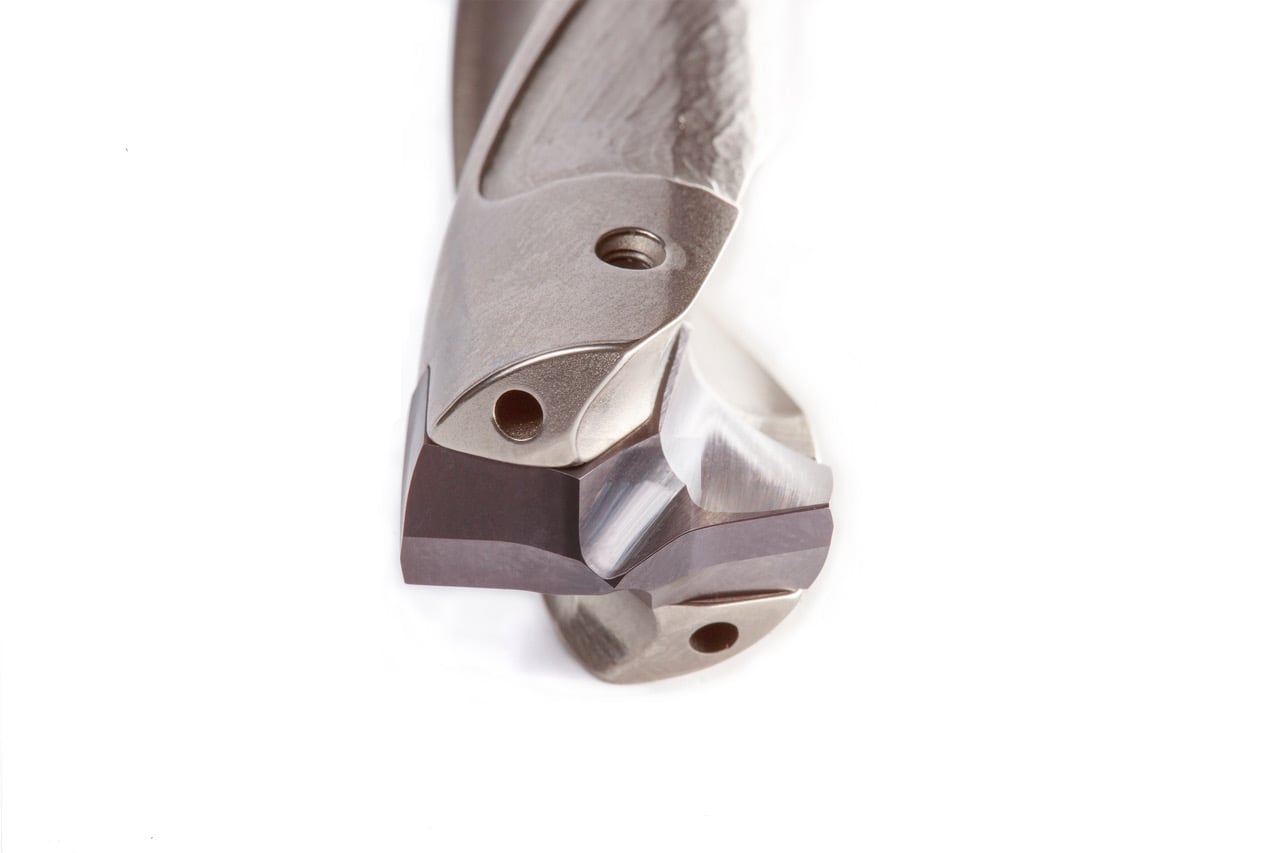

QTD indexable insert drill with pyramid tip
If steel is to be machined in unstable machining conditions while using the smallest possible amount of carbide at the same time, MAPAL offers a new indexable insert with pyramid tip for the indexable insert drill QTD. Due to the tip, the indexable insert centres itself; reliable bore entry is therefore ensured. The coating on the new indexable insert is also specially adapted to the machining of steel. In this way the wear resistance is significantly increased. The result is very long tool lives.
