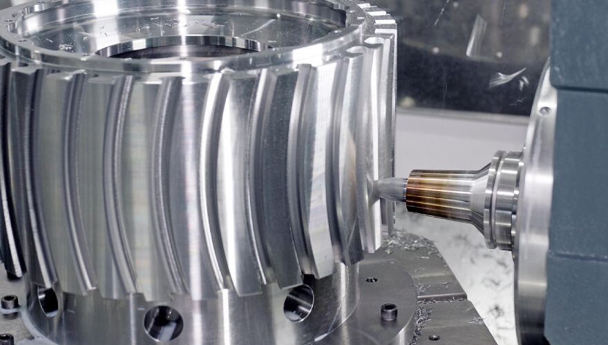

Since late 2023, Heller has been expanding its F-series lineup to meet rising industry demand. These machines offer outstanding productivity within a compact footprint. Highlights include acceleration up to 7 m/s² and positioning accuracy as tight as 6µm in the X, Y, and Z axes. Despite their space-saving design, the machines boast a large working volume relative to their size, allowing users to take on larger, more complex workpieces without sacrificing space.
A key feature of the F-series is the optional turning function, which enables true one-hit machining. This high-torque rotary table supports combined turn-milling operations at up to 700 rpm, enabling external and internal contouring, thread cutting, undercutting, and recess machining — all in a single setup. This integration dramatically improves precision and reduces cycle times by eliminating the need for part transfers between machines.
