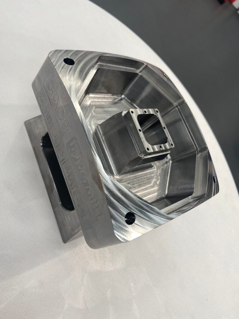

One standout demonstration featured the VQJCS chip-splitting end mill, run on the GROB G350, showcasing exceptional performance and precision. The full machining setup included:
  • Machine: GROB G350 Universal Milling Machine
  • Workholding: LANG Vice
  • Toolholding: Schüssler High-Precision Collet Holder
  • Tool: VQJCSD1200 (12mm diameter with 36mm cut length)
Cutting parameters for this demo included:
  • Entry: Helical at 5 degrees to a depth of 36mm
  • Strategy: Trochoidal milling
  • Cut depth (Ap): 36mm
  • Step over (Ae): 1mm
  • Cutting speed (Vc): 400 m/min (12,740 RPM)
  • Feed per tooth (Fz): 0.2 (Max feed rate: 12,740 mm/min)
The G350 handled the application with ease, thanks to its compact footprint, horizontal spindle design, and integrated rotary axes, the G350 delivers high-precision machining ideal for complex part geometries. The combination of this advanced machine with MMC’s chip-splitting tooling resulted in efficient chip evacuation, low cutting forces, and outstanding surface quality.
