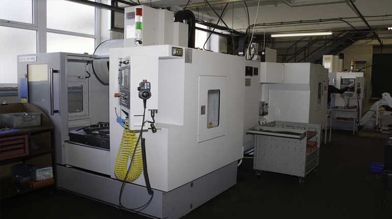

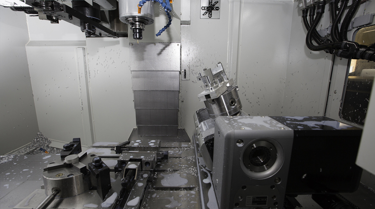

As an already a committed XYZ Machine Tools customer, with nine machines installed, when Restormel Machine was approached with some new work that would benefit from five-axis machining it turned once again to XYZ. While XYZ’s UMC-5X simultaneous five-axis machining centre is the flagship of XYZ’s VMC range, Barry Kennett didn’t feel that he was ready to go to full five-axis, space was also a limiting factor. Therefore, he looked once again at the XYZ 710 VMC, of which he already had two, one of which with fourth-axis capability. “Five-axis was definitely the next step for us but with the pressure on space and our experience going with the 710 VMC with a Lehmann five-axis unit fitted was the right move. This met our immediate requirements and has also opened other opportunities to bring in five-axis work. Additionally, while the move to five-axis was a learning curve it has also encouraged us to review existing work that we machine using three- and four-axis machines. The result is we are finding are significant improvements on cycle times.”

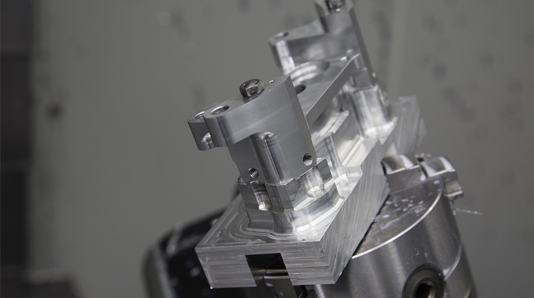

These savings are highlighted by one component that was machined on a combination of three- and four-axis machines, total cycle time across the two set-ups was 2.5 hours. By transferring this to the XYZ 710 VMC, with the Lehmann fifth axis unit, this cycle time was cut to just 50 minutes. In addition to improved machining times, having the additional axis also allows single set-up machining to be carried out, bringing additional productivity gains, with work in progress reduced as parts are not waiting around for the next operation. “Having this capability has definitely helped us to not only secure existing contracts, but to win new business,” says Barry Kennett.

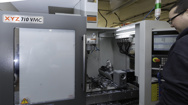

Another benefit of choosing the XYZ 710 VMC is the Siemens 840D ShopMill Control. Like many businesses finding the right skilled people is a challenge, one that Restormel is addressing through apprenticeships. The Siemens control with its ‘JobShop Concept’ helps to overcome any skill/experience issues as it is truly conversational and provides easy to understand prompts in order to create simple and complex programs in the background. The end result can then be viewed in plan, three-planes or full 3D, to provide the reassurance that a user may need. “The control is so easy to use and straightforward enough that our operators are able to switch from other machines using different control makes. So confident in it are we that the machine is operated on a regular basis by one of our apprentices, who is using it to advance his skills-set, when he is not at college he is setting, programming (in five axis) and operating the machine without any issues whatsoever.”
The XYZ 710 VMC installed at Restormel Machine features axis travels of 710 mm x 450 mm x 500 mm in X, Y and Z, with a table size of 760 x 430 mm, which they make full use of, with multiple set-ups on the table at any one time. Based on a solid cast iron structure, the machine features box slideways on all axes, the rigidity generated by this construction allows Restormel Machine to maximise available cutting tool technology with increased cutting data. This is backed up by the 23 hp/ 17 kW, 8000 revs/min spindle, 20 m/min and 24 station arm-type tool changer fitted as standard.
