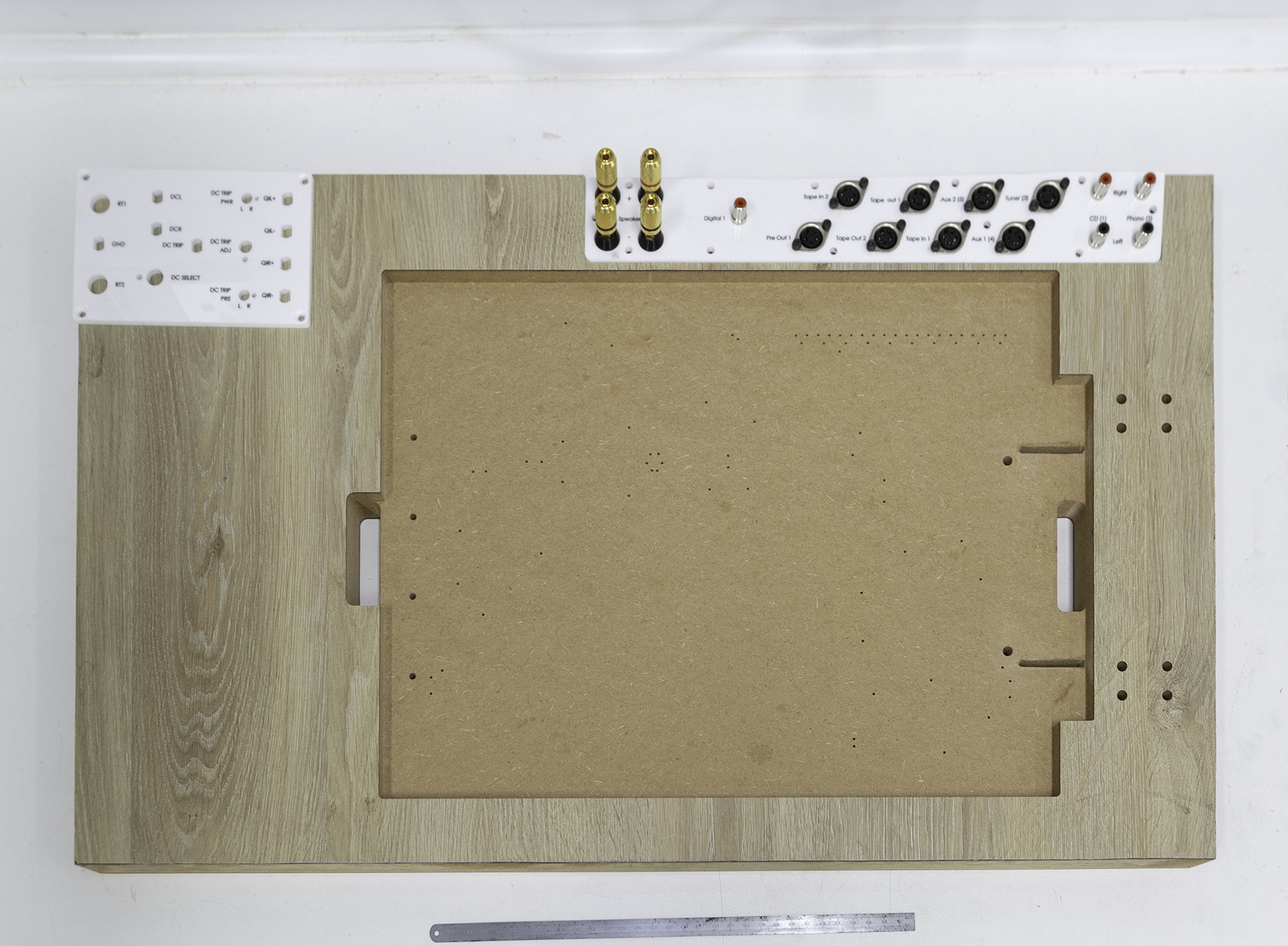

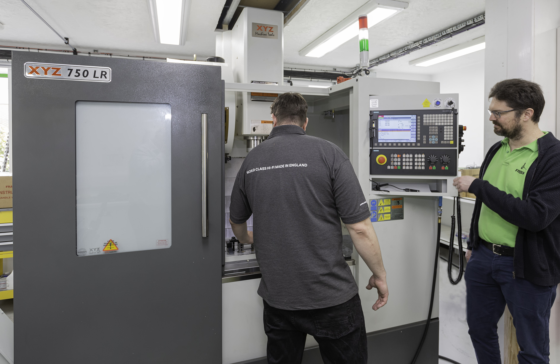

This significant growth added pressure to Rega’s Toolroom, which was populated with manual machines to produce assembly jigs and test rigs, as well as some prototype machining. A move to CNC had been on the cards for many years, but had been put off for several reasons, particularly lack of space. A re-organisation combined by the increase workload finally allowed the purchase of an XYZ 750 LR vertical machining centre to go ahead. The machine will be used on a variety of materials from aluminium, High Pressure Laminate through to MDF, so Rega opted for the 12,000 revs/min model and, for added versatility, the 4th axis and 24 position arm-type toolchanger options. The XYZ 750 LR is fitted with linear rail technology, which like Rega’s products combines performance with value for money.
“We had been looking at introducing CNC to our toolroom for several years, we did our research, as we do with all our suppliers, and while the machine was important, ongoing support and service was a priority. This resulted in a short list of one, XYZ Machine Tools. During our search we kept coming back to XYZ and in the end it became a straightforward choice due to the confidence we had in their ability to support us with technical help and after-sales. We also received glowing reviews from our existing component suppliers. Another factor that made the decision easier was that during the quotation process they didn’t try to upsell to us, we indicated an interest in their HD machines, but they did the right thing and sold us the machine we needed, not what we thought we wanted.” The after sales service was immediately put to the test for the delivery of the machine, which due to limited access had to be stripped back to its carcass then re-assembled in-situ, a process that took just four days from unloading to powering up and running.

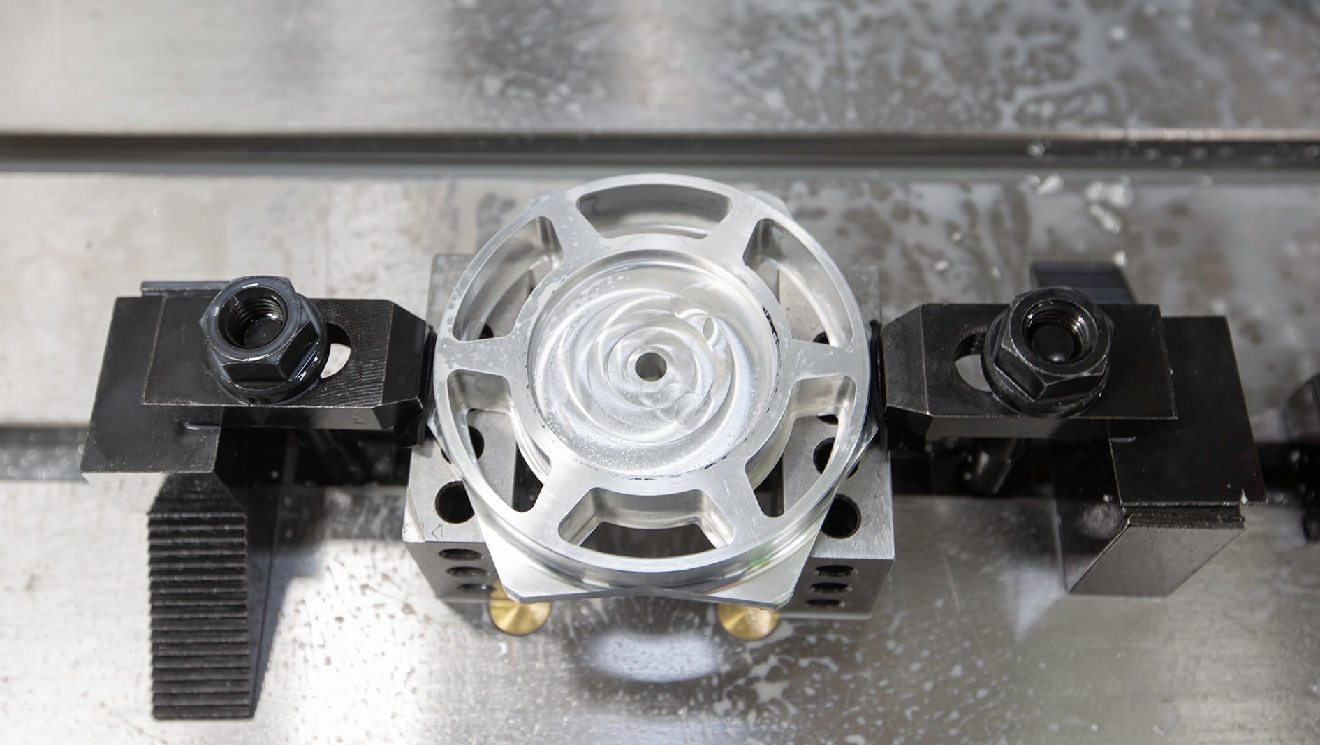

Throughout the pandemic focus was on delivering products to meet demand, so product releases were put on hold. Now, with a degree of normality returning, new products are on the horizon with new turntables and amplifiers due to be launched in 2022. This will see an increased workload for the XYZ 750 LR in terms of machining development parts and the testing fixtures that will also be needed. Having the machine will enable Rega to respond quickly to change, and to meet the increased demand from its assembly department, where demand for fixturing continues to grow. There are no plans for the XYZ 750 LR at Rega to be used for production work, but it is filling a need for re-working existing stock component that may need rectifying or adjusting. A recent example was a batch of plinths that were found to be out of concentricity tolerance on two bores. “The obvious solution was to return the entire batch to our supplier, but that isn’t the Rega way of doing things,” says Ky Gandy. “We respect our suppliers and accept that occasionally errors arise, so we took the decision to rectify the parts ourselves. We used the XYZ 750 LR to manufacture a fixture, which it was then able to use to rework the parts to within microns. Something that saved time and money thanks to the efficiency of the machine and the input from Dan Ware, who joined us specifically to run the XYZ machine.”
