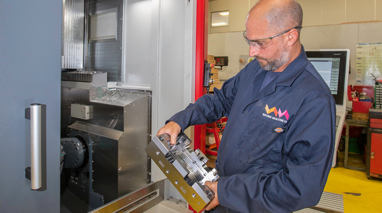

“We started investigating purchasing a five-axis machining centre about 18 months ago,” says Investment Casting Systems’ Technical Director, James Head. “Initially we were looking at machines with up to 2M table capacity, but our customer profile changed, which meant we didn’t need such large capacity, which opened the door to the XYZ UMC-5X with its 600 mm diameter trunnion rotary table and 600 mm axis travels in the X and Y axes.” The move to simultaneous five-axis machining immediately brought the benefit that Investment Casting Systems was looking for, increased efficiency. The very first job that went on to the XYZ UMC-5X was a complex bolster for an injection mould tool that required machining on all six faces. Using existing three-axis machines would have required six set-ups, this was reduced to two on the XYZ UMC-5X. The result was a saving of 60 per cent in manufacturing time, elimination of any potential inconsistencies from multiple set-ups and, by making use of a fixture plate all faces were machined from they same datum point.

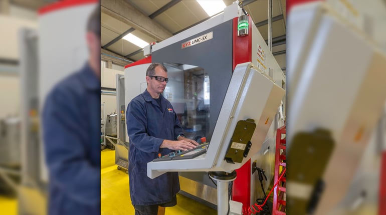

“This first experience proved we had made the right decision in going to five-axis to gain efficiency in manufacturing,” says James Head. “We have seen similar time savings as we have progressed. Making this move we knew it would be a steep learning curve, more so with the offline programming element as our CAM system didn’t have a post processor available. XYZ worked with VISI to develop the post processor we needed on-site. In terms of operating the machine itself, there were no issues as our Tool Makers took to the Siemens control straight away, with minimal training over two days at XYZ’s factory in Burlescombe. In terms of the overall integration of five-axis into our system we recognised that that we just had to start thinking in a different way, approaching jobs with a fresh mindset and accepting the challenges and possibilities that five-axis presented.”
