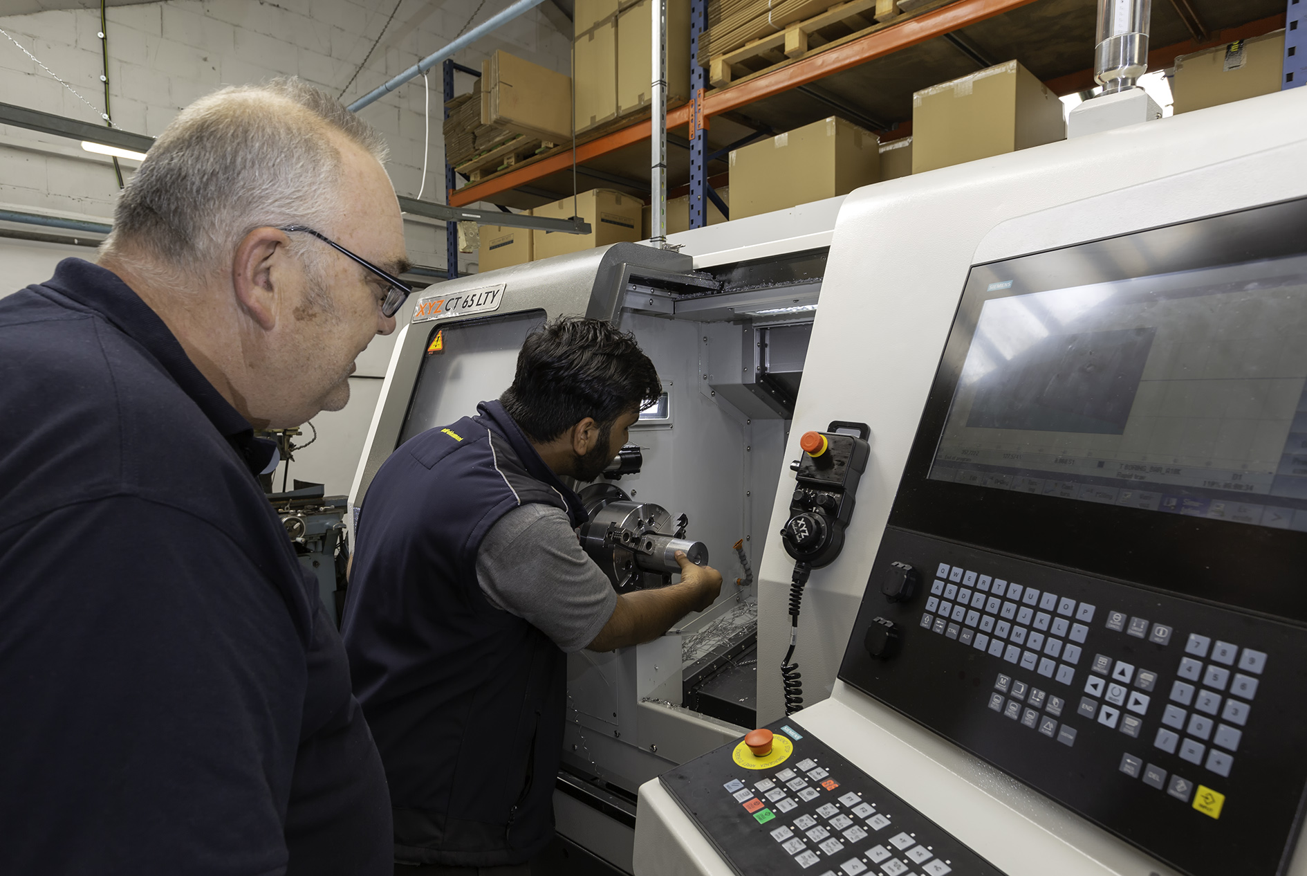

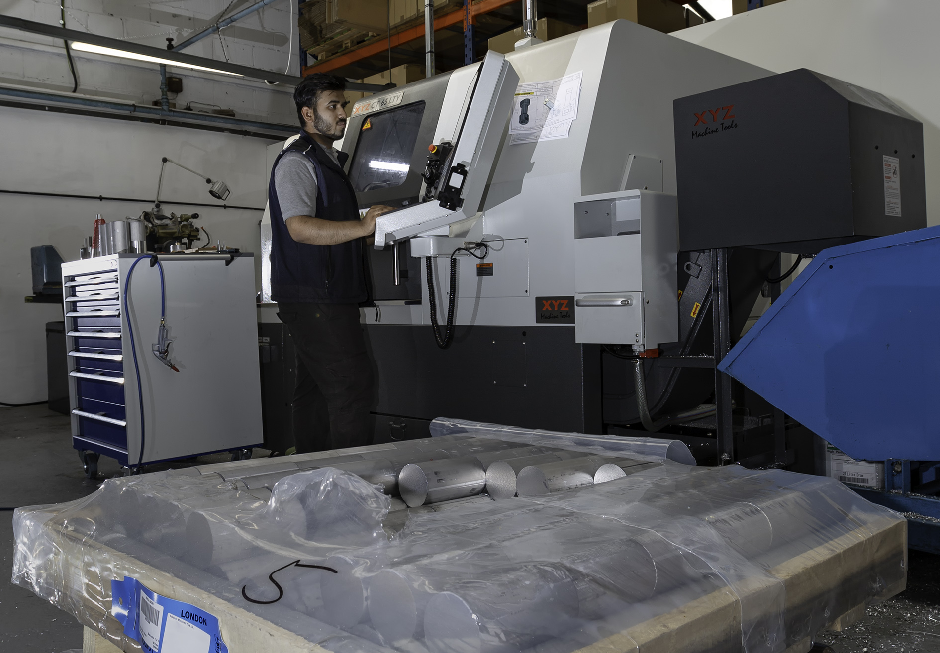

The most recent investment has seen the arrival on-site in June of this year of an XYZ CT65LTY turning centre for use within the toolroom. This machine with its compact footprint combined with high-specification, such as the Siemens 828D ShopTurn conversational control, 70 mm of Y-axis travel and 400 mm swing, makes it a highly versatile turning centre. Other standard equipment includes a 200mm hydraulic chuck, 12-station VDI turret all with live tooling capability, Renishaw tool setting/probing, swarf conveyor and fully-programmable tailstock. “We needed a machine that could machine parts in a single hit to reduce development time and labour costs,” says John Collier. “The simplicity of the control on the XYZ and our use of offline programming means we can quickly produce batches of 10-off prototypes and confirm the design is suitable for our customers’ needs as well as ensuring it is production ready, when we may machine batches of over 1000-off. The one-hit capability of the XYZ CT65LTY generates much greater efficiency within the toolroom, the ability to make things ‘just-in-time also allows us to provide a quick response and improved service to customers.”
The arrival of the XYZ CT65LTY brought with it an additional bonus when another local company heard about it. “We only took delivery of the machine in June, but word soon spread and we were approached to see if we would be interested in taking on some sub-contract work,” says Jon Norton, Engineering Manager, Monument Tools. “This was for some quite complex turning, with tapers on external and internal surfaces, but we quickly got the program right and we are working through the batch now. This work has overtaken our own development work somewhat, but it is a result of the ease of use of the XYZ CT65LTY, and the Siemens control, that we were able to take on this intricate work so soon after taking delivery of the machine.”
The machine’s ease-of-use is also a factor in Jon Norton’s plans to use it as part of the training for the company’s six apprentices, who all experience every aspect of the business from injection moulding, CADCAM, basic milling and turning as well as operating the range of CNC machines in the factory during their training. “CNC holds no fears to the apprentices we have and, the XYZ machine will add to their fully-grounded knowledge of all of our processes. The planned short runs for our research and toolroom work means they will gain experience quickly.”
