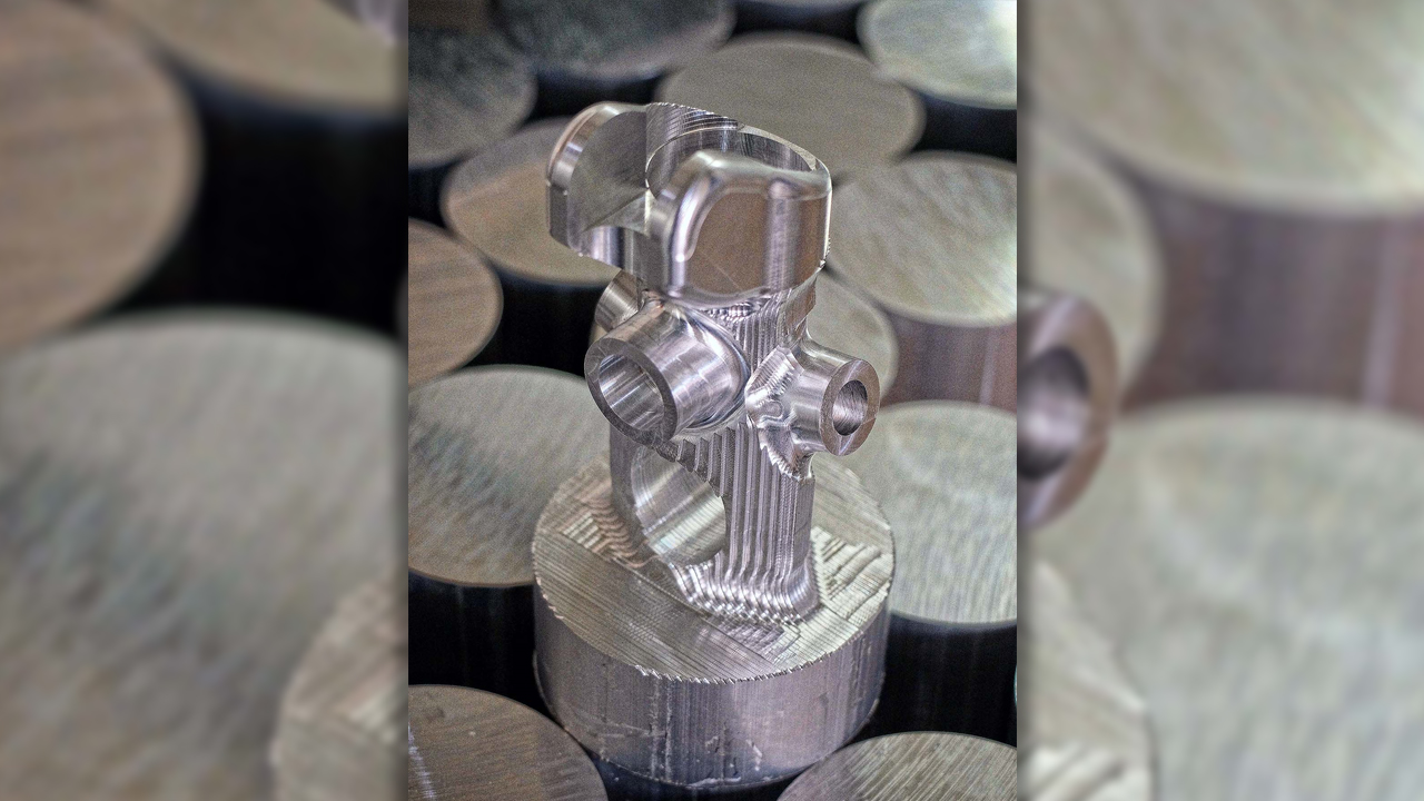

The company could therefore not have moved further away from its comfort zone when it decided to manufacture two new families of prismatically-machined components from solid aluminium billets, namely master cylinders and radially mounted brake calipers.

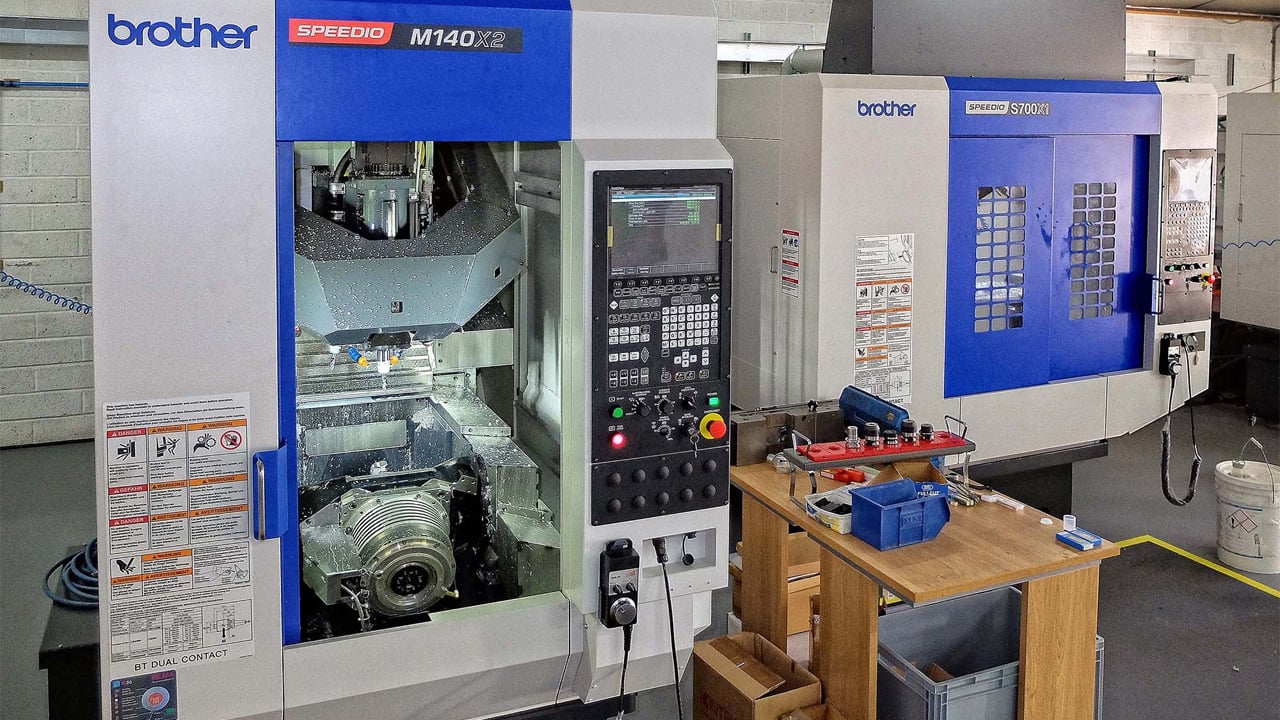

Supplied with tooling, fixtures and programs, two are S700X1 4-axis, 21-station turret-type models installed in March and June 2018, while the third is an M140X2 trunnion-type, 5-axis machine with a 22-position tool magazine, which arrived in August.

Cutting feed in the 700 x 400 x 300 mm axes of the S700X1s is 30 m/min, rapid traverse rate is significantly faster, and tool change is 1.4 seconds chip-to-chip, performed at the same time as X and Y axis movements and rotation of the indexer. The machine sits in a compact footprint of slightly more than 4.5 square metres on the shop floor. Brother's latest CNC C00control provides fast processing, a wide range of functions and high machining accuracy.

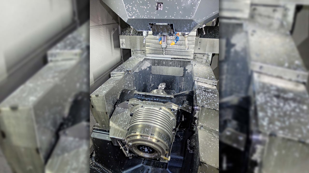

The M140X2 has the same control and is similarly fast throughout its 200 x 440 x 305 mm working volume. Cutting feed rate is identical and non-cutting motions take place simultaneously in all five axes to minimise idle time. The spindle has a 0.2 second start / stop time, while the turning table accelerates from zero to 2,000 rpm in less than 0.3 second. A trunnion holding force of 400 Nm without the need for mechanical clamping delivers high speed indexing combined with rigidity when milling parts at an angle.

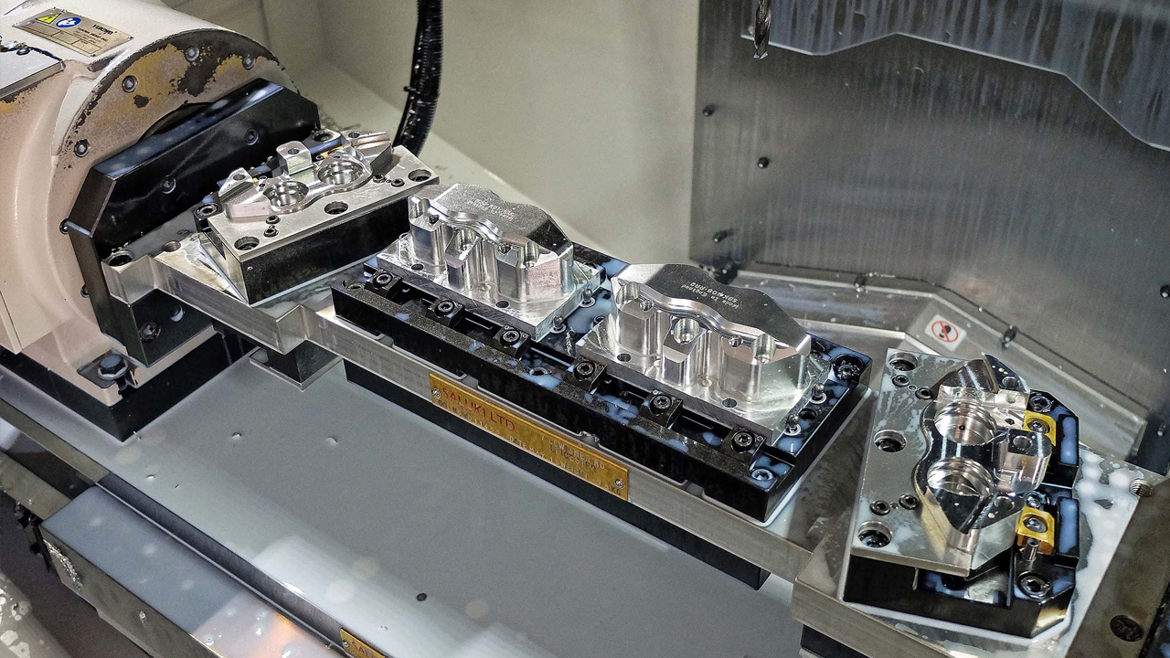

The S700X1 machines are currently devoted to producing either '100' or '108' caliper sets in two operations using bespoke, 4-station fixtures on either side of a trunnion, so two complete components come off each machine every time the doors open. In the M140X2, one master cylinder is produced in two operations in a total cycle time of one hour.

Mr Lane concluded, "While many aftermarket parts in our industry are produced from castings or forgings, we specialise in machining ours from solid billet. Customers really appreciate the beautiful fettled finish we achieve and often visit to see the parts being made.
