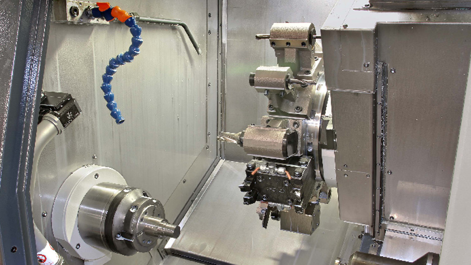

Looking at the cuboid aluminium components produced for medical diagnostic equipment by subcontractor AES Precision Engineering (www.aes-engineering.co.uk), one would think they were milled, drilled and tapped on a machining centre rather than a lathe; indeed they used to be, from sawn billet in two separate operations on a pair of 3-axis vertical-spindle machines in a total cycle time of 12 minutes.
Since April this year, they have been machined complete from round bar in one operation in an Italian-built Biglia B565-YS 6-axis turn-mill centre supplied by UK agent Whitehouse Machine Tools (www.wmtcnc.com). Program run time has more than halved to 5.5 minutes, accuracy is improved and there is no handling between machines or work-in-progress on the shop floor, significantly reducing the cost of production. Only two turning tools are in the 12-station turret for facing the bar end and for parting off, the remainder being axial and radial driven tools.

Key attributes of the twin-spindle, single-turret machine that secured the purchase are a full (rather than indexed) C-axis on the counter-spindle, essential for this particular job; and a genuine Y-axis, so there is no need for time-consuming and less accurate interpolation of the X and C axes to achieve the prismatic shape of the component.
