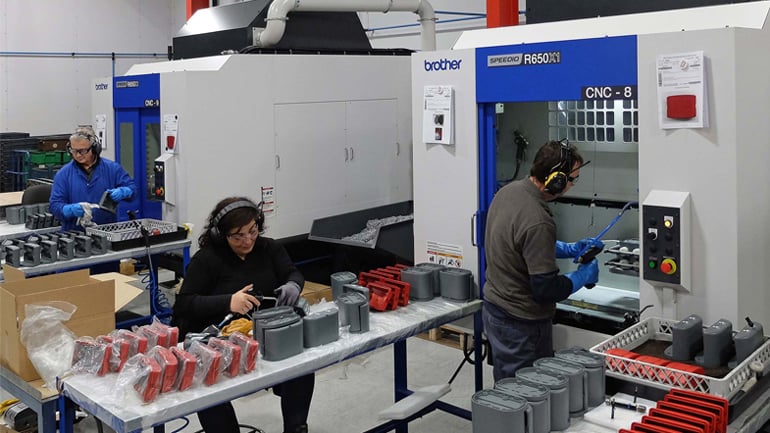

After they visited the agent’s Kenilworth showroom and technical centre at the end of 2016, they came away not only with up to date information on the new control’s capabilities, but also having ordered another Brother machining centre, a Speedio R650X1 with Nikken rotary 4th axis. It was not their intention before the visit, but the machine was so productive and such a good fit for RD Castings’ needs that they placed the order on the day and invested in a second identical model within six months.
Numerous facets make the machine particularly applicable to machining light castings, one being its outstanding speed. Workpiece changeover is completed entirely within the 3.4-second rotation of the twin-pallet Quick Table, as the 21-pocket magazine’s 0.9 second tool change time, 50 m/min rapids in X Y and Z, and rotation of the 4th CNC axis are carried out simultaneously.

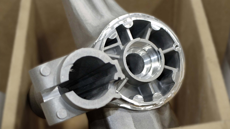

To underline this comment, he pointed to a casting of about the size that used to need a second operation but is now machined in one 4-axis process, saving 70 pence per part.
Simon Hale, CNC machine shop manager, stated that productivity of another part – an aluminium die cast housing for the rail industry – has been nearly doubled using the larger machine compared with the other Brother models with similar tool carousels. 17 castings per hour were drilled and tapped using 12 tools on the latter machines, whereas using a trunnion fixture on an R650X1, 32 parts per hour come off the machine after each pallet rotation and just eight tools are needed.

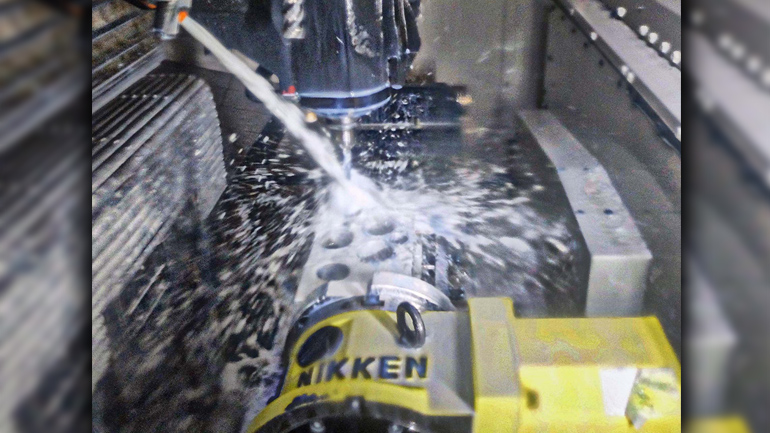

The increase in output is partly because, by routing coolant at the uprated 30-bar pressure on RD Castings’ latest machines through an indexable-insert drill rather than employing a twist drill, it is possible to produce larger holes above 18 mm diameter in one spindle movement, rather than having to spot and then peck drill the holes multiple times.
