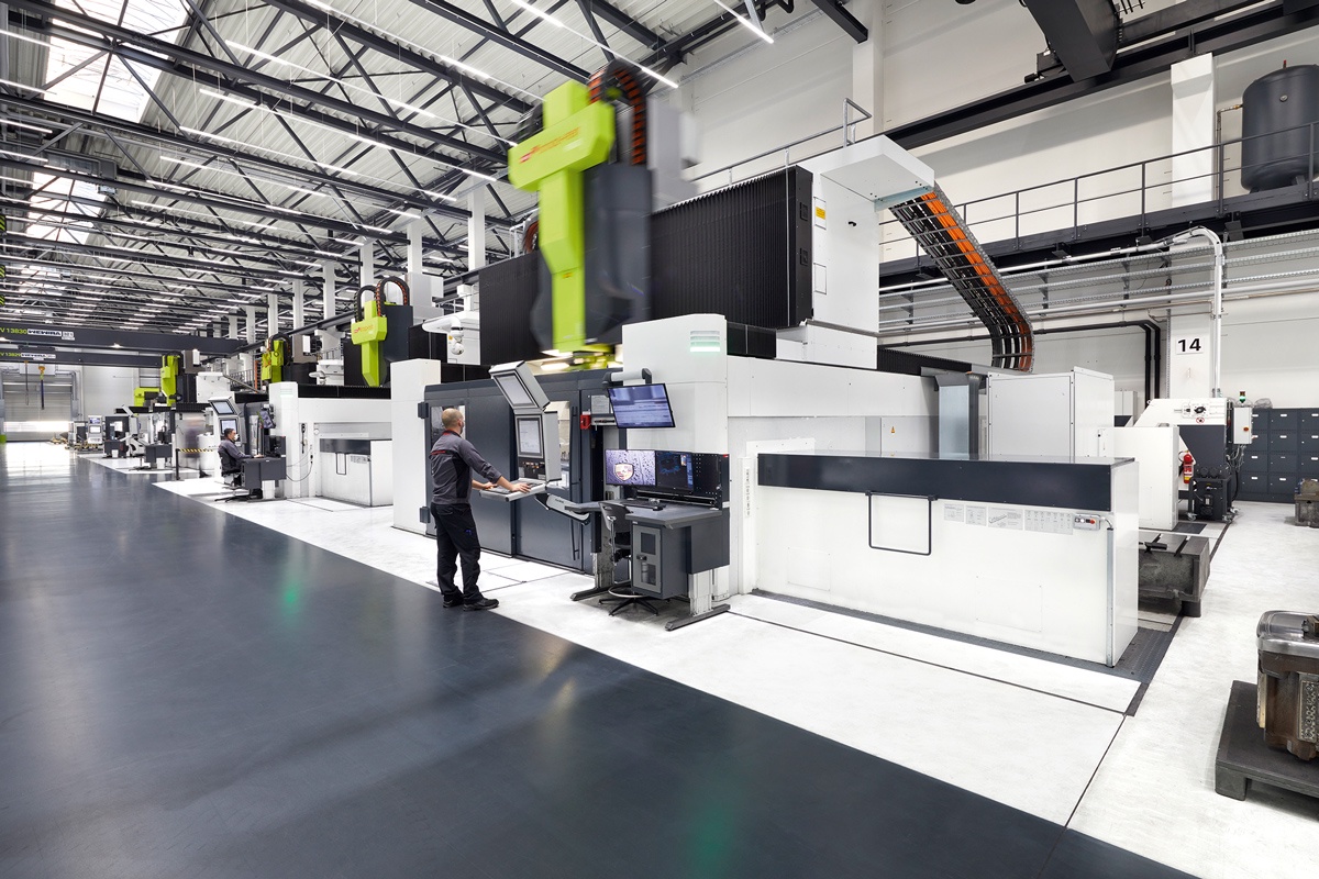

A premium car manufacturer should have a premium engineering plant. To ensure that the Porsche Werkzeugbau GmbH Schwarzenberg plant fulfils all of the preconditions for this, €40million was invested over the last five years to develop the tool-engineering plant to the highest possible level following the transition from KUKA. Among other things, the Schwarzenberg-based company used this money to set up two new production halls, purchase a new 25,000kN servo press for production-related tool try-outs and invest in retrofitting and new machine tools – including two Starrag HSC centres of the Droop+Rein FOGS 35 68 N40C type. In addition to this, mechanical production was completely overhauled and the production processes were restructured.

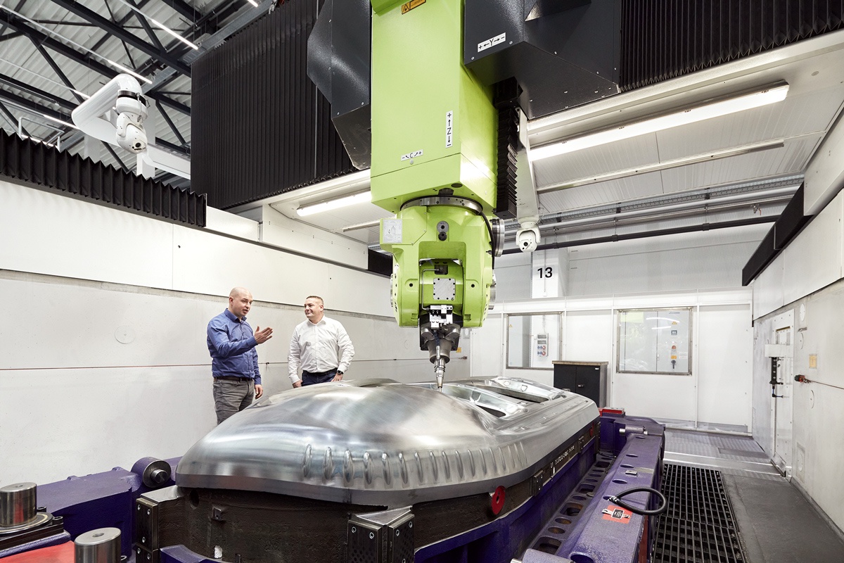

Marco Franz, Head of Mechanical Production, points out some important reasons for this: “For some years, we have been experiencing a shift towards lightweight construction and, as the Porsche competence centre for forming technology in the moulding skin area, we were commissioned to develop the tools required for the conversion to an aluminium body. During forming, aluminium sheets respond much more sensitively than steel, which created big challenges for us when it came to tool engineering. Our existing machines were not able to meet some of the requirements”. Two new high-speed machining centres for finishing the pressing moulds should fulfil these new requirements regarding surface quality, accuracy and speed.

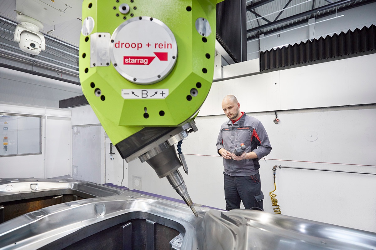

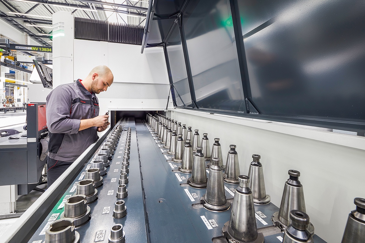

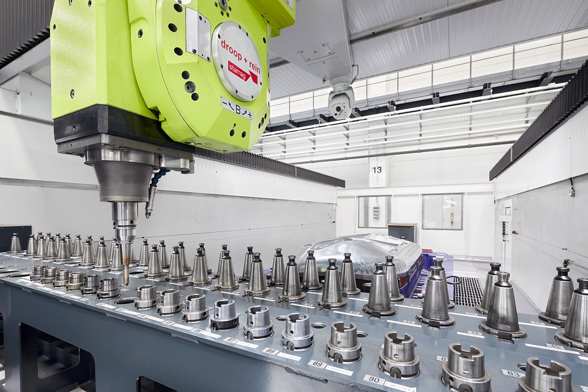

Ultimately, the decision-makers opted for two Starrag Droop+Rein FOGS 35 68 N40C high-speed machining centres. These 5-axis machine tools are designed for finishing, have an overhead gantry and offer traverse paths of 6.8 by 3.5 by 1.5m along the X, Y and Z-axes. The equipment includes a tool magazine with a total of 100 places that can be filled with HSK32, HSK63 and SK50 retainers, as well as an eccentric fork head with a 40kW milling spindle and a high torque of 700Nm, and three different motor milling spindles with speeds of 18,000, 40,000 and 65,000rpm. In addition, for one of the two machines, Marco Franz ordered a special 6,000rpm angular head that can be used for machining areas that are difficult to access. “With this range of spindles, the requirements of the coming years are covered”, Lutz Kramer is certain.

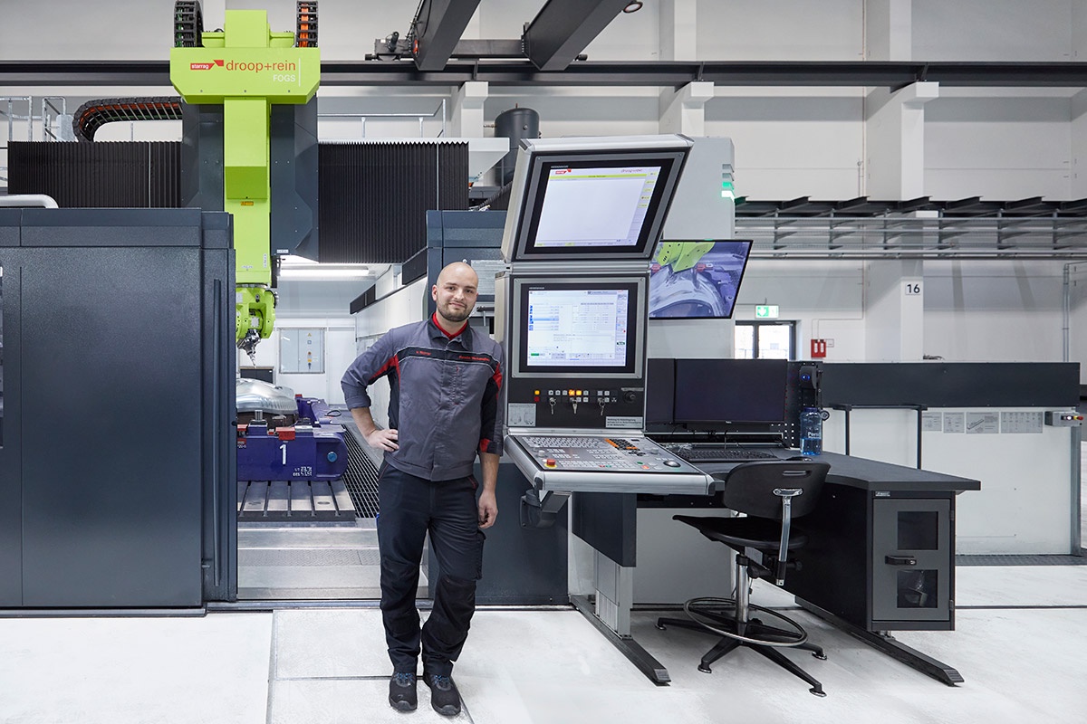

Once the machines were installed, the two companies began fine-tuning the workflow together, taking into account the characteristics of CAM, the control system and the machine. This was necessary because achieving the best surface quality requires a high level of accuracy on the path, even at the highest feed speeds. For this, it was important to illuminate the interfaces between CAM and NC and to work with experts from the control system manufacturer to optimally adjust their functionalities in line with the process requirements.
This interdisciplinary approach and the combination of sophisticated drive optimisation in conjunction with the proven machine technology of the FOGS series was extremely successful. The result was not only a class-A surface but also a very high level of accuracy – at the highest path speeds of up to 16m/min on the free-form surface. The processes have been running stable ever since. Lutz Kramer is delighted: “It took a long time to achieve stable processes, especially when it came to the forming tools for aluminium parts because there are many factors influencing this. But Starrag assisted us until we were sure we had reached our goal.”
Marco Franz adds: “I wouldn’t have believed it at the start but Starrag was able to implement more than 90% of our wish list. So it was a good decision to invest in the new Droop+Rein FOGS machines. We are now faster and more precise and achieve – depending on the component and the geometry – outstanding surface accuracy.” The head of tool and mould-making confirms: “We are proud of what we have achieved with Starrag. With the Droop+Rein FOGS machines, we have attained the desired improvement in quality and were also able to reduce the manual bench work of the toolmakers by roughly 20% in the follow-up process. These are strengths that make us one of the top teams in the Champions League of large-tool-engineering plants.”
