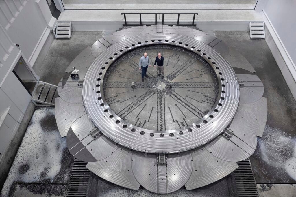

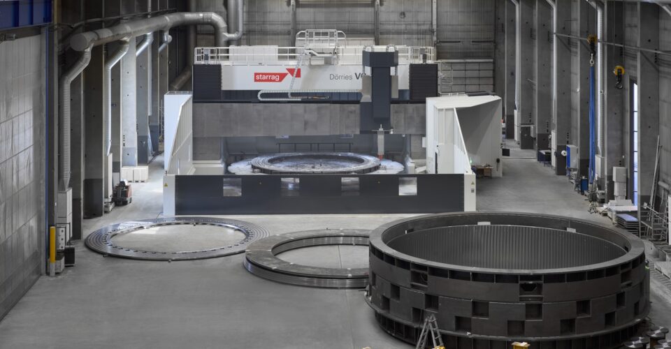

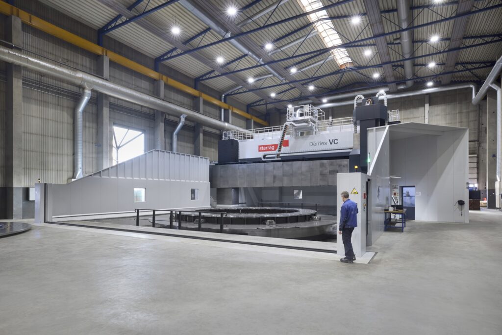

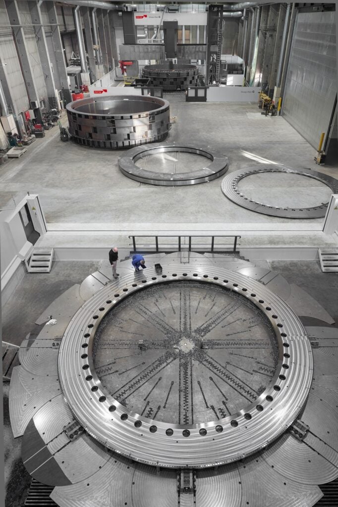

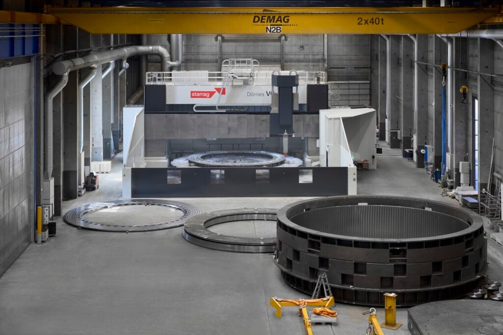

A large Droop+Rein gantry machine with a travelling gantry, capable of flexibly machining very large workpieces in a single clamping operation, has been installed and running since the beginning of 2024. Recently, it has been complemented by another very large Dörries gantry machine with a fixed gantry and sliding base. Despite their differences, both machines share the same core components, simplifying maintenance and operation.
The new large gantry machine significantly expands HACO’s machining range. Thanks to its enhanced main drive and increased swing diameter of the workpiece, it is now possible to manufacture larger welded rotor housings and other substantial components with precision. “Our two large machines – two true giants – are now in production,” says a delighted Hubert Erz, Senior Consultant Sales/Renewables at Starrag. “We are setting a new benchmark in machining workpieces for gearless wind turbines in the 14 and 15 megawatt power classes. The focus here is primarily on rotor housings, generator housings and brake discs, both of which currently have a diameter of around 9m and are manufactured with an accuracy range of +/- 0.1mm.
