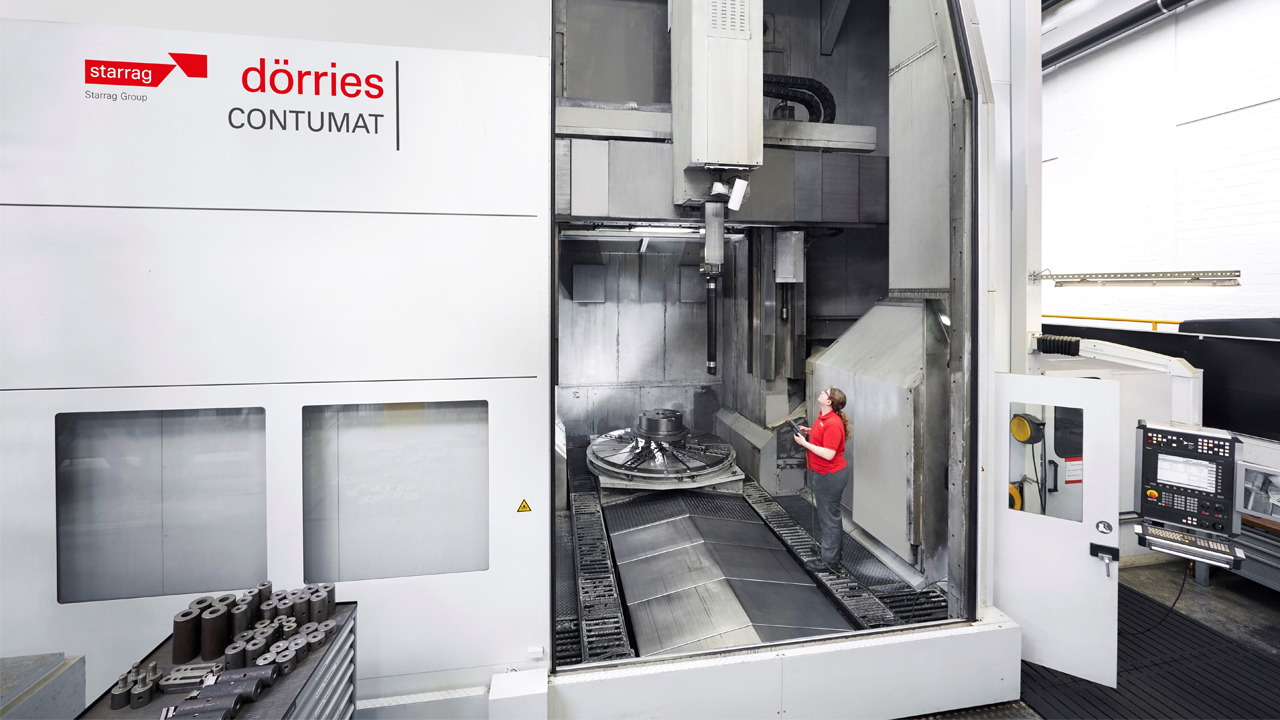

Manufacturing piston compressors that operate up to 3,600 bar, Burckhardt Compression uses a quartet of Starrag machines – a Scharmann Alpha 1250 M machining centre, a Scharmann Heavyspeed 2 ram-type boring mill, a Dörries Contumat VC 2400/200 vertical turning lathe (VTL) and a Scharmann Ecoforce 2 HT4 machining centre – to machine cylinders, cylinder blocks, frames, valve heads and steering rods.
Producing components up to 5.9 m long and weighing 30 tonnes, the production routines are demanding, including finish machining to 20 microns and H7 holes up to 1.3 m deep. However, the Starrag machines consistently meet all requirements while also generating time and production savings compared to former methods.
According to August Dünki, the company’s Director of Large Part Manufacturing: “We especially gain extra benefits from the use of the Dörries VTL’s additional moveable work table axis (for set-up and/or in-situ workpiece inspection) and reduced unproductive time via the 72.4 hp Ecoforce 2 HT 4 which utilises head attachments (with automatic pick-up) and robot tool handling.”
Importantly, too, the company highlights Starrag’s machine pre-approval software package as particularly beneficial. This details workpiece processing including all machining parameters, tools and targeted processing times and, says Mr Dünki: “This software is an important part of machine selection.”

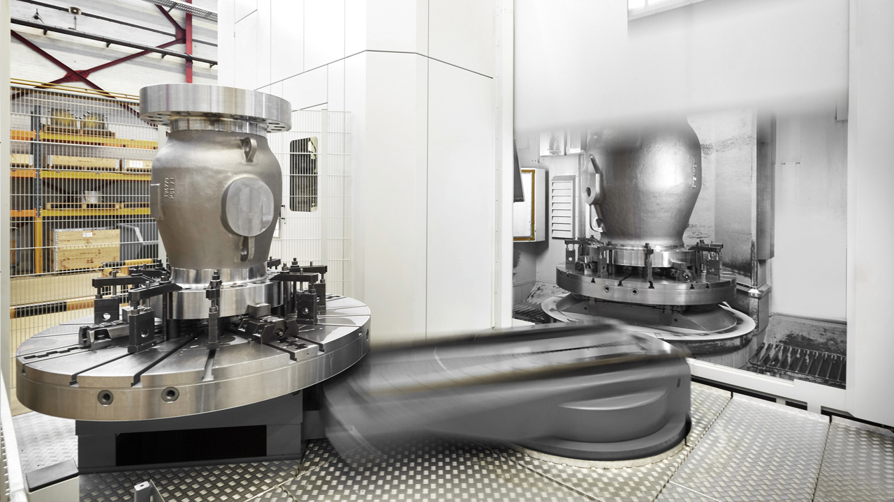

In another example, Mokveld in the Netherlands is using a 80.5 hp Dörries Contumat VCE 2000 vertical turning lathe (VTL) to machine high-pressure axial flow control and stop valves measuring up to 2.4 m long by 1.9 m diameter and weighing up to 12 tonnes. These are produced from materials such as cast and chrome steels, duplex, super duplex Inconel and titanium, and 80 per cent of machining – to finishes of 30 microns – is focused on turning.
Again, the use of a ‘second’ work table is providing rewards, enabling a workpiece to be set-up while another is being machined, for example. Additionally, because boring can also be undertaken on the VTL, Mokveld is reducing formerly very long machining times as well as possible re-location errors and certainly costs by machining the components complete in a single set-up.

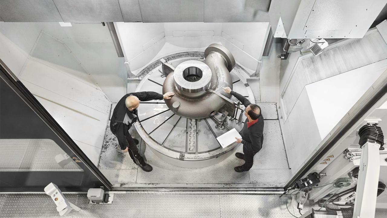

The rewards of using a Dörries Contumat VTL – in this case a VCE 2800/220 MC model – are also being gained by KSB, based near Nuremberg, which is machining machine pump housings weighing up to 3 tonnes to exacting IT6 tolerance standards. Replacing a process that involved turning the housings’ front and rear sides, then re-locating on a different machine for drilling, now the Contumat performs all required tasks in a single clamping.
So, not only has the machine reduced throughput times but it has also replaced two/three conventional machines, thus allowing KSB to gain further financial capital investment rewards and improve operator utilisation.
