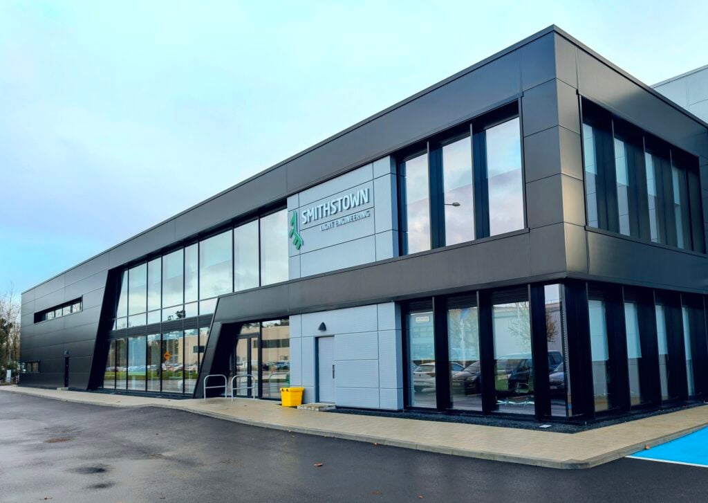

Nestled in Shannon, Ireland, Smithstown Light Engineering has experienced a remarkable transformation over the past 50 years. Founded in 1974 as a traditional toolmaking business under the leadership of Brian King, it has grown into a global medical device powerhouse with over 300 employees. Today, with three sites across Ireland and Poland, the company produces millions of precision components each year, with the Starrag Bumotec 191neo taking its place as the cornerstone of its New Product Introduction (NPI) strategy.
“Brian King was a champion toolmaker in Ireland, winning awards and building a reputation for precision & quality” explains Gerard Henn, CEO of Smithstown Light Engineering. “That customer-focused philosophy, where you could call him at 10pm with a problem, and he’d be there the next day – that’s the foundation we’ve based everything on.”
When Gerard’s son Brian became Managing Director in 2011, he recognised the cyclical nature of tool making was challenging especially after the 2008 recession. Already involved in clamps, fixtures, and instrumentation for surgical procedures that provided a repeat business model, a change of direction was being surgically strategised. “In 2018, we were still making mould tools, but the decision was clear. We exited mould tools to focus on medical device manufacturing.”

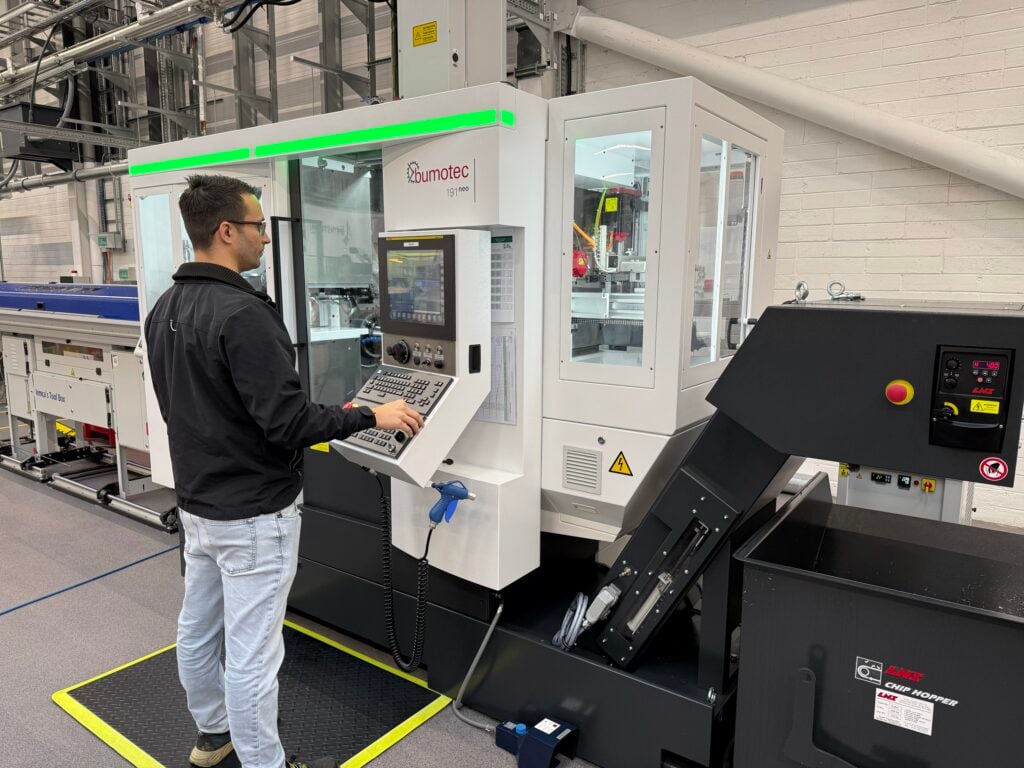

The first component tested on the Bumotec 191neo was a medical device for a global manufacturer. “We’d made similar pieces on a sliding head turning centre, but this new part was far more complex. On turning centres, we would’ve had multiple setups. Now it’s bar stock in, and the finished part out – that has to be the case with complex, tight-tolerance components. We can’t afford to do second operations on machining centres, as we have in the past.”
The geometry of these parts pushes boundaries. “We’re talking about profile tolerances of 3 to 5 microns on what will eventually be production parts. On other machines, we wouldn’t be able to hold that. We can hold those tolerances with the Bumotec, even when doing complex production machining,” Flavio notes.
The medical component has undergone nine design iterations. “There’s been eight design changes in six months. We’ve been producing batches of 5,000-off through each of these iterations. We needed a machine capable of handling that variability from the start — and now we have it. When it enters full production, we could be talking 10 to 20 million parts, but in the medical sector, this commercial work might be a few years away. When that time comes, we must have our processes 100% nailed-on to maintain the extremely tight tolerances required for volume production. The Bumotec provides us with that process stability and precision that most machines cannot match, while offering the flexibility to complete complex parts in a single process,” says Henn.
Outstanding Performance
The Smithstown team has experience in using some of the most prestigious machine tool brands in the market, but Bumotec has genuinely impressed. “The consistency is what stands out. Holding tight micron tolerances with all the kinematics running is an area where other machines start to lose consistency, not on the Bumotec 191neo.”
This capability has changed Smithstown’s approach. “Some tapers have such tight profile tolerances, we question whether this should be a milling or grinding operation, but the Bumotec handles it all in its stride,” says Flavio.
The machine runs two shifts, with 24-hour capability when needed. Current cycle times are around 15 minutes per part. “We’re confident we could work at least 20% faster and maybe cut cycle times by upwards of 30% when we’re more experienced with the machine and strategies,” says Flavio.
