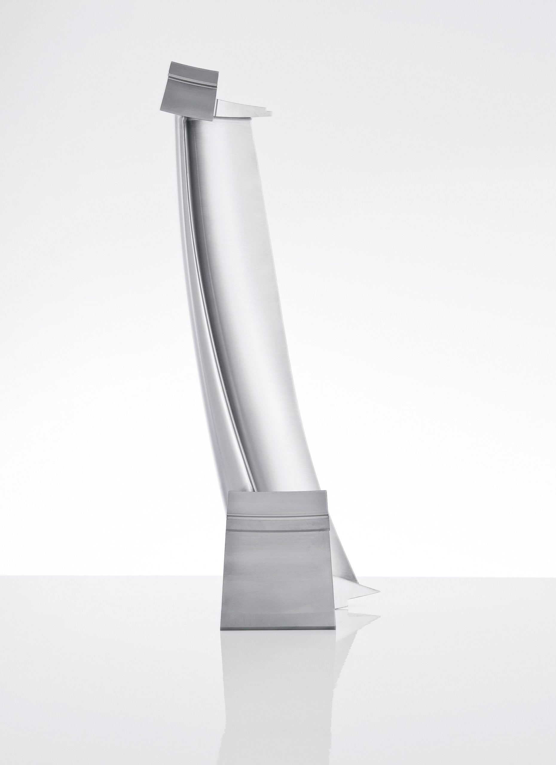

Working closely together, Starrag’s applications department and Pietro Rosa TBM’s engineers – led by Mr Maurizio – have recently developed a process involving the appropriate programs, special fixturing and clever tooling (ceramic for roughing operations and solid carbide for finishing) to produce multi-bladed airfoil components. Each of the super alloy multi-bladed compressor components is machined into the required shape, with very tight tolerances throughout – including within 50 microns on the profile.
The process sees each multi-bladed component successfully completed in-cycle, then passed to a co-ordinate measuring machine for inspection. Ten sections on each blade are measured, equating to thousands of features on each component section.
“We originally discussed machining the airfoils from forgings,” says Mr Maurizio, “but rising order volumes negated this approach – due to the relatively long lead times involved in forgings – in favour of machining from bar. However, a number of production issues had to be overcome before the process was guaranteed as repeatable, not least the avoidance of distortion especially between the roughing and finishing operations.”
