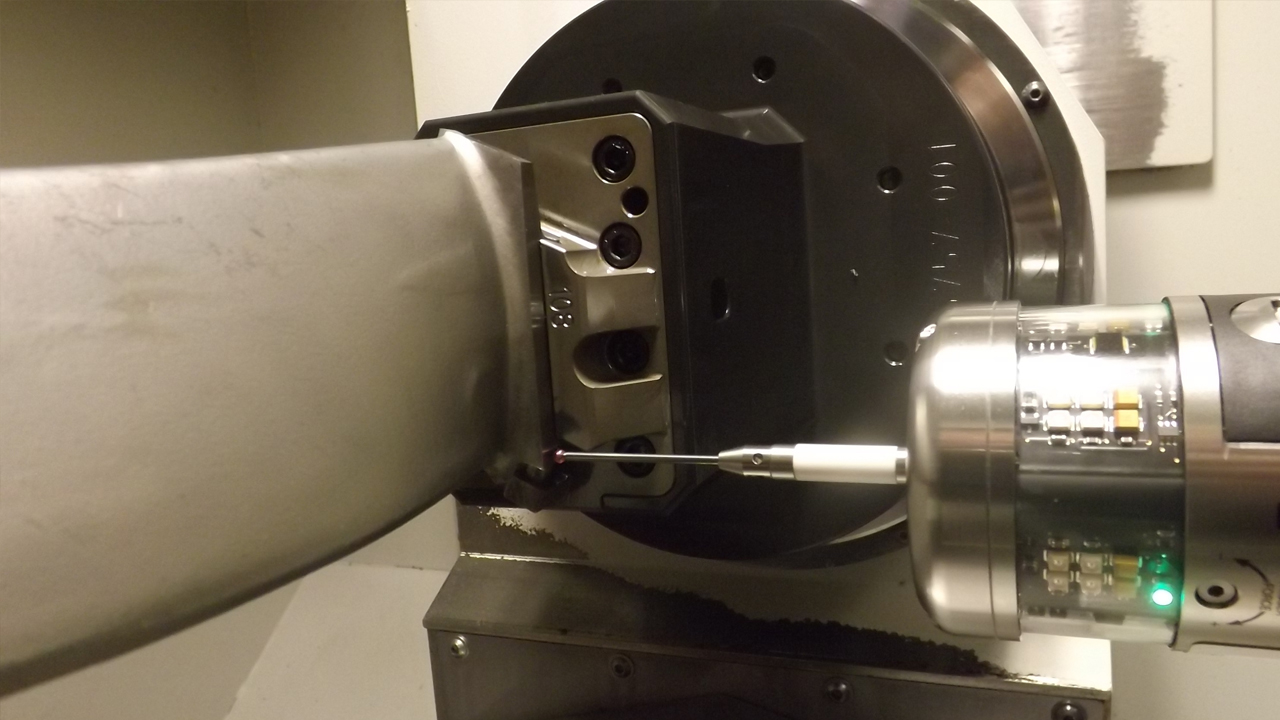

Now, however, blade machining continues to be refined, as Mr McAleese explains: “A blade is conventionally held by clamping on the machine’s tailstock/driven head and, rather than machining commencing on the assumption that the blade is positioned and held accurately every time – which isn’t always the case – we’re now probing the root (using a probe held in the machine’s tool magazine) to accurately locate its position.
“Using Starrag’s RCS CAM software, the machining program then automatically adjusts to the blade’s true position within the machine and determines the ‘best fit’ position of the blade in relation to the root. This means we can eliminate the need to measure the blade (by co-ordinate measuring machine) after machining and, if necessary, adjust and re-write programs then undergo a period of post-programming before we can re-start machining.
“The potential time savings are extraordinary if we can ensure this probing regime is consistently faultless.”

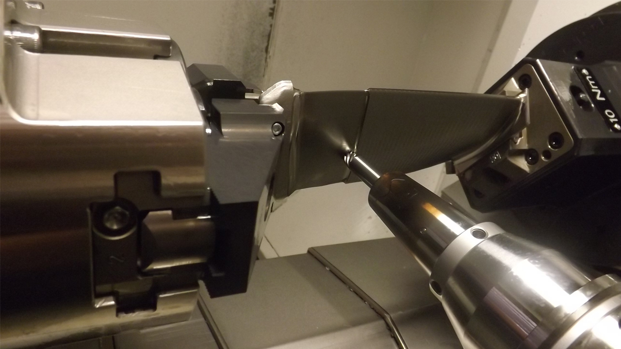

Used by JJ Churchill in conjunction with Unigraphics CAD, RCS enables programmers to, for example, create difficult features such as variable fillet radii – and JJ Churchill has also developed an in-process ‘polishing’ routine for the Starrag machines where blades are rough milled to within 2-3 mm of final form before finish machining then the Starrags’ ‘super finish mode’ sees blades finished to typically 0.7/0.8 Ra and even 0.4 Ra has been achieved.
RCS’s capability for adaptive milling is also being put to work by JJ Churchill on creating perfect blends on aerofoils, on both bar and forged blades – a technique where Haimer heat shrink tooling and 2 mm diameter ball nose cutters also play key roles. “Better surface finish is the result of improving and decreasing the cutter step-over,” says Mr McAleese, “as well as creating far less stress on the material and improved process capability as well as extended tool life.”
