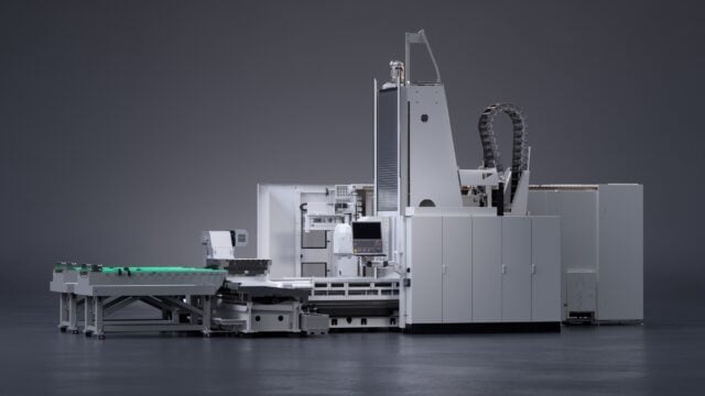

Amongst the 4-axis centres, the Starrag machines always came out on top. What speaks in their favour are the positive experiences users have had over many years, their stable machine design and the consistently high quality has been appreciated by AMMANN Components for a long time. It was only recently that one of the first Heckert machines, a CWK630, was replaced after 23 years of continuous use in shift operation. “The investment paid off,” smiles the Sales Manager, who is also a member of the Executive Board. He expects a similar outcome from the replacement investment in the new Heckert H75 compact machining centre, which was commissioned in May 2023.
The successor model to the successful Heckert HEC 500 comes with various improvements and promising options. The machine is used to machine large aluminium gearbox housings for which the customer specifies centre distances with a tight tolerance. Aluminium in particular reacts sensitively to temperature differences and every degree means an expansion of 0.02mm for this gearbox housing.
Paul Ammann is also enthusiastic about the spindle with its maximum torque of 950Nm and a speed of up to 12,500rpm. This makes the BAZ equally suitable for aluminium and heavy machining. To maximise flexibility and keep set-up times to a minimum, the Heckert H75 was equipped with large tool storage. With its four coupled towers, the tower magazine has a capacity for almost 400 tools.
As AMMANN Components plans long term with all its investments, the move has already had an impact on the Heckert H75, as Paul Ammann explains: “At the moment, automation is neither necessary nor possible. At the new location, however, we will expand the Heckert H75 and the Heckert HEC 500 with a pallet system to create a low-manpower production system. It was therefore important to us that the H75 is fully compatible with the Heckert HEC 500 so that a second set-up station is not needed. As we expected, our partner Starrag was extremely flexible and made the necessary adjustments to the Y-travel as well as the pallet changer.”
