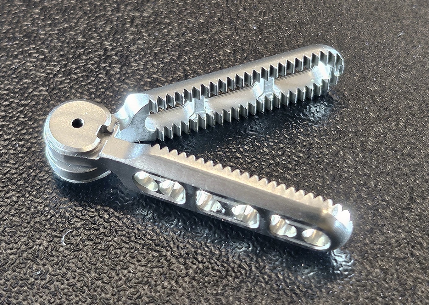

“We needed to machine materials from 46 to 52HRc such as 17-4 and 420 stainless steel as well as titanium. The instrument parts for use in invasive robotic surgery include tools like grippers, cutting instruments and scissors. We are producing the parts in medium to high volume runs across two different parts in various quantities per month.”
Some of the parts had very long cycle times on the 5-axis machines and this needed to be reduced to below 30 minutes with 48HRc material. Not only was the cycle time a challenge, but Dawnlough had to attain precision levels in a production environment with the flexibility to produce upwards of 30 different components. Initially machining 20 to 50 parts a month, the schedule was set to rise rapidly to 200 parts per month before reaching production volumes – numbers not possible on a 5-axis machining centre.

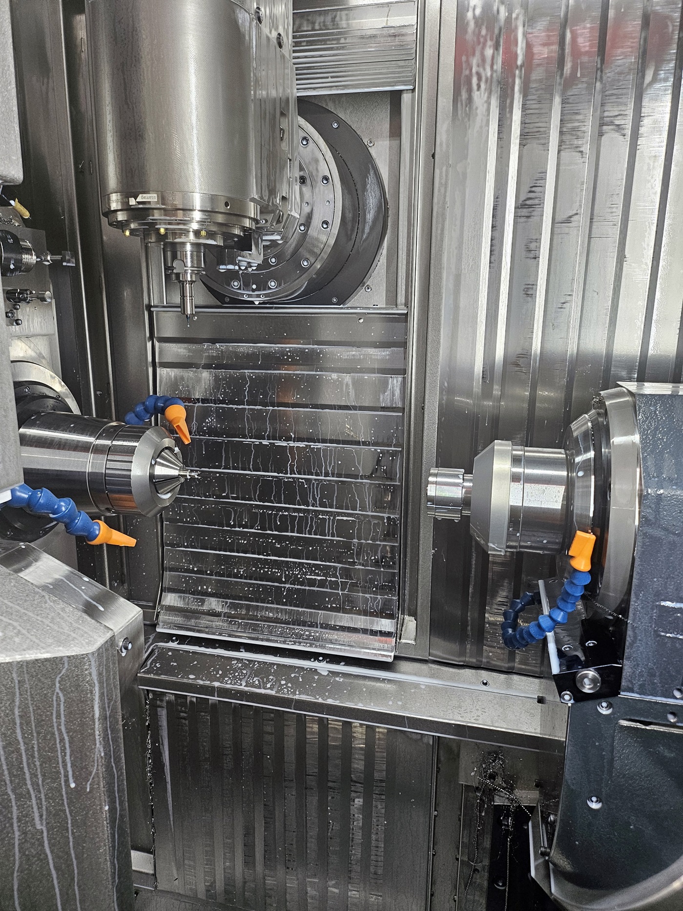

“The sub-spindle option we had on the FTL-R wasn’t feasible for the parts we needed, whereas the FTL-PRM gave us two vices. Without the vices, we would have needed to undertake secondary machining, so to be able to pick up the component in the vice and conduct the second operation in a single cycle was key to finishing the parts.”
