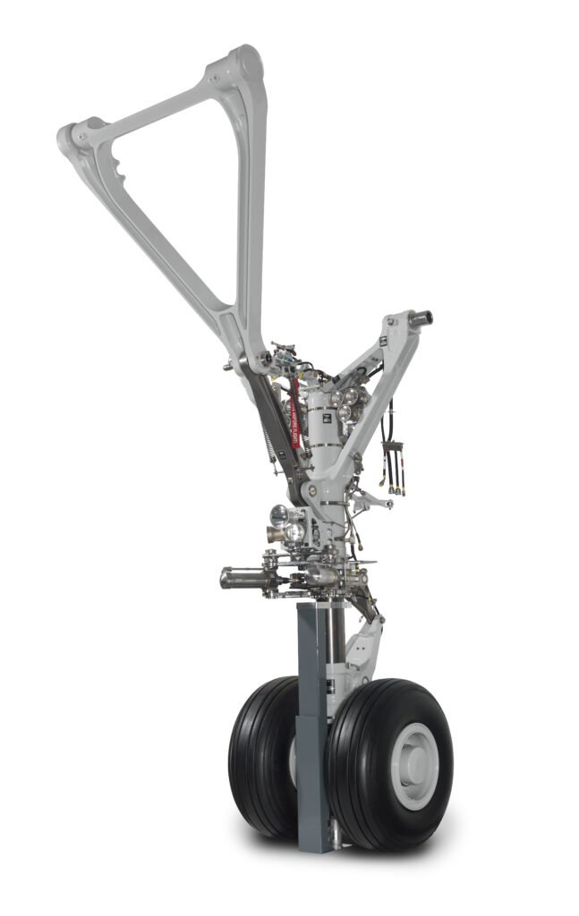

Smooth, precise and with perfect timing: Modern landing gear works just like an eagle about to land. For the first time, Starrag presented a fully assembled nose landing gear of the Airbus A350 at the recent EMO 2025 show: A symbol of a close partnership with Liebherr-Aerospace that has lasted over 20 years.

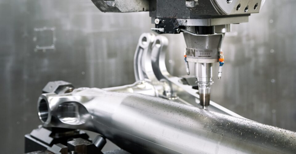

It all began in 2004 in Lindenberg, Bavaria, with a single Droop+Rein FOGS machine. It has developed into one of the most productive partnerships in the field of landing gear production. Starrag exhibited a fully assembled nose landing gear for the Airbus A350 – manufactured by Liebherr-Aerospace Lindenberg GmbH and machined on a Droop+Rein machining centre from Bielefeld.

Liebherr-Aerospace operates one of the most modern landing gear production sites in Europe at its Lindenberg site. Four Droop+Rein FOGS machining centres are combined. This is supplemented by robot-supported tool systems, laser measurement and integrated automation. The decision to purchase the first Droop+Rein FOGS machine was made back in 2004 because its concept – originally developed for tool and mould making – was ideally suited to the complex outer contours and tolerance requirements of landing gear parts.
The philosophy: As many work steps as possible in one clamping operation.
Nose landing gear
The nose landing gear is smaller than the main landing gear but plays a key role. It enables directional changes when taxiing, absorbs high impact forces when touching down and functions under all climatic conditions. The system was redesigned for the A350-1000 long version with a take-off weight of 308 tons. Liebherr was able to draw on its decades of experience to do so.
These kinds of sophisticated systems are no longer solely produced in-house, but in a global production network. In addition to the four Droop+Rein machines in Lindenberg, nine more machines were installed in Europe and Asia. This was made possible by the close technological cooperation with Starrag. The Bielefeld-produced machines not only provide the necessary precision, but also the basis for a globally standardised production approach – tailored to the requirements of safety-critical components and their high repeatability accuracy.
