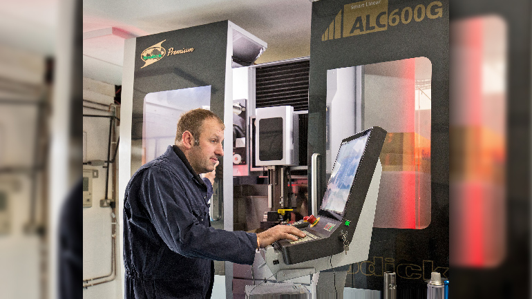

Foremost Specialist Products, a Derby-based subcontract manufacturer of precision engineered components, has invested in a new Sodick ALC600G CNC wire-erosion machine from Sodi-Tech EDM. Acquired to help the company take on the “complex and awkward parts that no else wants to tackle”, among the jobs being successfully accommodated by the machine are stainless steel tubular stem guides for power generator turbines.

“We won a contract for an awkward, tricky part and our existing EDM couldn’t offer four-axis cutting and didn’t have enough memory to take on the job anyway,” explains the company’s Engineering Director Joe Walker. “We were tasked with producing a number of cross-holes in stainless steel stem guides for turbines used in power generators. The holes are angled in two planes are must be held to extremely tight tolerances.”
Although Foremost had never owned a Sodick EDM before, when Mr Walker scrutinised the marketplace for a suitable machine capable of processing the stem guides and other complex parts, he was drawn to Sodi-Tech EDM.
“I really liked the feel of the Sodick ALC600G – such were its capabilities that it felt as if we would be moving from a small hatchback to a supercar,” he says. “I was also attracted to the excellent technical support on offer from Sodi-Tech EDM, which is vital for a company such as Foremost where complex parts are our core business.”
Installed in March 2017, the ALC600G wire EDM machine is a recent addition to the Sodick line-up. As well as linear motor drives and absolute linear scales, the machine includes features such as next-generation SPW (Smart Pulse Wire) control with Smart Pulse Generator, digital Pika-W Plus super finishing circuit, advanced step machining, high-speed AWT (automatic wire threading), advanced corner control, on-board Heart NC CADCAM system and intelligent Q³vic EDW automatic programming system.
“We are finding the machine offers so many benefits – it is making particularly easy work of the stem guides,” says Mr Walker. “Some of the guides have six or eight holes, typically measuring from 1.3 to 3.0mm in diameter, but one of the latest has 28. The Sodick ALC600G gives us peace of mind that the work will be completed efficiently and accurately, every time.”
Sodick’s linear motor drives in the X, Y, U and V axes have no backlash and are backed by the company’s 10-year positioning accuracy guarantee. This precision is another factor proving advantageous at Foremost.
“We have noticed a real difference in the tolerances we can now hold reliably, as well as vastly improved surface finish,” says Mr Walker. “Moreover, I would say the new machine is up to 50% quicker on many jobs than the machine it has replaced. We actually have one other EDM machine on site, but due to the new Sodick, this is virtually redundant and we are thinking of selling it. So in effect, the ALC600G has replaced the work of two machines.”
The new Sodick also offers a generous 350mm of travel in Z-axis, which Foremost says has helped the company take on thick work that it previously would have to turn down.
“Today, wire erosion has become an integral part of our business, particularly since the arrival of the Sodick ALC600G, which has taken us to a whole new level of competence,” concludes Mr Walker.
