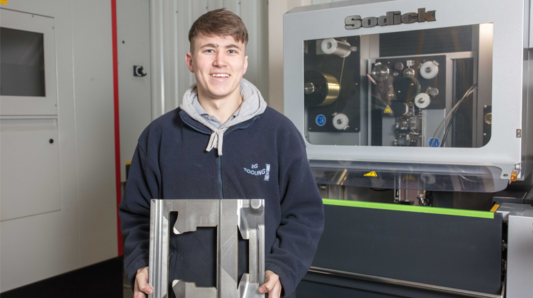

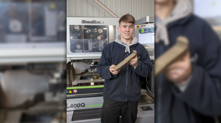

The learning curve for the new Sodick machine proved extremely short, with just half a day training for Mr Peters and three days for one of the company’s apprentices; both programmes were delivered by Sodi-Tech EDM. The apprentice now runs the machine.
Press tool punches and dies manufactured on the Sodick VL400Q are used to produce automotive body-in-white (BIW) panels for “all the major OEMs”. Made from hardened tool steel, accuracy between the top and bottom (clearance) is normally in the region of 0.05mm, which Mr Peters says is “achieved without problem” using the Sodick machine.
“Furthermore, the surface finish capability is second to none, while the really tight corners produced by the machine are perfect for complex punch and die manufacture,” he states. “Using less capable or older technology would require hand-fitting or diamond filing to achieve the required corner profile, but not with the Sodick VL400Q.”
