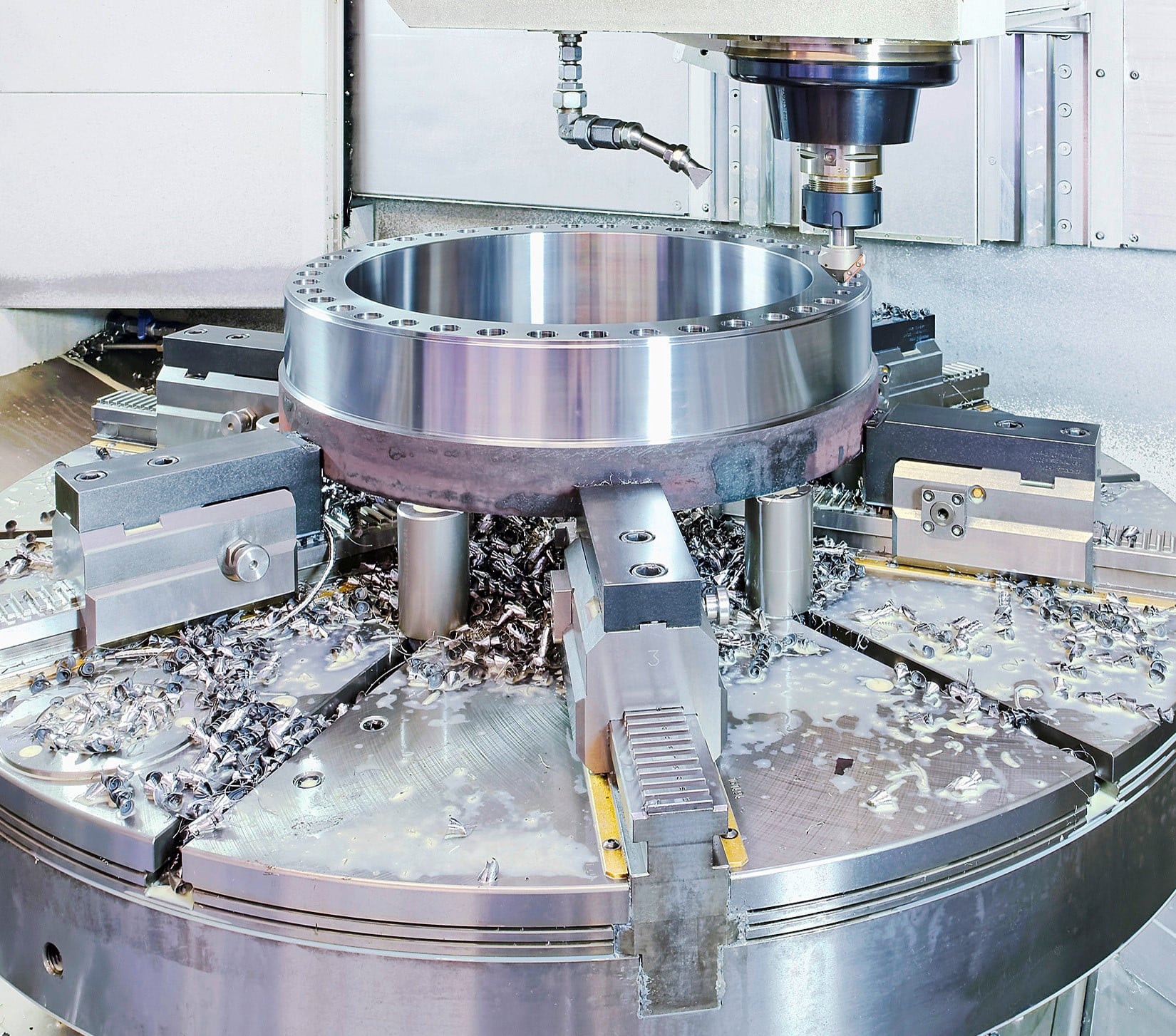

The 6-jaw pendulum compensation chuck SCHUNK ROTA NCR consists of a central chuck piston carrying three inner pendulums aligned at 120°. Each pendulum is connected to two base jaws. This ensures workpiece centering between six contact points, adjusted in pairs. As the clamping forces are directed towards the chuck center, optimum centering is achieved without distortion of the workpiece. The chuck perfectly adjusts to the workpiece with its oscillating jaws. With conventional jaw clamping, this configuration allows for maximum roundness of the workpieces and ensures optimum centering at the same time.

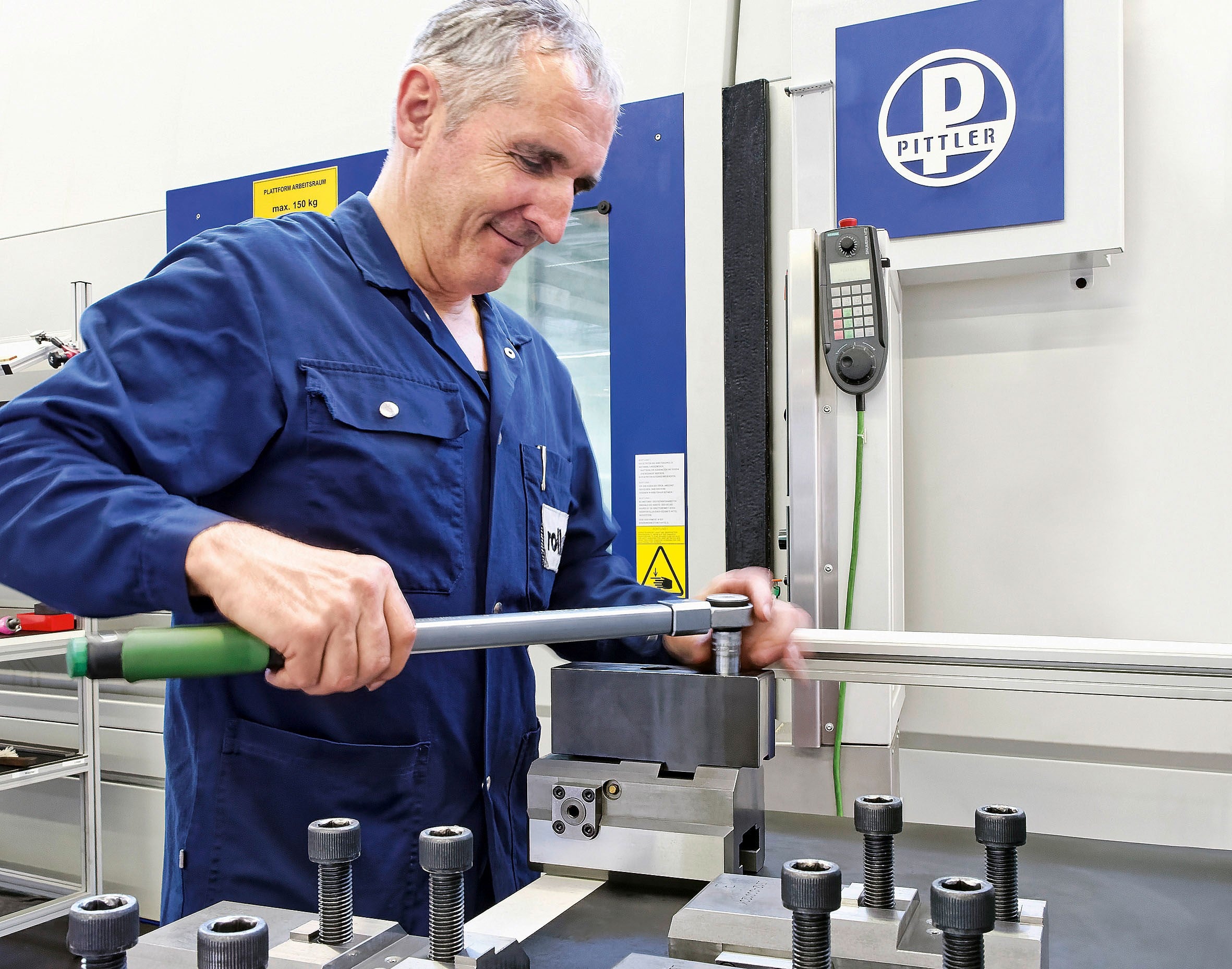

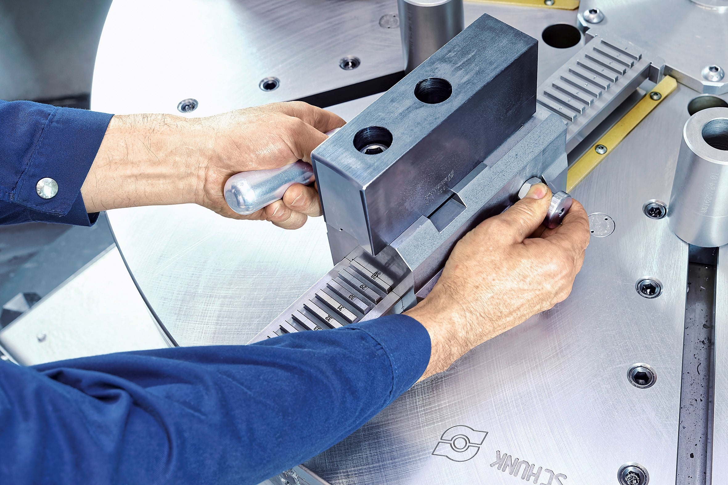

Standard jaws can be used to replace elaborate system jaws and special solutions on the ROTA NCR jaw interface. This saves time, cost-intensive special solutions, and reduces set-up costs. An integrated jaw quick-change system minimizes set-up times on the idle machine. "We use two sets of base jaws and set up the top jaws outside the machine, in other words, while machining is still in progress," explains team leader Daniel Fierz. "The set-up process for the second operation then takes only 20 minutes, including cleaning." To do this, the base jaws are pushed open, then they automatically lock in place, and are secured with a quarter-turn of the torque wrench. Due to the jaw quick adjustment, the base jaw position can be easily adjusted in just a few simple steps. The quick adjustment feature allows me to set the clamping range in defined steps," explains machine operator Willy Ummel. "The system works flawlessly and is easy to clean." In the past, up to two hours of machine downtime had to be calculated for a conventional set-up process of such workpiece sizes. Now it takes Ummel less than thirty minutes. Top jaw sets with hard chuck jaws and claw inserts are available for raw part clamping, and sets of soft top jaws are already bored in the different diameters for machining the part from the other side.

One of the main goals of the investment was for the machine to run as smoothly as possible with only minimum interruptions, says team leader Daniel Fierz. "The lathe chuck is so precise that we can use jaws again and again without re-boring. After exchange of the jaws, we achieve a run-out of 0.02 mm without any additional actions. "The vertical position of the spindle also plays a role here. Maximum freedom of movement and therefore optimum centering are ensured because the components are put onto surface-ground pillars and not on the chuck jaws, as is the case with horizontal spindles. "The vertical machine allows for significantly better oscillation than machines with a horizontal spindle, where the friction between the component and the jaws restricts the pendulum effect," emphasizes Fierz. When finish machining or clamping rough turned surfaces, operator Willy Ummel can clamp the ROTA NCR's pendulum in the center position so that all six jaws are moving concentrically. The use of the lathe chuck has a welcome side effect: the reject rate has fallen by around 75% since the solution was implemented. This is due to the dramatically reduced deformation, the high precision of the jaw change process and the improved flat work surface of workpieces. The reduced reject rate results in considerable savings, especially with high-quality materials such as the ferritic casts frequently used by ROLLSTAR.
