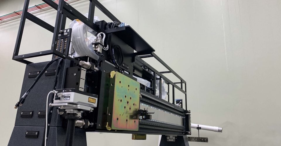

VAD designs and builds customised precision motion platforms and process equipment for use in a vacuum environment. Its motion control products use Renishaw’s TONiC encoder systems with scales specified according to the accuracy requirements.
VAD President Mr Baek-Kyun Song explains: “Our general platform models are equipped with RTLC series steel tape scales. If advanced vacuum applications are involved, such as display panel AOI inspection equipment or semiconductor process equipment, we will specify the higher precision RELM scales. The scale is read by a vacuum-compatible TONiC readhead and is connected to an interface outside the vacuum chamber. There are many high-quality encoder products on the market, but few are also compatible with vacuum applications. Renishaw’s TONiC UHV encoder delivers both excellent performance and reliability, it is our best choice.”
Renishaw’s TONiC UHV encoder, from the cable, to the readhead, to the scale, has been designed for vacuum pressures under 10-9 mbar. The TONiC UHV readhead is equipped with an RFI shielded cable, and its basic working principle, specifications and performance are the same as for the standard TONiC model. The encoder is made from cleanroom and vacuum-compatible materials and is designed to enable full evacuation of the readhead body. TONiC UHV readheads and scales have also been certified by an independent test agency using residual gas analysis (RGA) data collected on a quadrupole mass spectrometer. Specialised sealed foil packaging ensures that each TONiC UHV encoder arrives at the customer in clean room condition.
The TONiC encoder series offers a diverse range of readhead options, which can be matched with a variety of compatible scales. Mr Song explains VAD’s criteria for selecting encoder scales: “Some of our high-end models use high accuracy RELM spar scale, which has near-zero thermal expansion, to ensure that positioning accuracy is maintained in environments with large temperature differences.
For instance, temperatures inside a vacuum chamber can often vary by as much as 100 °C from one side to the other. Renishaw’s encoder products have a good reputation in the marketplace; the TONiC encoder series is often seen in applications with high-performance equipment and has been widely recognized by the industry. In addition, Renishaw’s after-sales service is excellent and includes regular product bulletins. For us, the most important thing is that the delivery is punctual so that we don’t lose customers due to long waits for parts.”
For nanometre-level precision, VAD employs Renishaw’s RLE laser encoder system for the position feedback control of an XY stage designed for semiconductor mask inspection by extreme ultra-violet light. The RLE system uses plane mirrors that are mounted on each linear axis and is suitable for vacuum applications, because the laser head can be mounted outside the vacuum chamber.
Mr Song continues: “Renishaw provides us with cost-effective and high performance position feedback solutions and offers excellent technical support and regular training. The RLE laser encoder delivers nanometre accuracy for our front-end semiconductor process equipment with the additional benefits of easy installation and setup, and short lead times.”
VAD tests and calibrates its products prior to leaving the factory using Renishaw’s XL-80 laser system for machine calibration and quality control. These systems are fast, extremely accurate with linear measurement accuracies of ±0.5 ppm, lightweight and portable.
