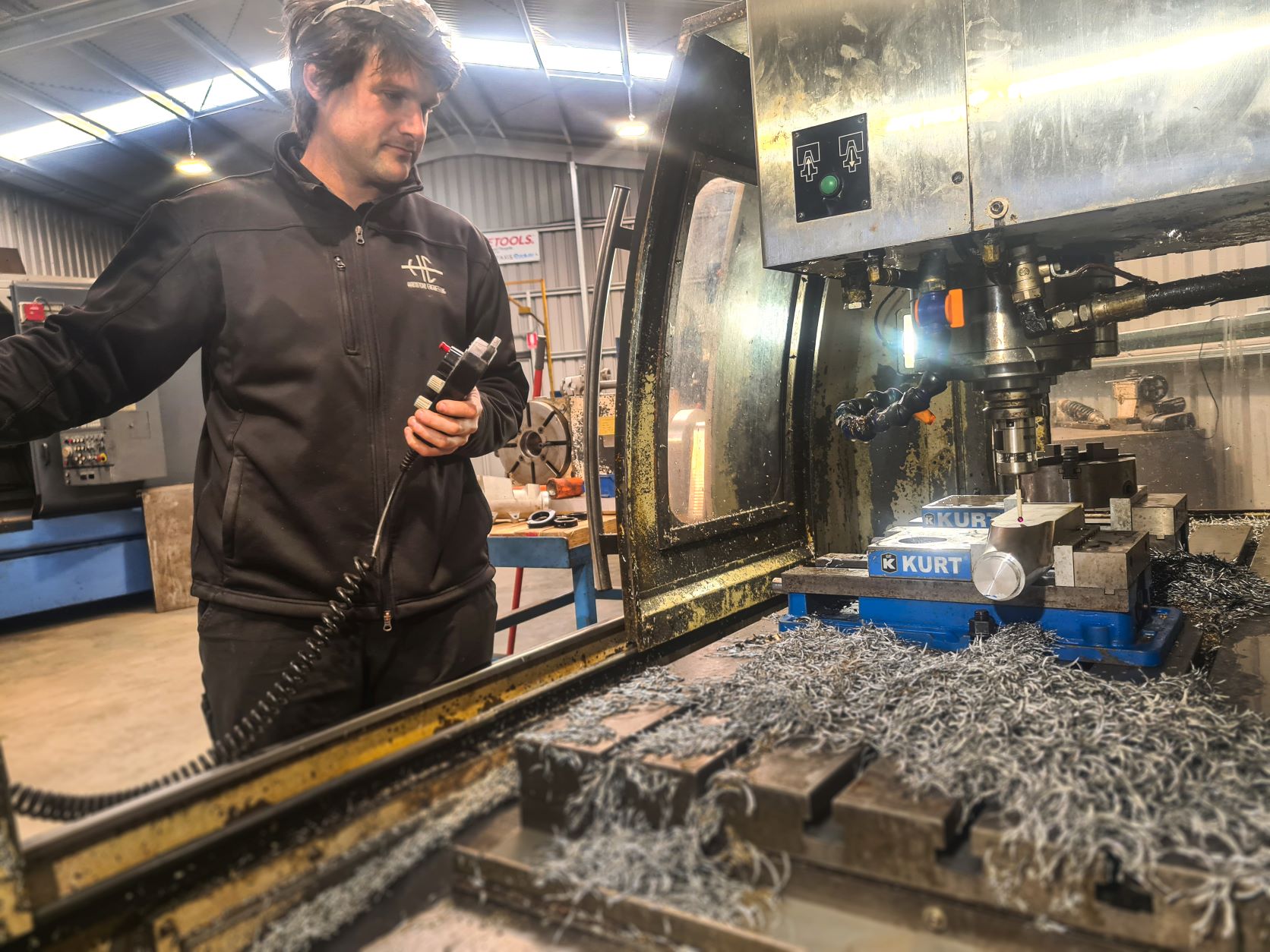

“As we’re a very small business looking to reduce costs, we often buy machines second hand,” continued Hammond. “When we purchased our latest machining centre, it came with a Renishaw probe attached, so we began to use it for part set-up to see if we could improve accuracy and productivity.”
Hammond Engineering’s machining centre was fitted with an OMP40-2 probe. This ultra-compact 3D touch-trigger probe with optical signal transmission is primarily used for workpiece set-up and inspection in machining centres. It offers users up to a 90 per cent reduction in set-up time, as well as a reduction in scrap and fixture costs.
Results
Since using the OMP40-2, Hammond Engineering has experienced faster set-up times. For example, before using the equipment, aligning a vice would typically take around five minutes to complete — with the OMP40-2 this task takes less than a minute. The benefits will add up over time — if the team uses the probe to help align one vice a day, the company will save 17 hours a year. Using the probe also reduces the chances of human error impacting production because it can calculate angles without the need for human intervention.
