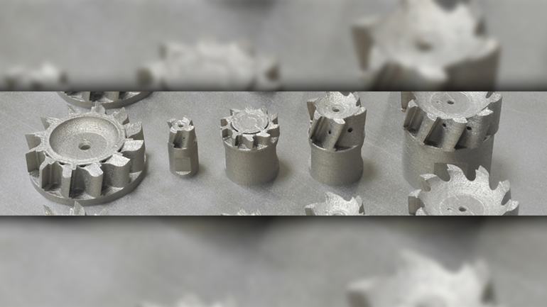

The first of the projects handled jointly between Komet and Renishaw was the development of a new range of PCD (Poly-Crystalline Diamond) screw-in milling cutters. The main bodies of the cutters are manufactured on a Renishaw metal additive manufacturing system, with multiple bodies produced during each cycle of the machine, and then fitted with PCD blades and screwed onto their tool holders. The use of the Renishaw technology to manufacture the tools allows geometries to be produced that would be almost impossible by conventional means. “Thanks to the additive process we have been able to place many more PCD blades on each tool,” explained Dr. Durst.
“We have changed the arrangement of the blades and achieved a substantially greater axis angle. Compared to conventional milled tools, we have greatly shortened the grooves. These changes mean that the tool is a lot more productive for the user.” For example, with a 32 mm screw-in head, the number of grooves and blades has been increased from six to ten, achieving a feed rate that can be up to 50% higher.
In addition, the ability to optimise the paths of the coolant channels ensures that each cutting edge is supplied precisely with coolant through a separate channel, while the external design of the bodies helps to ensure that chips are removed reliably from the face of the tool.
AM also offers the potential to reduce component weight since material can be used only where it is necessary for the optimum functionality in the component. It also outperforms conventional production methods in terms of delivery time for any special or experimental tools needed by Komet's customers.
