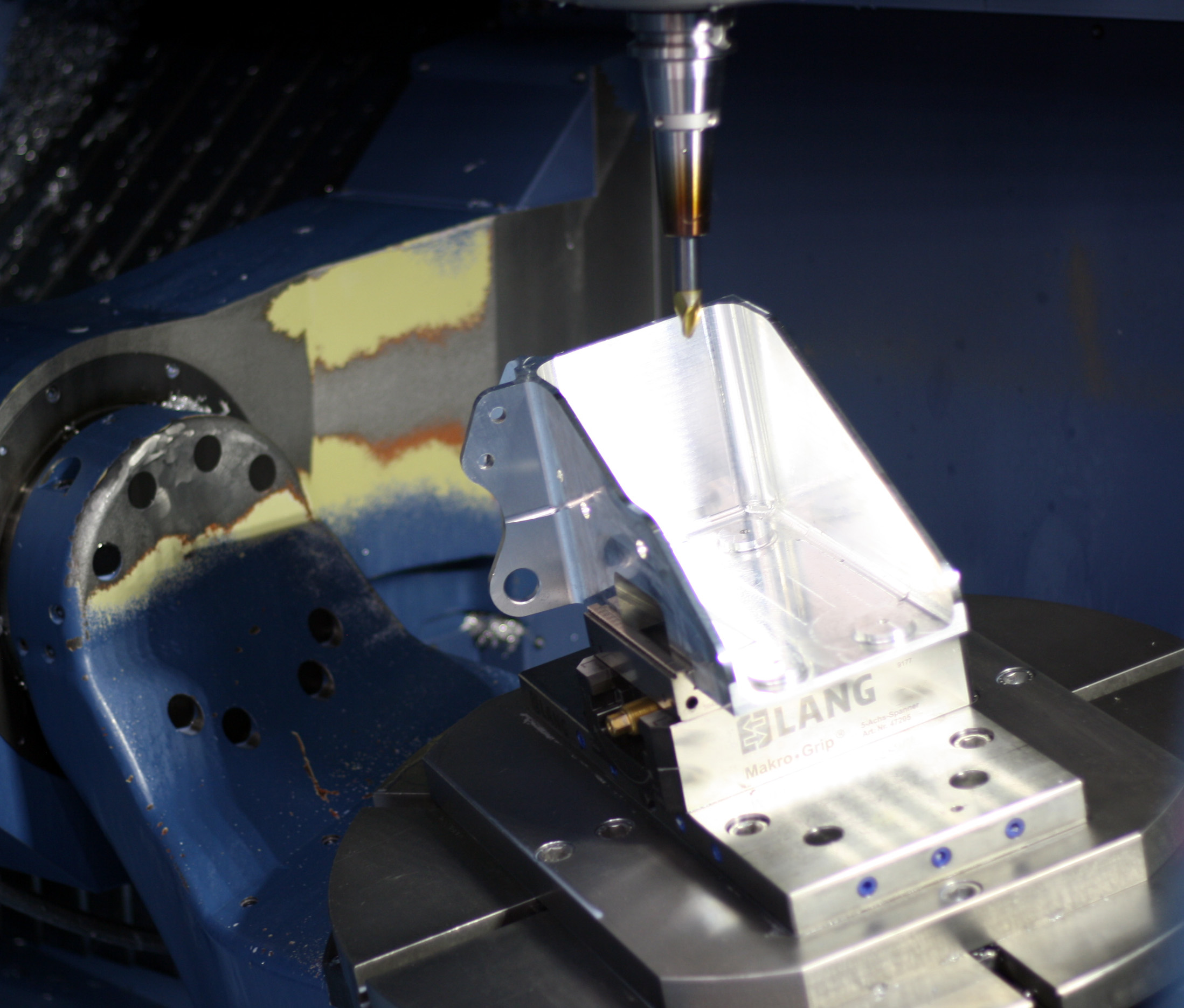

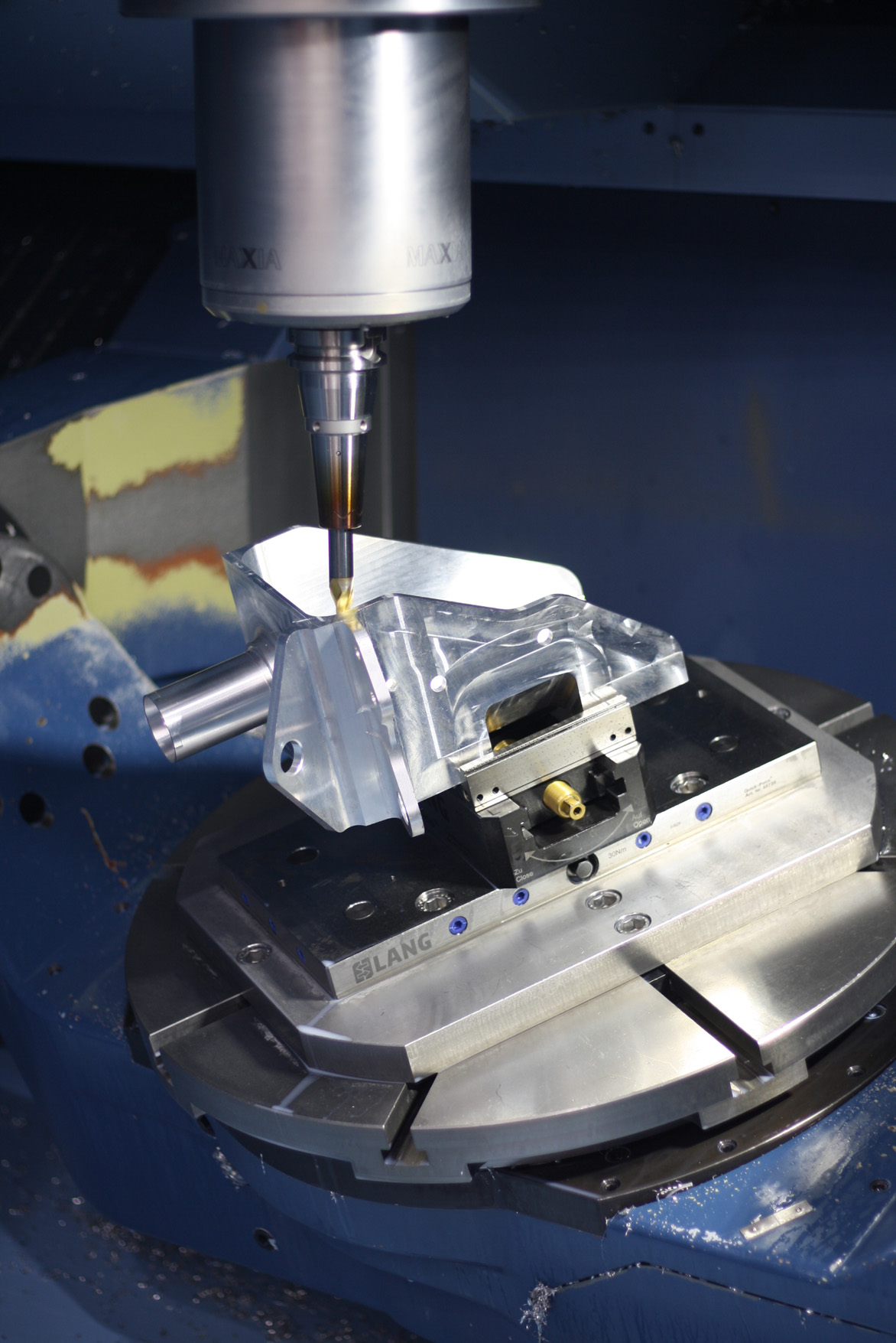

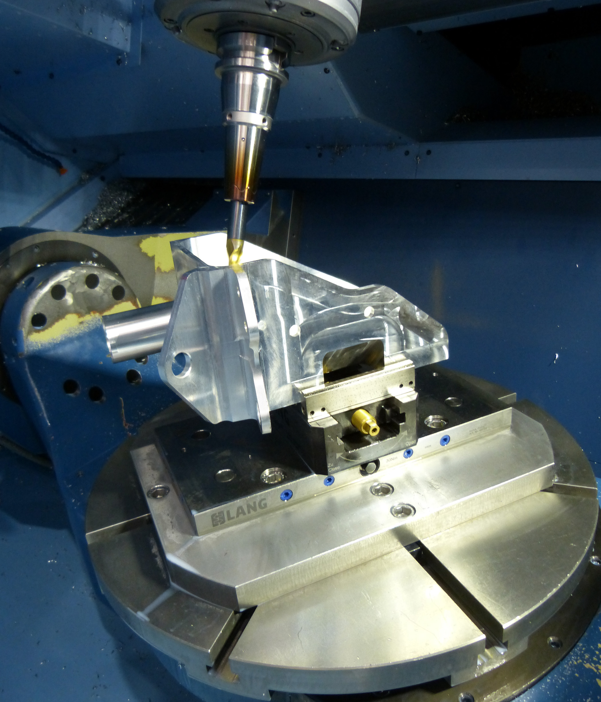

The primary reason Takumi Precision invested in hyperMILL was the potential of barrel tools to significantly improve productivity. Commenting on this, Gerry says: “The hyperMILL MAXX Machining High Performance Package and the respective barrel tools with their innovative geometry allow us to step-down 5 to 10mm as opposed to 0.4 to 0.8mm when finishing pockets, walls or profiling features. This has instantly reduced finishing cycles by at least 70%, giving us a minimum overall cycle time improvement of 30% on every component.”
However, the benefit is not just the cycle time improvement. “We have historically had a number of staff undertaking finish polishing of parts to ensure our surface finishes exceed customer expectations. Despite the increased speed and step-over rate with hyperMILL MAXX High Performance Machining, the surface finishes are much better than before. This is because the barrel tool has a higher engagement rate that keeps the tool in constant contact with the workpiece.”
