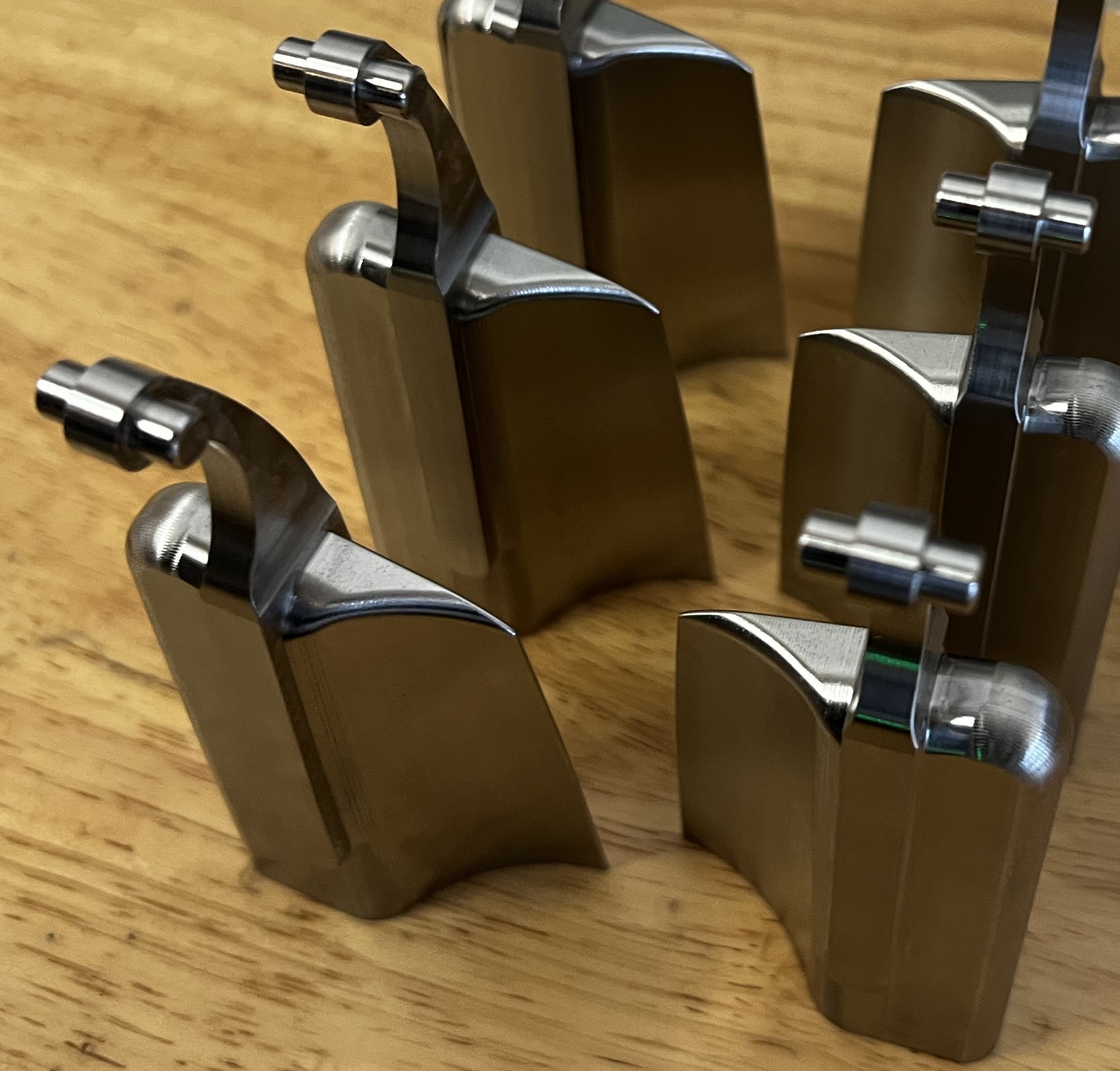

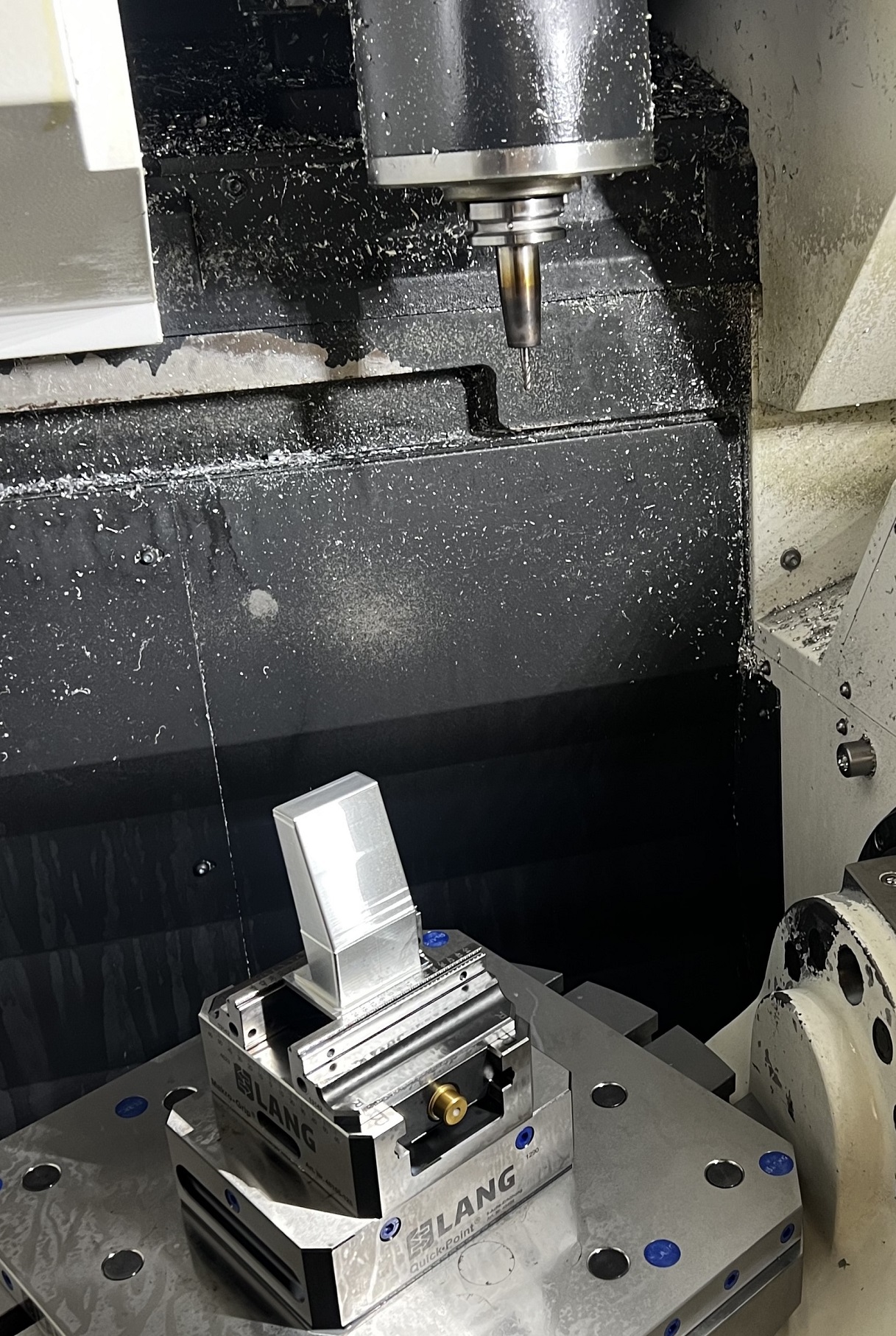

As Jonathan Plumridge says: “The work that we do here is primarily for the motorsport and food processing industries, machining components made of aluminium and titanium in anything from 1-offs to runs of 500+.” To efficiently do this, the company has invested in multi-vices and grid plates from Lang and an Omron cobot.
