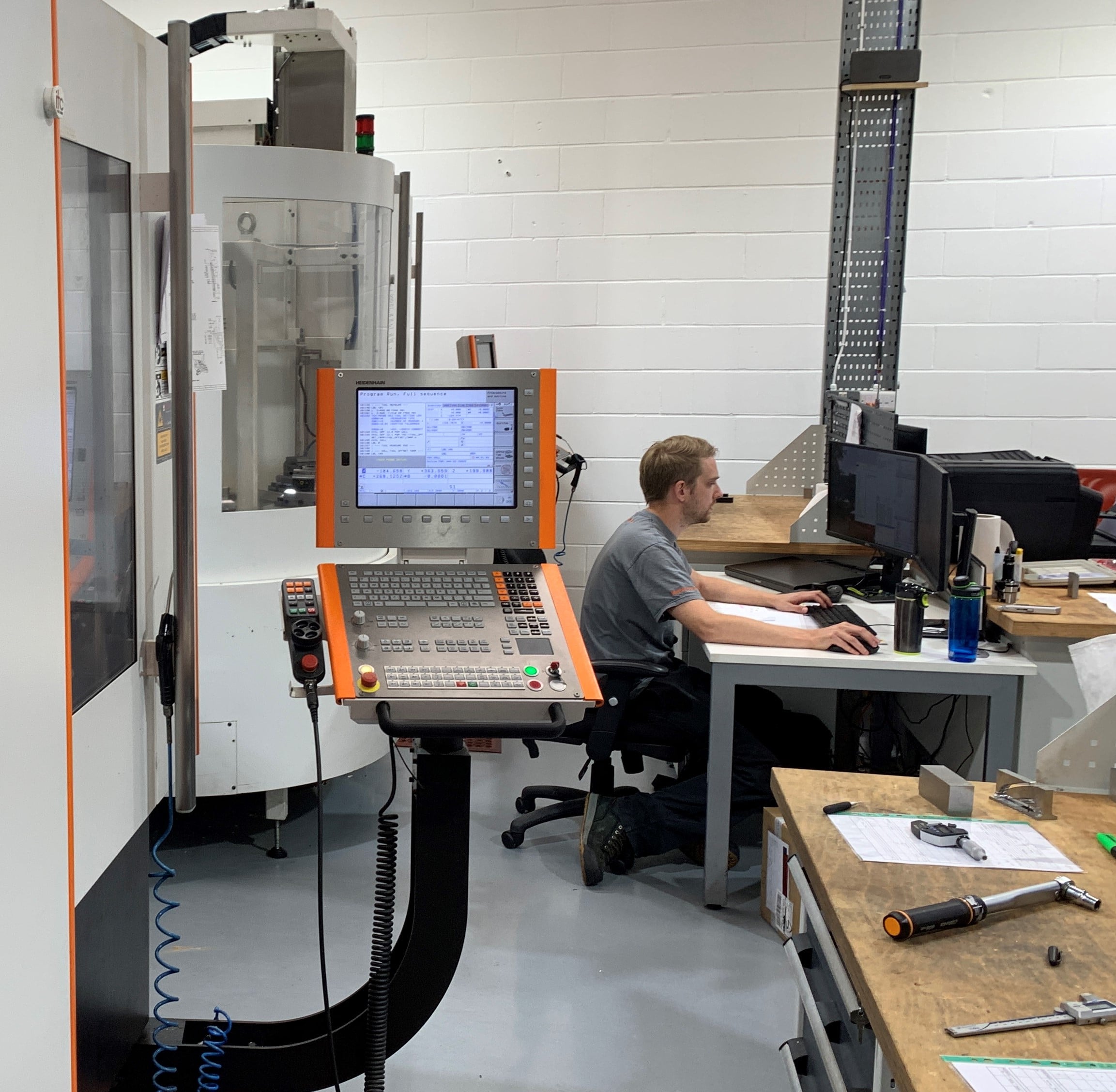

Taking a closer look at why this rapidly growing automotive, motorsport, aerospace, medical and scientific subcontract manufacturing business places such glowing plaudits upon hyperMILL®, Ashley continues: “I was an OPEN MIND user before we decided to start the business. It is a ‘game-changer’ for our business and we now have seven seats of hyperMILL®. We have integrated machine models, and from my extensive use of various CAM systems, it is so simple to train a non-CAM user, we now have our setters and operators using hyperMILL® as a setting and programming tool. It allows staff to check the datum of the part, produce the tooling sheet, put the NC code into the machine and also run the verification software to prevent collisions.”

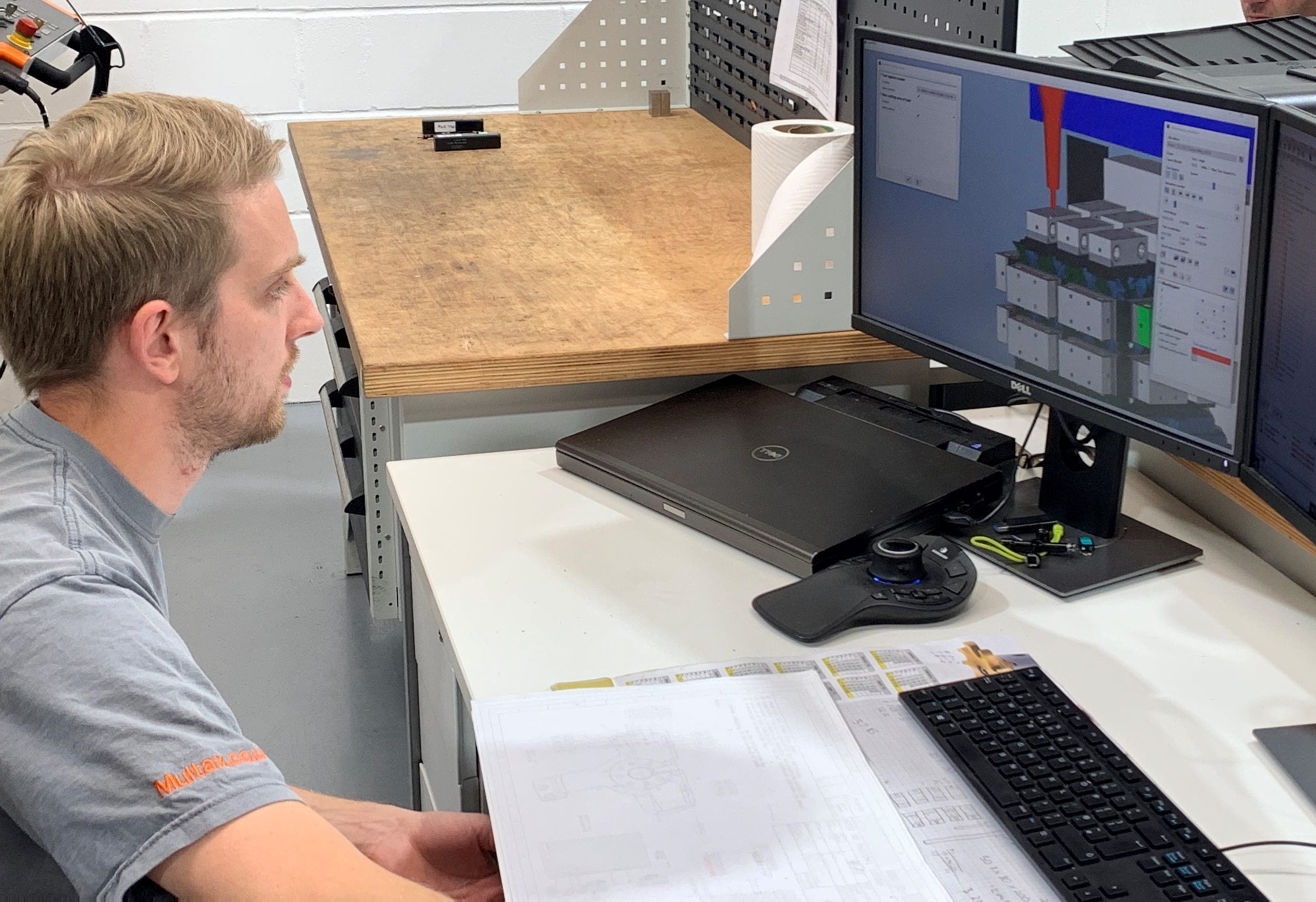

The Hampshire Company is also adopting the groundbreaking Virtual Machine platform from OPEN MIND. Alluding to this, Ashley continues: “From my understanding, hyperMILL® will now replicate the machine control, so it runs the NC programme rather than using POF files. It also provides fully integrated models in the simulation package. We have also invested in the hyperMILL® Optimisation Package. This looks at the tool paths generated by the software and creates optimisations. For example, hyperMILL® has historically moved the cutting tool to a ‘home’ or ‘safe’ position while the machine table is indexing; to optimise that position, the ’Optimiser’ will just move the tool to a clearance height and then bring the tool back to the workpiece, reducing movements and non-cutting times. hyperMILL® has always been able to do this, but previously it was a lot of effort to get there.”

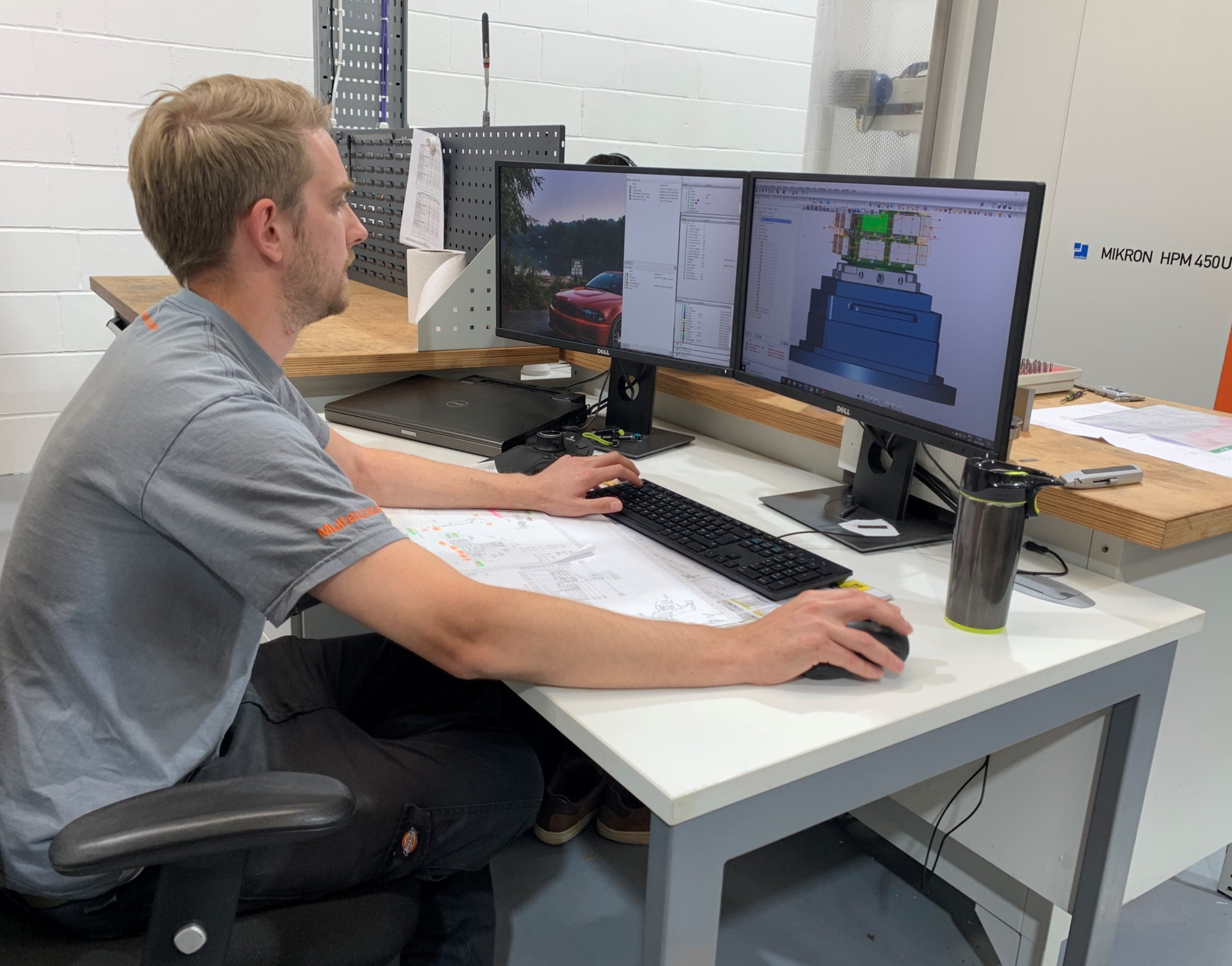

Adding to Ashley’s comments, Multax programmer, Mr Michael Pede says: “Virtual Machine is already bringing additional savings with relation to the time the part is actually on the machine. This is largely credit to the simple fact we can speed things up by linking parts together. We also have the Optimiser strategy that works with ‘Virtual Machine’, basically, this will work on the individual tool paths and then link the individual tool paths together using 5-axis movements, this is all done automatically. It takes the time and effort away from the user and does everything automatically based upon the information you give hyperMILL® regarding each machine. To get the most out of hyperMILL®, you need to know what you are doing, but it is remarkably intuitive.”
Continuing upon the simplicity of hyperMILL®, Michael says: “It’s very simple to use, we have had several people with no experience join the company and we teach them in-house and send them on courses.” Looking specifically at the 5-axis machining cell at Multax, Michael says: “It would be impossible to do what we do without a system like hyperMILL®. We utilise it to the point that we can programme something as soon as we receive the work and then run production and even the first-off part, lights-out with nobody here.”

Looking at how hyperMILL® helps to get the most out of the machine tool technology at Multax, Michael continues: “We get real benefits through the simulations we have whilst the graphical illustrations of the machines allow us to get as close as we absolutely can to the table with the cutting tools.”
