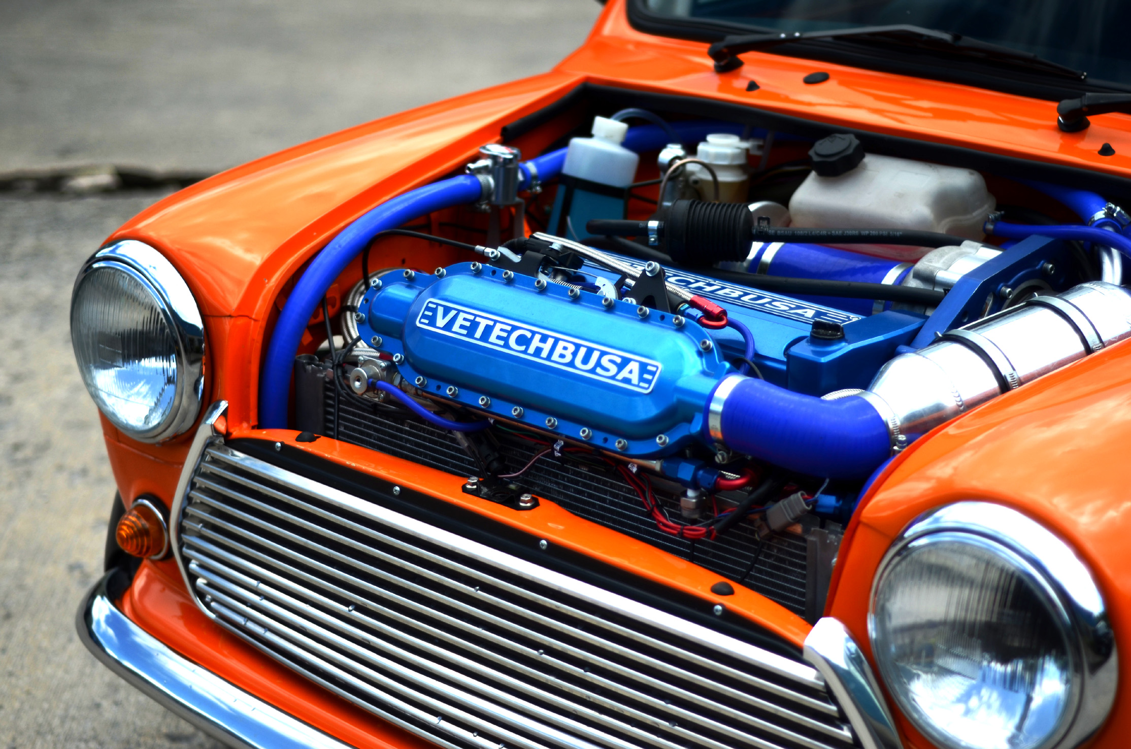

Re-engineering the Suzuki Hayabusa engine is undoubtedly an impressive feat of engineering that has genuine purpose. Once the power unit for the world’s fastest production road bike; the Hayabusa engine is a compact and powerful powertrain unit that can fit straight into the classic Mini whilst offering reliability despite the massive increase in performance. Such reliability is a rarity for any classic car.

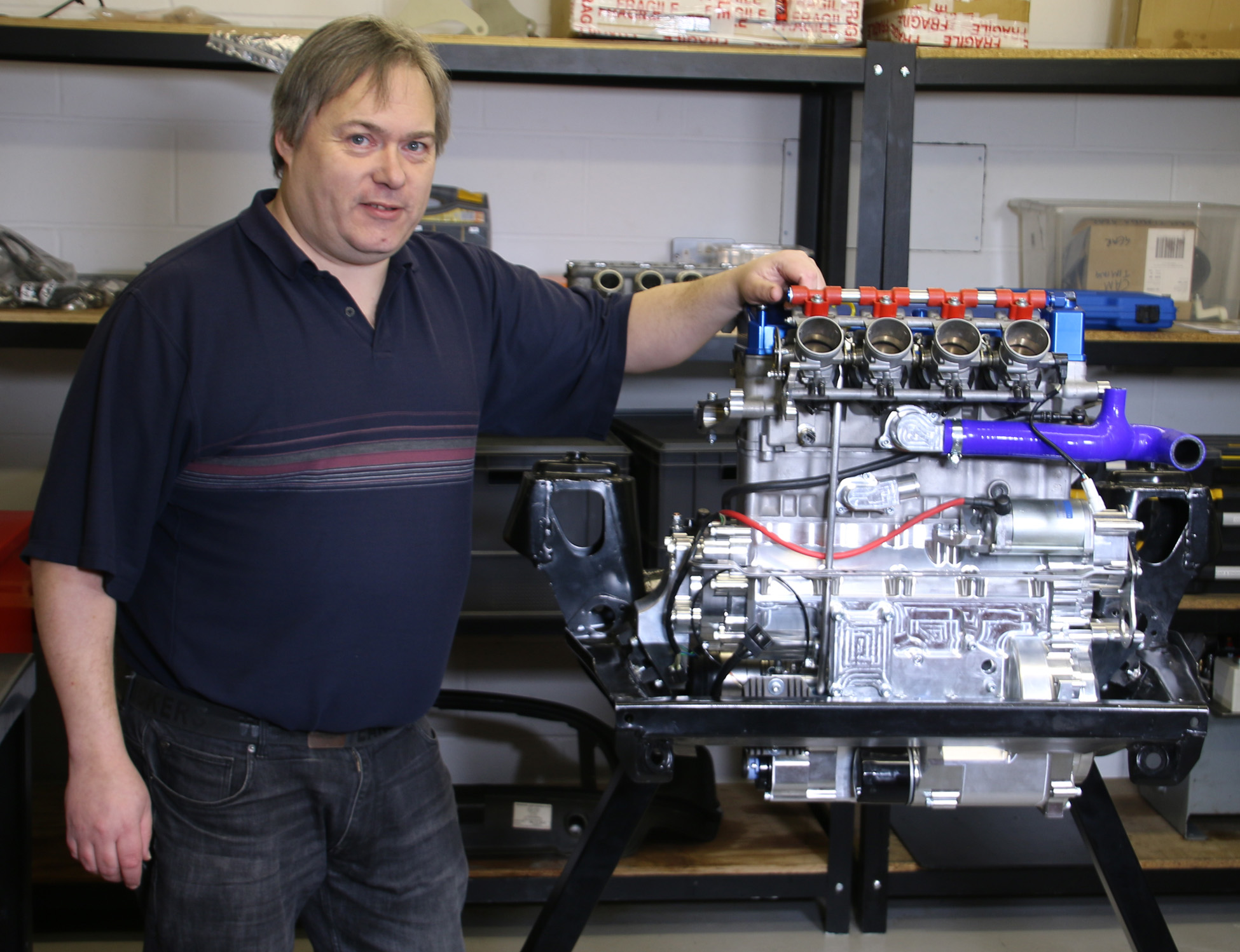

The repackaged engine has seen the Vetech engineers retain many of the power producing components of the original Hayabusa. However, the conversion has seen the Peak District Company add internal final drive gears and a differential, re-position the gearbox beneath the engine and crucially; add a fully integrated reverse gear. The engine has been turned back to front. The repackaged engine/transmission has ‘universal’ engine mounts; bespoke mountings have been designed and manufactured for the mini but the engine mounting bosses provided permit easy integration into other vehicles such as the Fiat 500 or Lotus Elise.
What does all this mean for the Mini enthusiast?
Even the most powerful production Mini variant ever only developed 96bhp, although the vast majority of minis only developed around 65bhp or less. An exceptionally highly tuned model can generate upwards of 120-130bhp, but with very low reliability as a consequence. The Hayabusa engine has a power output of 197bhp as standard and when re-packaged by Vetech, it weighs just 100kg. This is a 32% engine weight reduction over the original unit. For those with an inclination for seemingly jet-propelled speed, Vetech also offers a super-charged 300bhp unit.

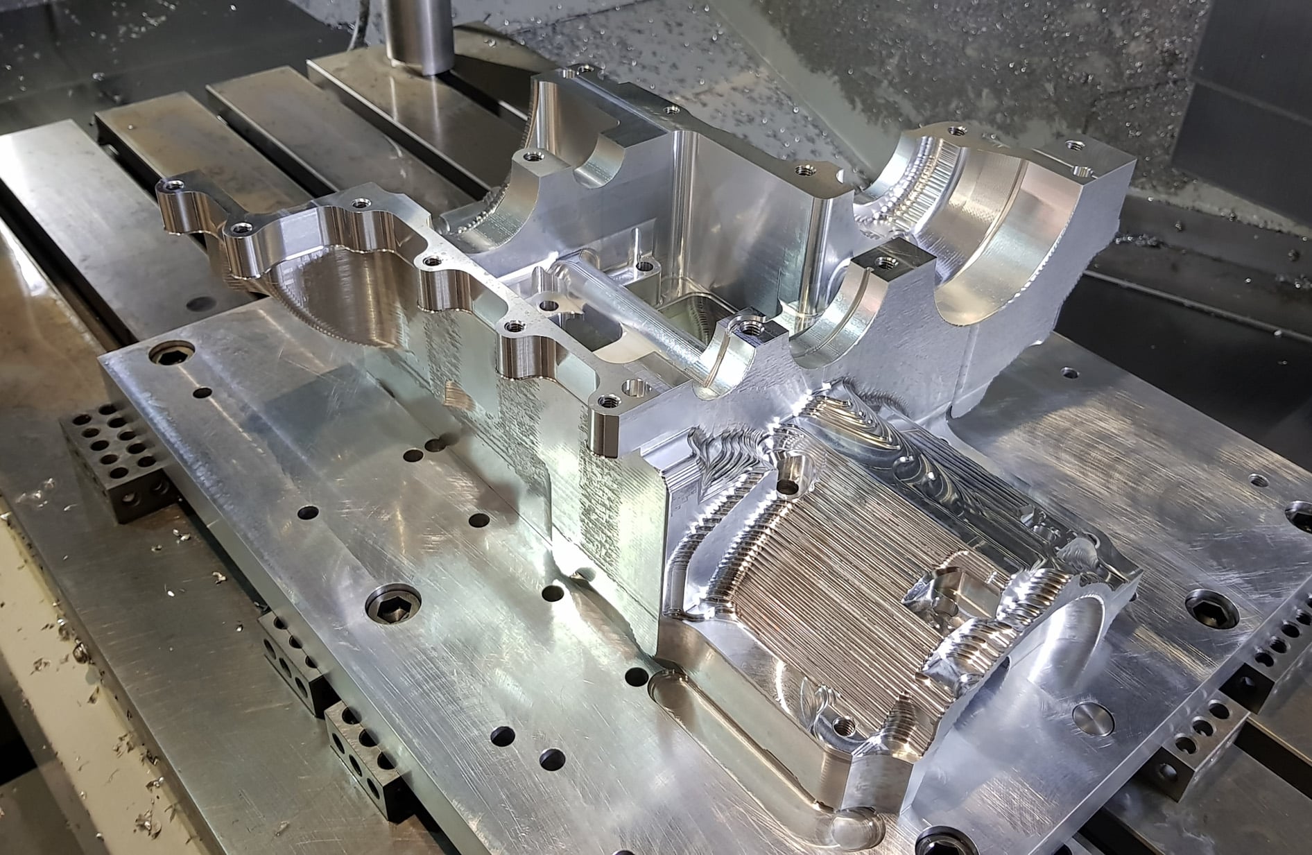

Programming the 11 core components of the re-modelled engine with hyperMILL, Vetech has certainly benefitted from the CAM system. As Mr Smith continues: “Programming and machining the Hayabusa project is not time-critical, what is important for us is the ability to program and machine complex parts with confidence in the collision avoidance system. OPEN MIND have completely modelled the work envelope into the CAM system with fixtures, machine spindle, toolholders and the Hurco 4th-axis rotary table all factored into the model. hyperMILL stores a complete library of toolholders and tools, so we have 100% confidence in the anti-collision system. From a time-reduction standpoint, we programmed an aluminium mould tool for Hayabusa inlet and exhaust caps. With our previous system it took 20 hours to program and with hyperMILL this same tool was completed in less than 10 hours.”
Cutting Machining Times with hyperMILL
The upper housing of the engine consists of seven individual set-ups. With its previous CAM package, Vetech couldn’t carry the stock model from one process to the next. As Mr Smith continues: “Without the ability to carry the stock model forward to the next set-up, we would have to manually jog through the cycle on each set-up to minimise non-cutting times or run the program and wait for the tool path to finish ‘fresh-air’ cutting. The Stock Model feature within hyperMILL eliminates fresh-air cutting and enables us to maximise machine utilisation at every set-up. This makes huge savings on complex parts with multiple set-ups.”
