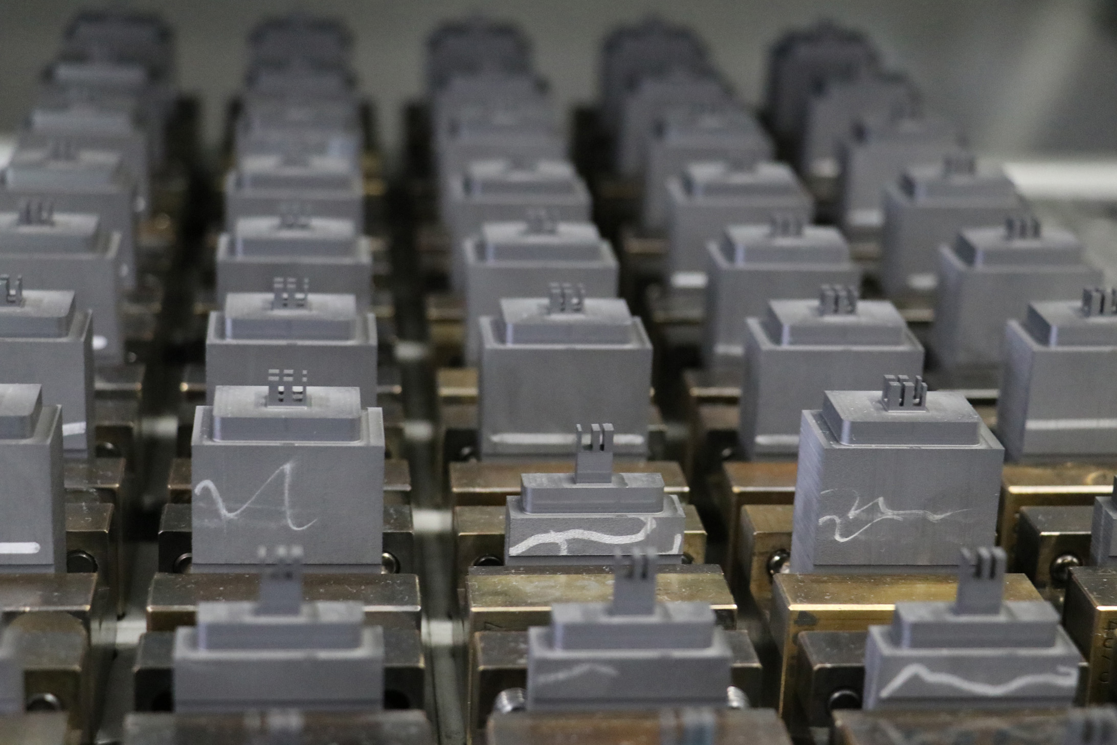

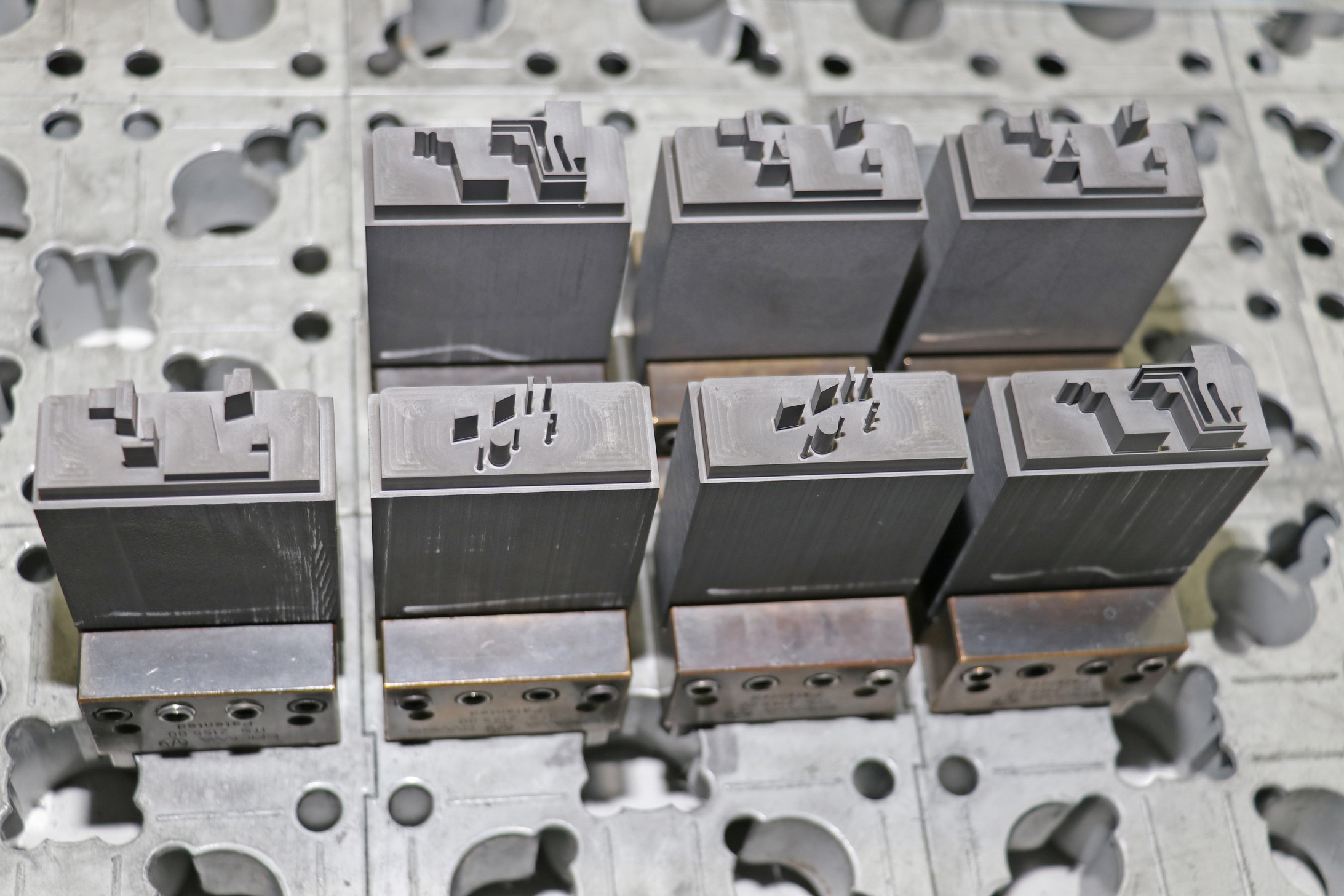

Nils Domack is one of the most experienced employees in the tool making department and this automation is an absolute highlight for him: “It plays a key role in the manufacturing of electrodes. This is because we produce many intricate components such as terminals, connectors and housings, and we need to provide die-sink injection moulded tools for these. This new form of programming is saving both time and money when it comes to producing the graphite electrodes.”
Automation in job preparation has considerably eased the workload of the highly qualified programmers. More than half of all the electrodes can already be programmed fully automatically – from importing the CAD data through to exporting the finished NC data. In these cases, the CAM programmer now just takes the role of ‘tester’. If a component has surfaces for which the hyperMILL automation cannot find a suitable tool, the surfaces are highlighted in colour by the system. When carrying out the test run, the CAM programmer can then see exactly where they need to intervene. Before the NC program is finally released, the programmer must initiate a complete simulation of the machining process in order to ensure that the subsequent processes are reliable.
