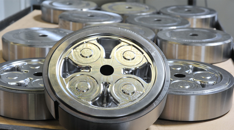

Although 13 programs were considered initially, the company eventually opted for hyperMILL®. It was the significantly reduced programming times that swayed the decision as tool making always involves small batch sizes. Around 200,000 tools are produced each year and the batch size fluctuates between one and 24. The tools weigh between 100 grams and 12 tonnes and are manufactured on 32 machining centres, 17 of these are 5-axis machines.

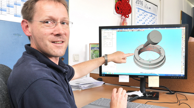

NC programmer Günter Fasching gives an example of how his work has got faster: “In the past, I developed a 5-axis NC program for a toothing stamp; I had to wait for about one and a half hours for the paths to be calculated. With hyperMILL®, the paths are calculated in about five minutes.”

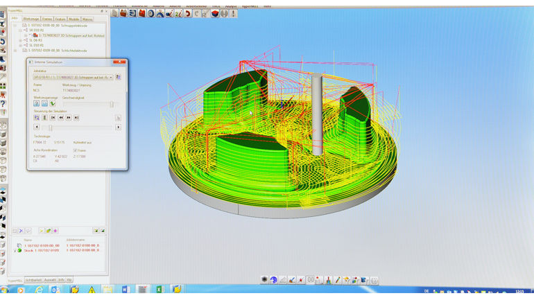

The CAM team in Denklingen has also been able to reduce programming times by using the 5-axis-optimised rest material roughing function. Based on a preceding operation, this cycle automatically generates high-speed cutting (HSC) that is optimised and collision-checked for rest material machining. A further advantage of indexed 5-axis machining is that shorter tools can be used. This guarantees greater stability and performance. This strategy also allows hard-to-reach areas and cavities to be machined particularly efficiently.
According to NC programmer Thomas Karg, it was previously necessary in the past when programming rest material roughing to work forward manually, tilt angle by tilt angle while watching out for various restrictions. Now, if you choose the ‘Indexing’ function, you can define the tilt angles for the B and C axes easily and quickly using two methods. The ‘Planes’ option allows you generate the tilt angle from the plane normal. In ‘3D mode’, the tilt angles are created automatically within a defined range of angles. All connecting paths between the tilt angles are optimised and fully checked for collisions.

Roughing during electrode manufacturing is also drastically accelerated. The Hirschvogel tool makers estimate that an average time saving of between 10 and 20% can be achieved with the high-performance cutting strategies of hyperMILL® MAXX Machining. This is achieved using spiral and trochiodal toolpaths. Dynamic feed rate adjustment according to the actual cutting conditions ensures that milling is always performed with the highest possible feed rate. This results in optimal milling paths with maximum material removal and the shortest possible machining times.
Hirschvogel operates a relatively small machine with a high-speed spindle that machines graphite electrodes. “With our old CAM system, we reached the maximum spindle load. Thanks to the HPC strategies provided by hyperMILL® MAXX Machining, we’re now only at 20 to 30% of the maximum load. This prolongs the machine life and the life of our tools. In the past, we had to replace them after only two or three parts. Now they can easily withstand a complete job consisting of ten parts.”
