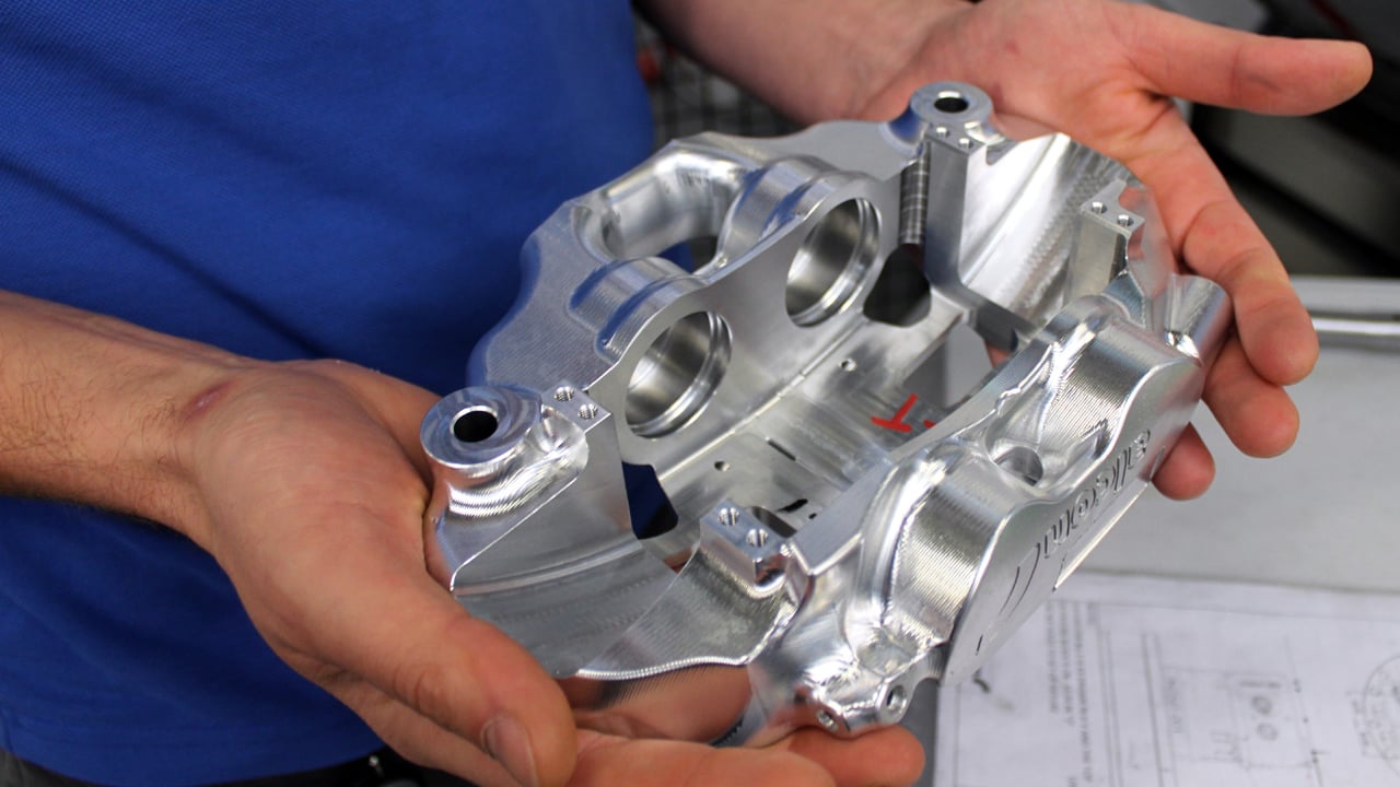

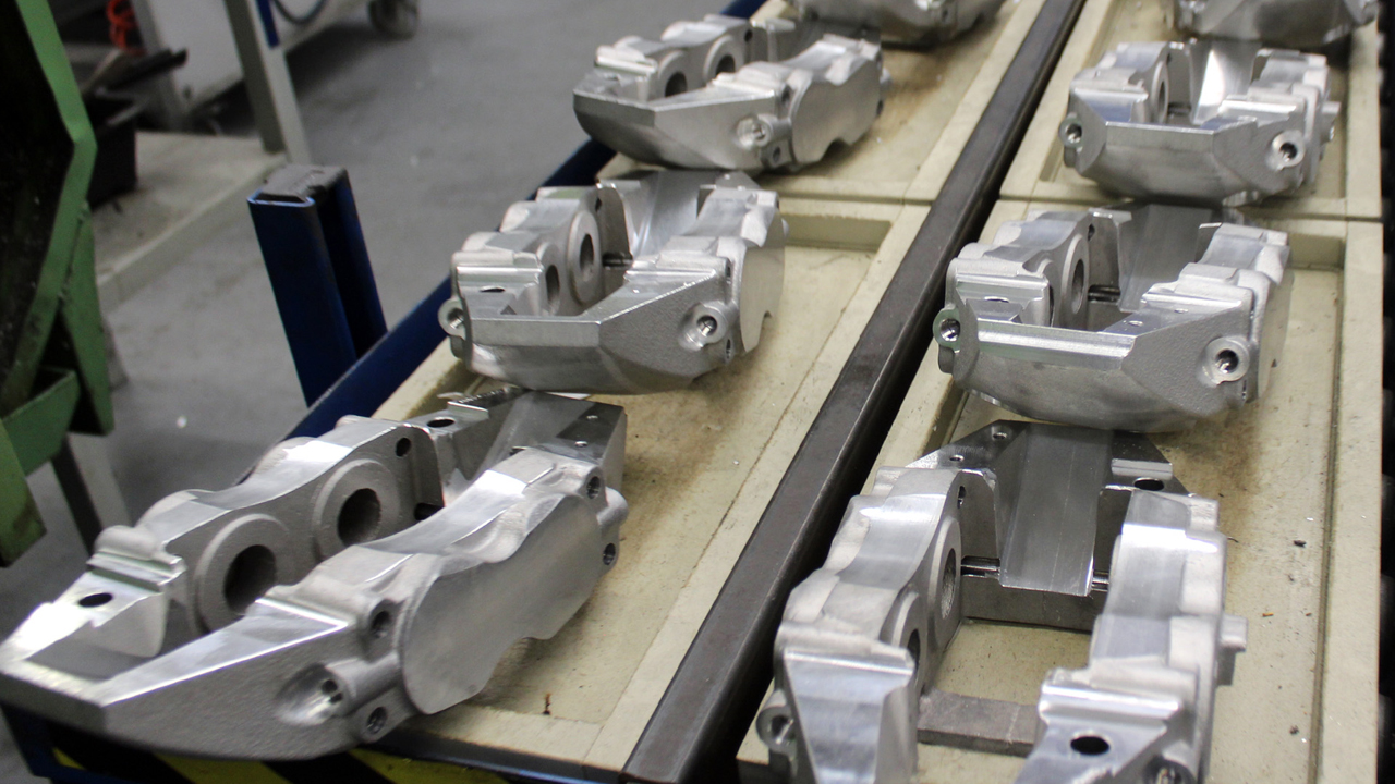

When it comes to machining brake callipers, a solid aluminium billet will go through a complete range of 5-axis machining cycles with four individual operations. Commenting upon this, Alcon Components, Mr Brian Cutler says: “The first operation will be a lot of roughing on a VMC, which is programmed with hyperMILL. We’ll then hold the callipers on their side and machine all the internal features on a 5-axis machine. Then, we flip it over again to finish the top faces and then it will be turned once more for the final operation, which is the machining of the precision piston bores.” Whereas many callipers may be small volumes or bespoke specialist products, the Company is also manufacturing over 100 callipers per week for a high-end sports car.

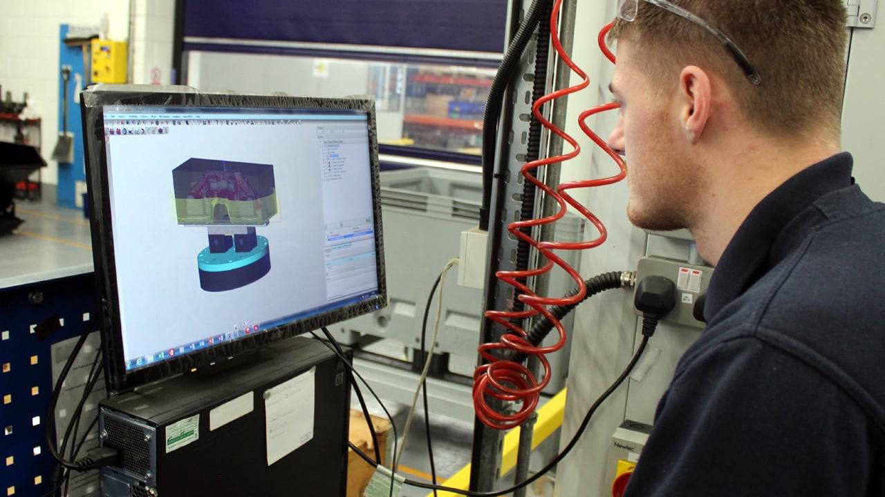

Referring particularly to the company’s investment in OPEN MIND Technologies leading hyperMILL CAM system, Alcon’s Adam Saweczko says: “The reason we moved from another CAM system to hyperMILL was the stability of the software. Since opting for OPEN MIND’s hyperMILL, there has been a huge improvement in performance and calculation times. It calculates the paths with greater speed and it is far more reliable than our previous system. Our previous CAM software was unreliable and it was crashing up to 6 times a day.”
“This crashing was due to the complexity and data requirements of the parts and the respective programs that we generate here at ALCON. The hyperMILL system is very flexible, it allows us to copy proven methods from one program to another and this saves us significant time. We can work with a number of windows open at the same time and this also reduces our programming times.”
Referring to the hyperMILL tool library, Mr Saweczko continues: “The tool library in hyperMILL allows us to store more detail than ever before. We can now store all the cutting data, the tooling suppliers and even the product codes. It now becomes the one-stop solution for our tool management data.”
Commenting upon the 5-axis credentials of hyperMILL, Mr Saweczko explains: “We find the 5-axis features of hyperMILL very easy to use. You no longer have to go into hundreds of different settings to get the job done. The parts we are making are quite complex, but hyperMILL has given us the ability to take existing programs and copy them over to hyperMILL. So, existing and proven cycles can be applied to the existing part.”
