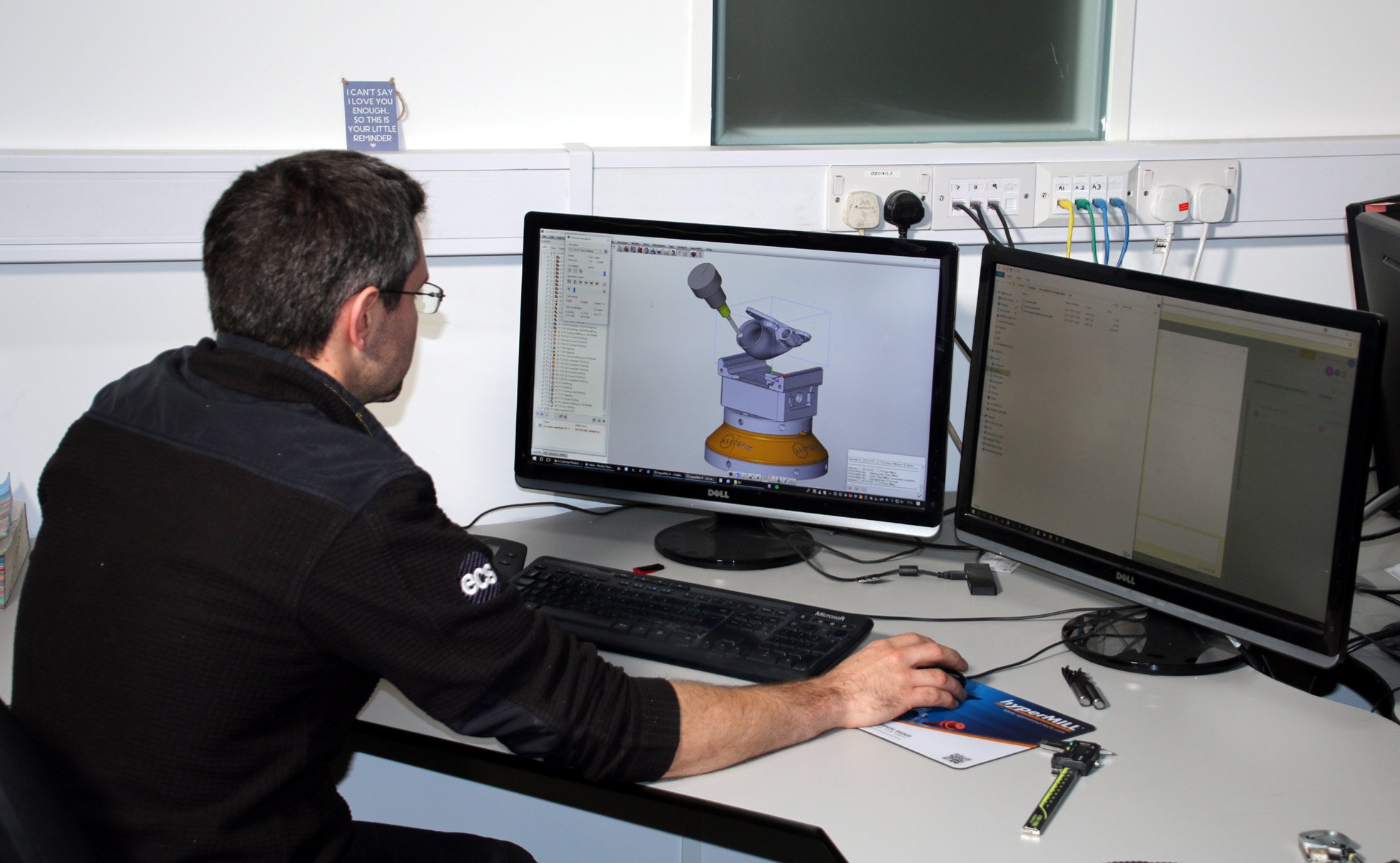

“We were machining a complicated engine block and with the time invested in programming the job, we wanted to be sure the program was correct before the job went on the machine table. With our previous CAM solution, the simulation and collision detection was not really at the level we needed.”

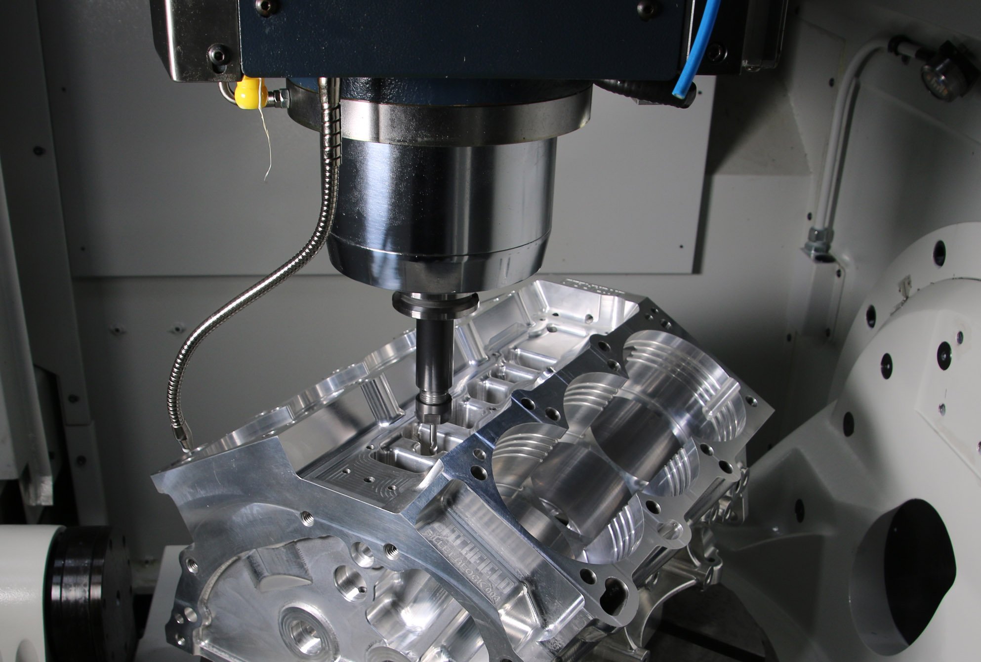

Taking the engine block from design through to machined component, Mr Cudd says: “This engine block was designed in house, so there was over 100 hours of design hours and another 100+ hours of programming with our previous CAM system. Putting so much time into an engine block and not being confident in the anti-collision credentials justifies buying hyperMILL. Calculation times are massively reduced and in the case of this engine block; hyperMILL has reduced programming by at least 50%. Collision checking is a critical factor. Now, we can put the full CAD model on the machine and if hyperMILL says the model is good, we know we can machine with complete confidence.”

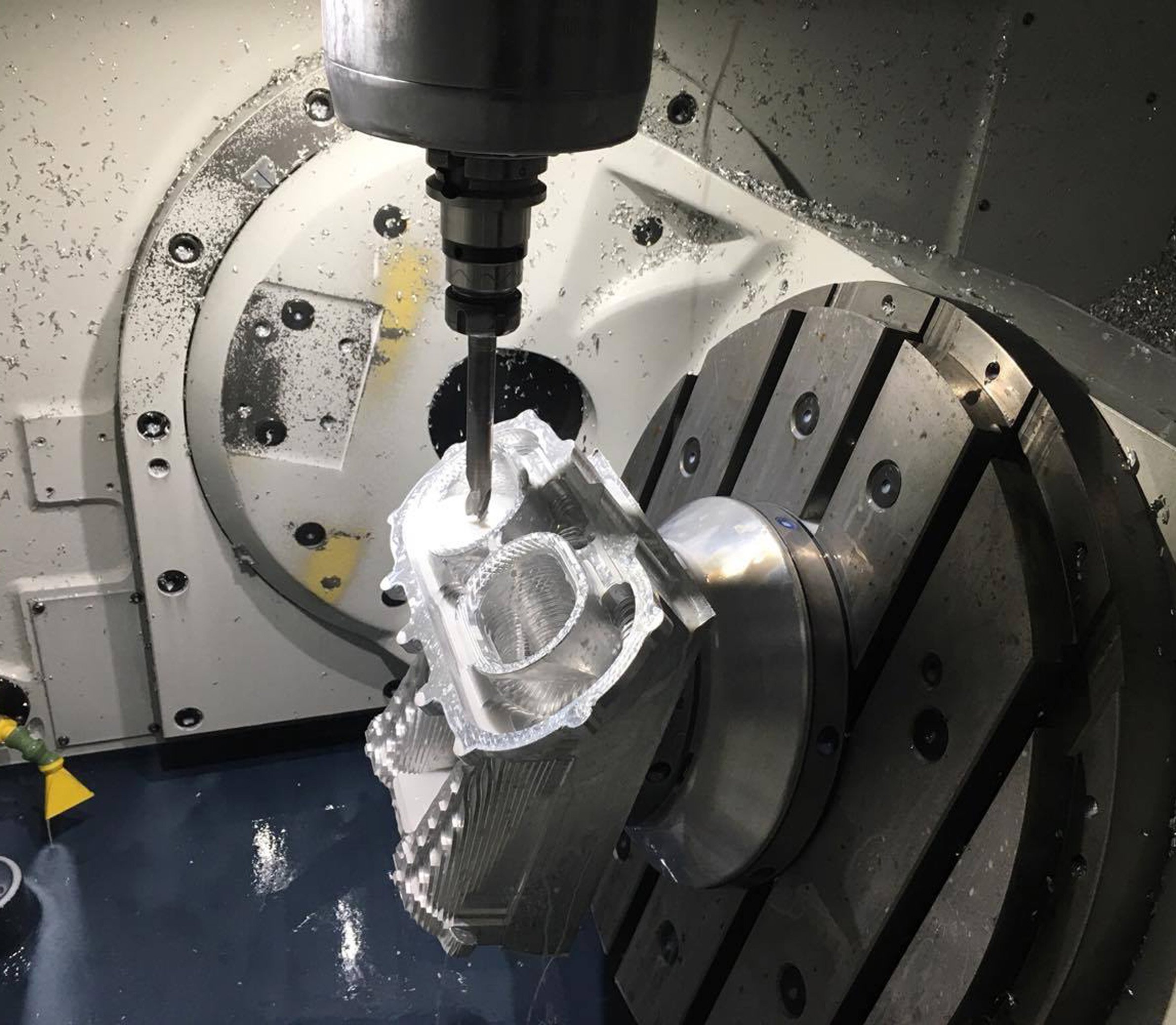

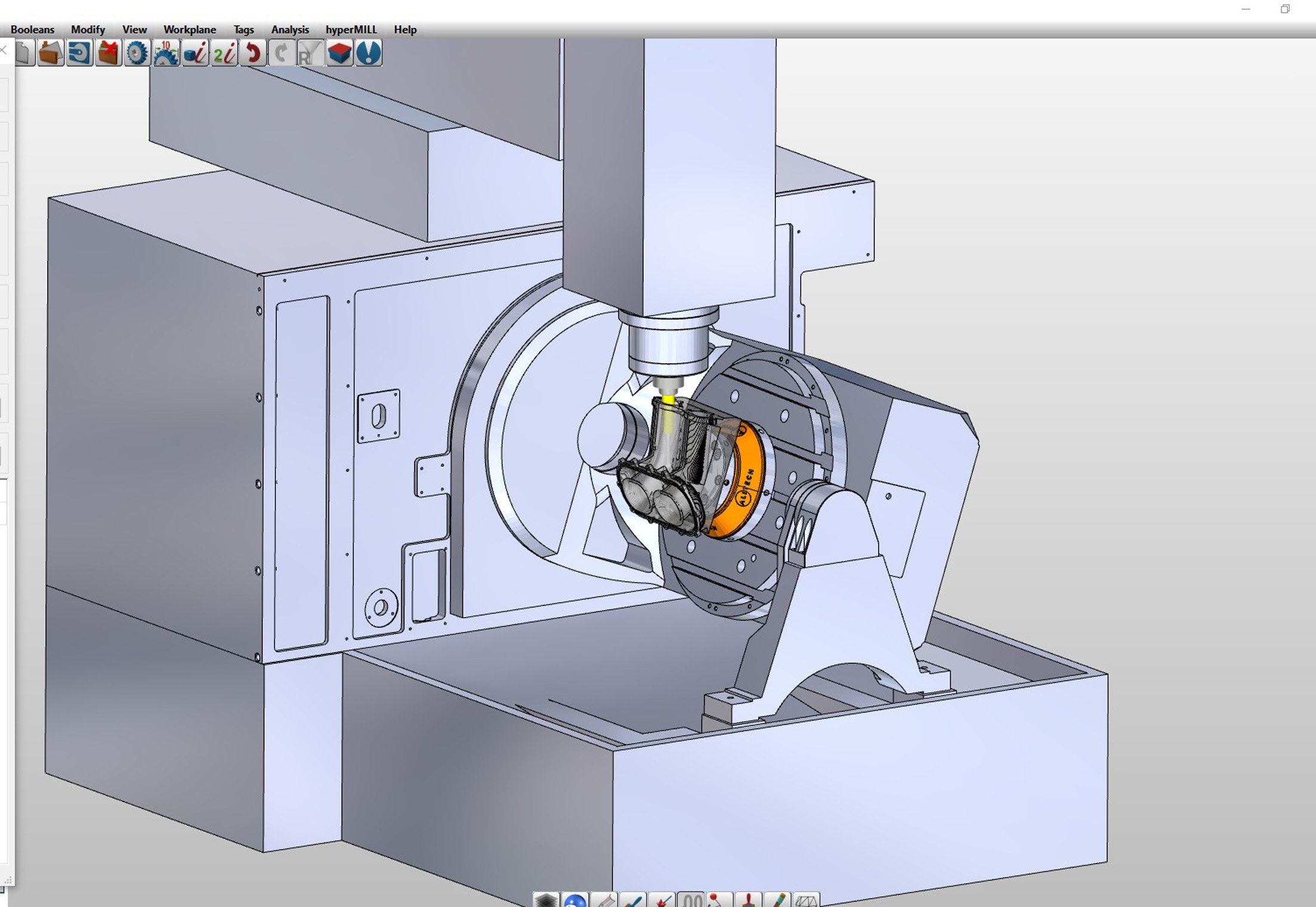

Referring to collision detection and avoidance features, Mr Cudd says: “We recently machined a billet turbo manifold for a motorsport customer. It required two 40mm diameter oval shaped port holes with a curved machining depth beyond 200mm. We used an 8mm diameter ITC lollipop cutter protruding 70mm out of a slim 80mm heat-shrink toolholder extension with a 75mm long back-end configuration.  hyperMILL modelled the complete work envelope and detected the collision parameters for the cutting tool, toolholder and machine spindle. By precisely simulating the process, we are running at high-speed and the heat shrink holder is often as close as 0.25mm to the port walls during HSM.”
This feature works in complete harmony with the hyperMILL Z-Level Finishing Cycle that enables Alitech to lean the cutting tools at angles that are very close to the wall of the port holes. This permits Alitech to run short-length cutting tools in port bores. The benefit of this is improved stability, rigidity and surface finishes that permit machining at higher speed and feed parameters.
