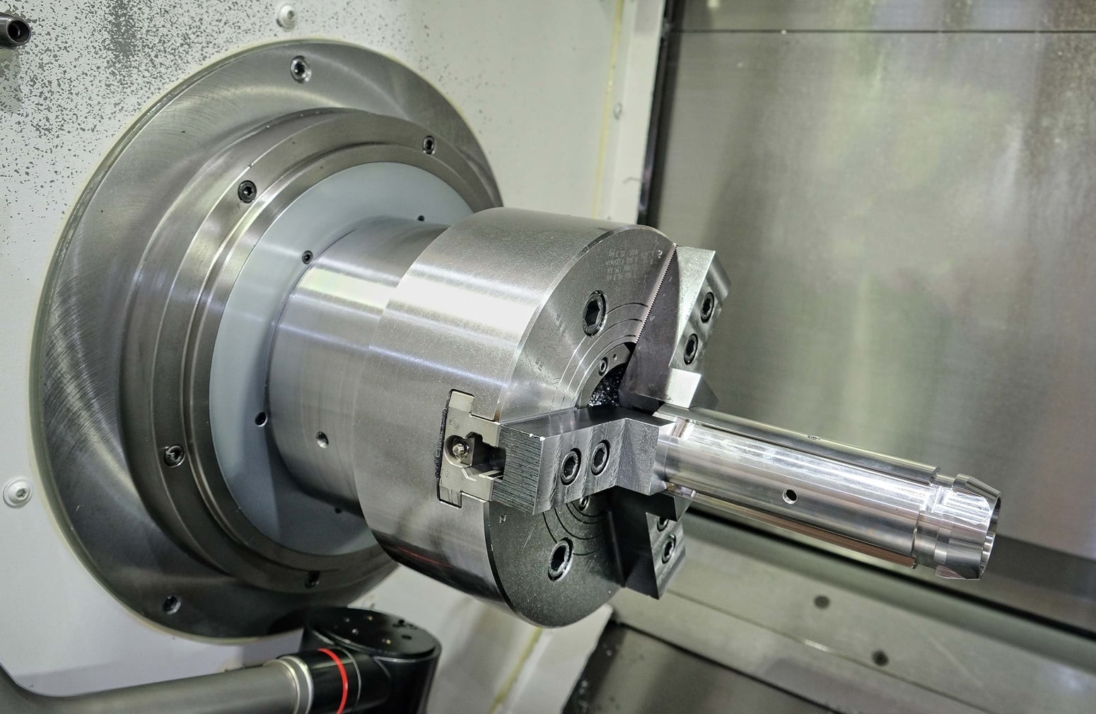

Mr White commented, “It is an extremely rigid, slant-bed lathe on which we carry out a lot of machining including deep hole drilling in titanium and Inconel. It is not feasible to leave it to produce such high-value parts unattended, so we do not intend to add automation on this machine.

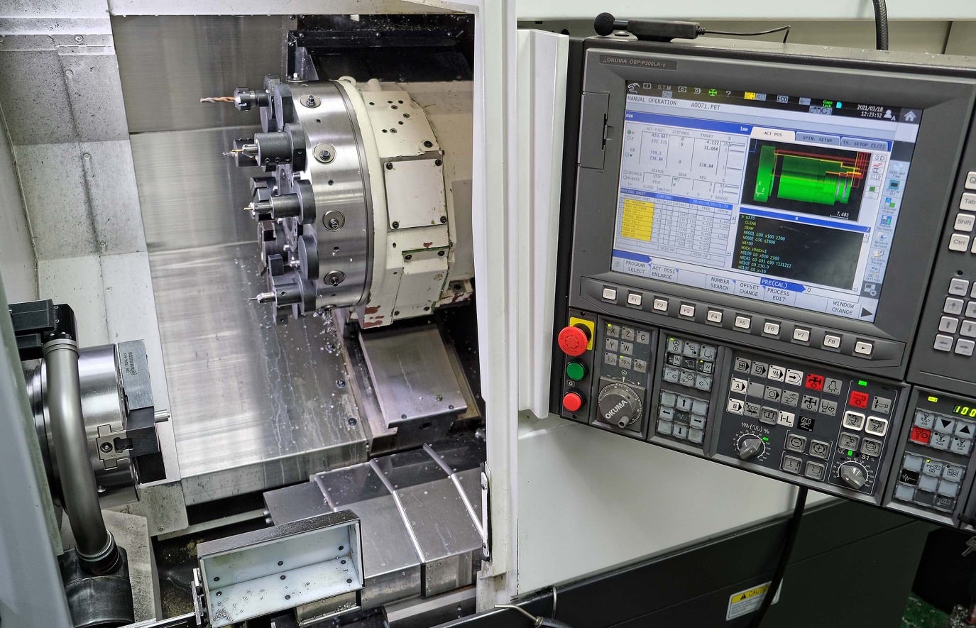

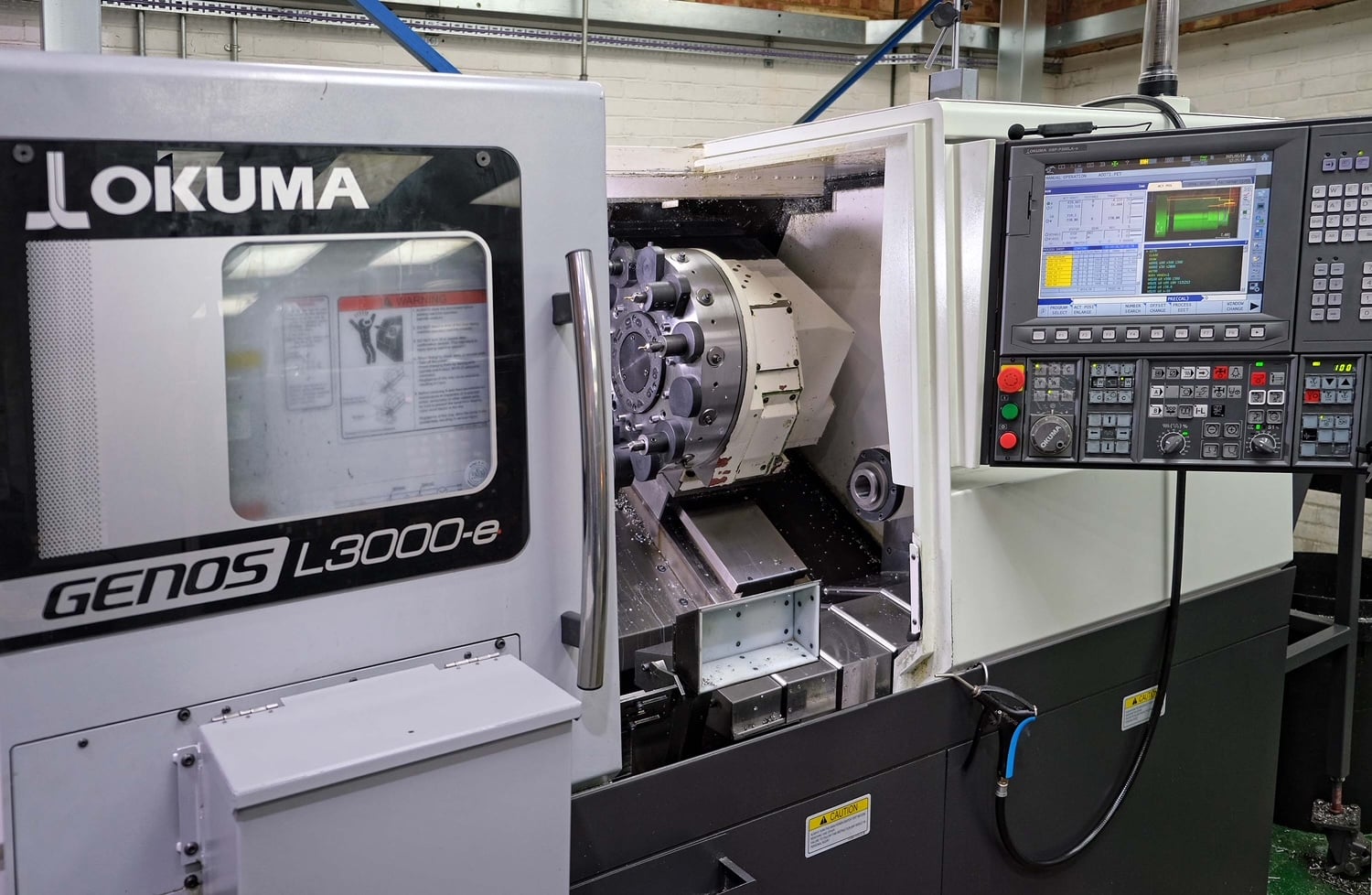

“The same currently goes for the Okuma Genos L3000 that we bought the same year, as it is a two-axis lathe with live tooling dedicated to producing smaller parts in lower volumes.
