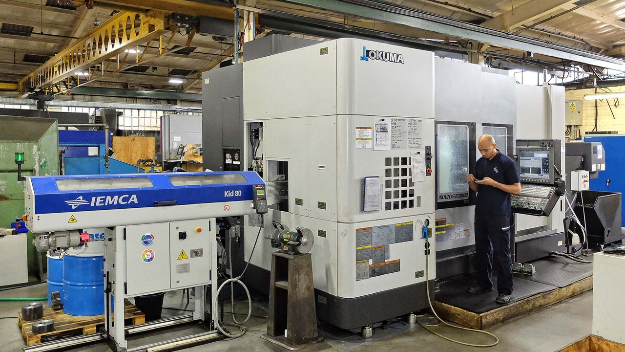

To take advantage of the latest technique for machining them accurately and quickly, the firm has invested in a gear skiving machine, a Multus U3000-2SW from Okuma, Japan. The bar-fed, multi-tasking lathe was supplied last year by sole UK agent NCMT (www.ncmt.co.uk), which is about to retrofit automation equipment of its own manufacture to speed the handling of components, free up operator time and make the process even more efficient.

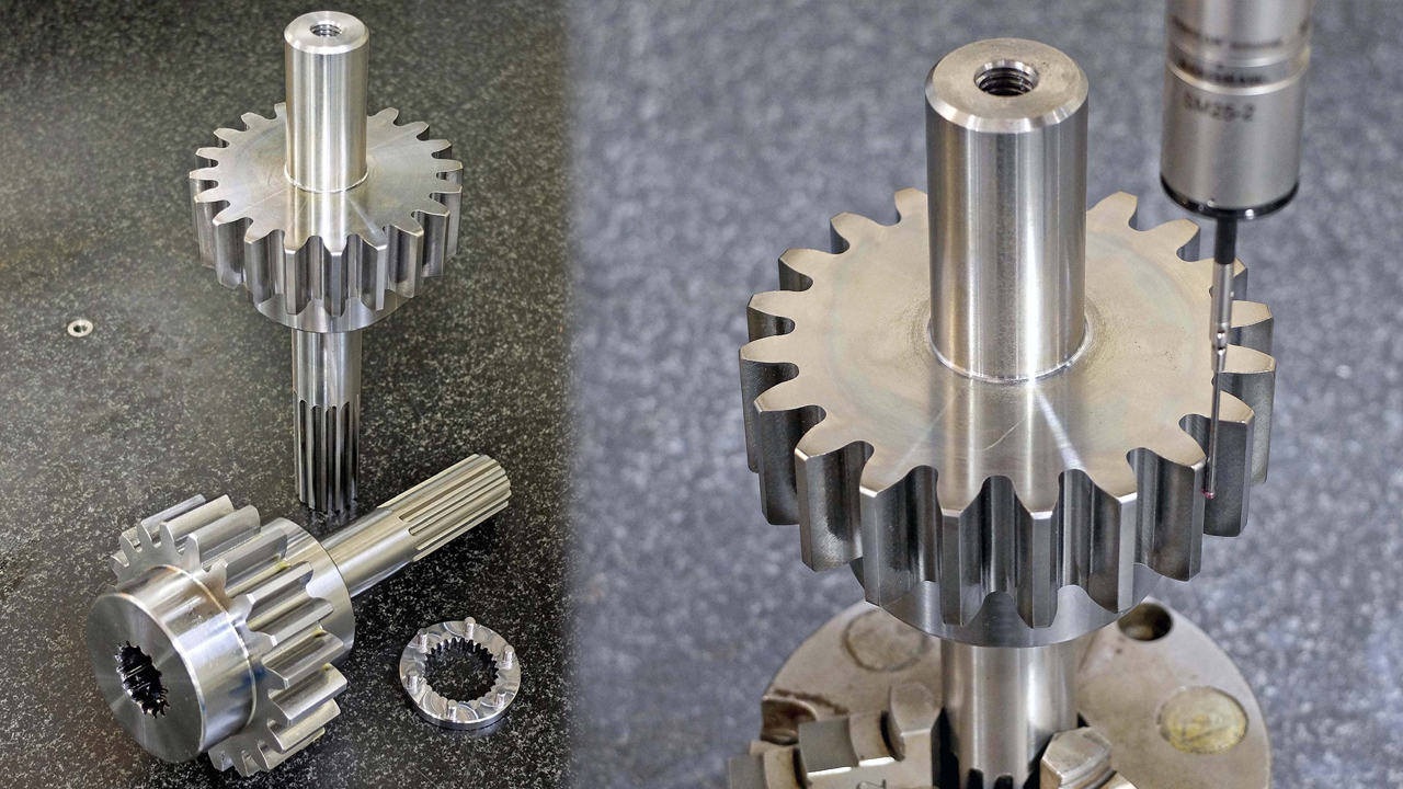

Currently, three types of fairly open tolerance DIN8 gear for a US-built horizontal drilling machine are being produced on the Multus U3000 in Brighouse. Two are complex, shaft-type components and the third is a smaller, consumable item. They are all turned and skived from AISI 4140 steel bar or billet, the bar being fed from an Iemca Kid 80 short magazine capable of handling 1.1 m long stock up to 85 mm in diameter.

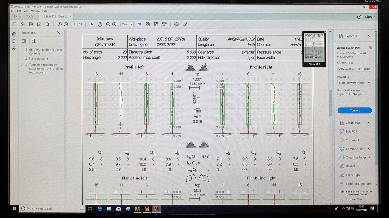

Around 3,500 each of the two gear shafts are needed annually, while the consumable item requirement is 2,400 per year. They are checked for accuracy on a Mitutoyo Crysta-ApexS CNC coordinate measuring machine that has been provided with full gear inspection software. Before delivery, all three components are surface treated after machining using the Tufftride QPQ process. As of July 2019, production of the next gear to be supplied to Vermeer started on the Multus, with another six parts in the pipeline.
Investment in production equipment at the Brighouse factory has exceeded £3.0 million in the last five years. In addition to the Okuma Multus and the CMM, a hobber for producing larger round gears has been installed as well as a CNC slotting machine for producing internal gears. One operator is required to run the three production machines, which are positioned within a cell alongside the measuring machine, leading to significant economy in labour costs bearing in mind the machines run for two shifts, five days a week.
