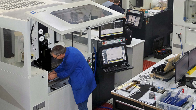

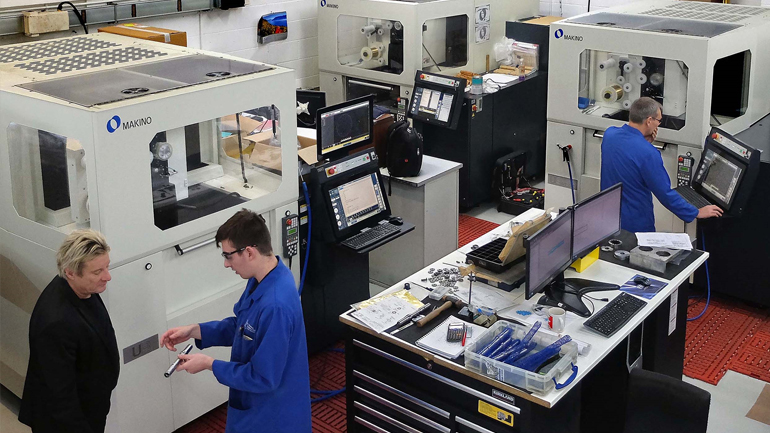

The situation has been turned on its head following the arrival over an 18-month period of three Makino wire EDM machines at an FT Gearing satellite facility close to the company’s main factory. The machines were supplied by NCMT (www.ncmt.co.uk), UK agent for the Japanese machine builder. Within six months of the first arriving, the gear specialist had gained Nadcap approval, while the latest EDM machine installed mid-2017 provides capacity for internal development projects and offering a subcontract wire EDM service.

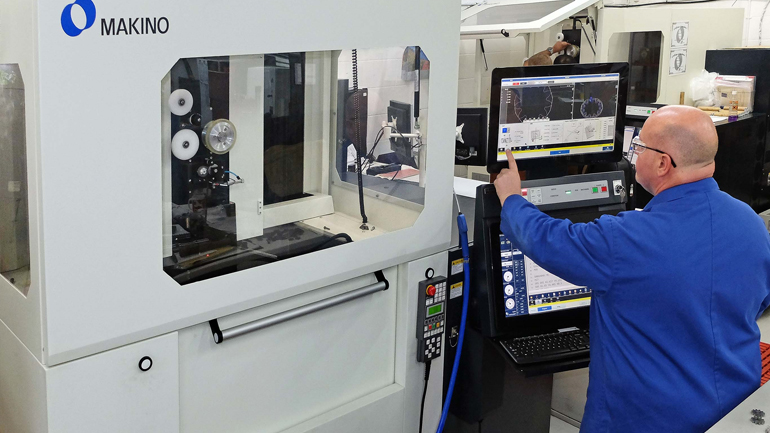

Managing director Graham Fitzgerald, who started the business with his father Des in 1978, commented, “We chose U3 wire eroders from Makino after we employed a skilled EDM machinist that has a lot of experience operating machines of the same make and rates them highly.
“He says that ISO programming on the Fanuc-based control is far easier than on some other EDM machines that employ two languages, macros are simpler to create and operations like rotation and mirror imaging are straightforward.
“From my perspective, quicker programming leads to higher productivity. The machines are also reliable and their build quality means they sit well alongside top-end, 4- and 5-axis machining centres in our Unit 19, which we recently opened.”
The latest Makino wire EDM machines are fitted with the Hyper-i CNC system, which contains an extensive library of cutting conditions that automatically optimises the erosion process, even for sealed and poor flush applications. The control employs so-called HyperCut technology, a process developed to produce surface finishes as fine as 3 microns Rz in standard tool steels in a three-pass process. Chris Elwick, manager of Unit 19, advised that the same result would take at least six passes on other makes of wire erosion machine.

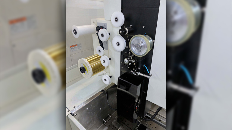

Makino’s U3 wire EDM machine and the larger U6 were launched in the UK on the NCMT stand at MACH 2016. They offer competitive cycle times as well as high accuracy and surface finish, even using uncoated brass wire, and also feature low wire consumption. The machine is of stationary table design and the entire bed casting serves as the dielectric reservoir, reducing the footprint and eliminating the need for additional external fluid tanks.
