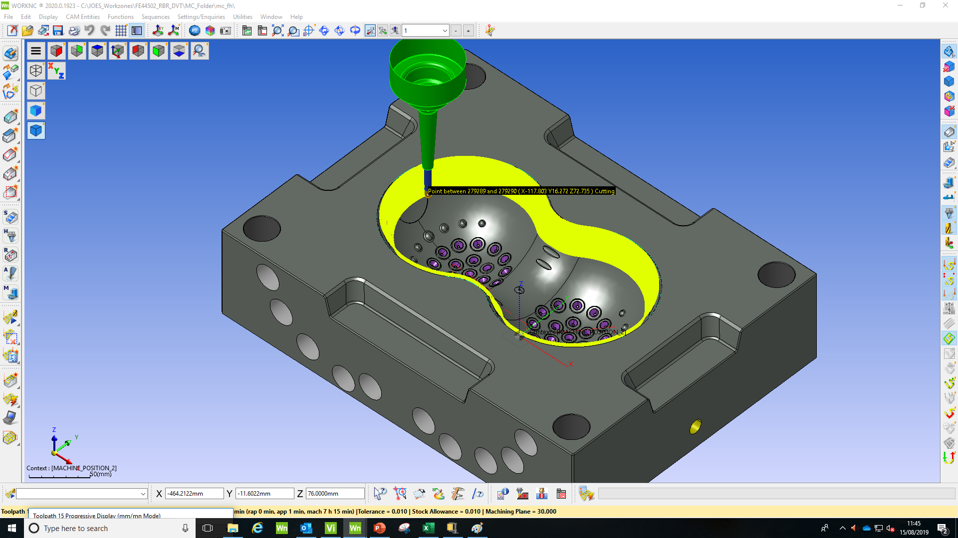

The mould tool for it was designed in VISI, and cut from P20 tool steel on a Dugard CNC machine programmed with WORKNC – both software solutions from Hexagon Manufacturing Intelligence’s Production Software business.
When RBR ActiveTM’s Managing Director, Paul Westerman, approached Fenton, it was to ask if they could produce a mould tool for the overmoulded concept. “We suggested it would be better to mould it as a one-piece product,” says Richard Brown, Fenton’s Technical Director. “VISI’s reverse engineering capability was essential, to take the point data from our CMM and combine surfaces and solids, and seamlessly work between the two.”
The wall section at the top of two dome structures on the product, which contains 38 nodules, had to be particularly thin to allow flexibility. “But there’s obviously a limit as to how thin we could make the wall. We got the optimum thickness through VISI Flow Lite, which simulates the filling phase of the injection moulding process. Design Engineer Martin Edwards defined all the initial moulding criteria and gating positions with it, to achieve a well-balanced filling of the cavities under optimum manufacturing conditions.

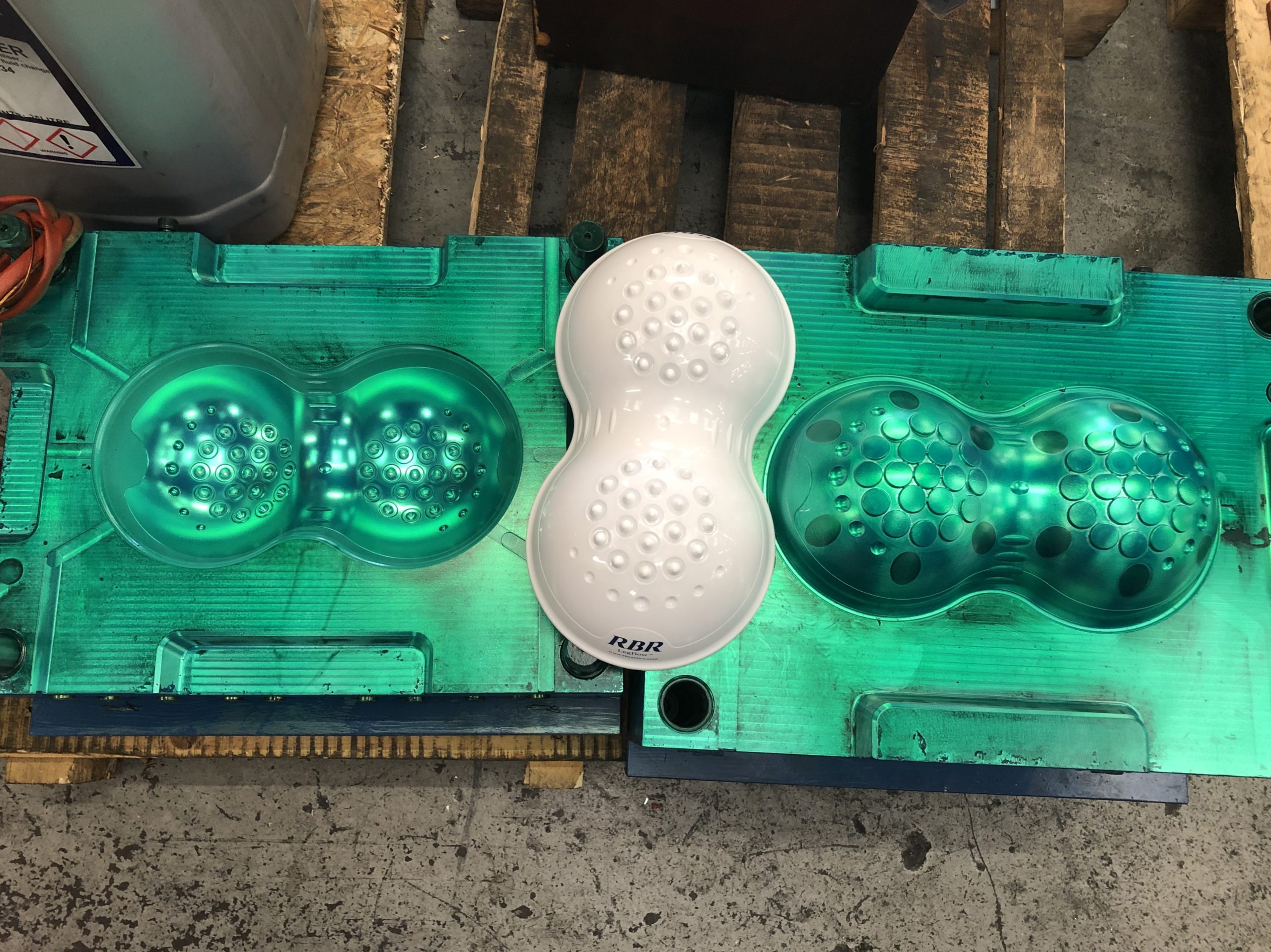

“Once he was happy with that, we had 3D prints of the product made, and after a few minor design changes, Paul Westerman signed it off, and we constructed the tool around it using VISI Mould, with its built-in Meusburger catalogue for the native parts.” Richard Brown says that because of the radius shape, the CAD room decided that holes for the eight ejector pins should be produced using their wire eroder after the main surface had been machined on the Dugard. Both sets of toolpaths were generated in WORKNC.
He describes the mould tool as being “straight open and close,” with two cavity plates, support plates, and back plates, comprising around 30 different components. “One of the design challenges was to ensure there were no side actions or lifters.”
The complete tool manufacture took around six weeks; the cores and cavities were machined through WORKNC, with each plate taking around 25 hours, and a further 20 hours for the build. “It was quite a complex format, with a lot of small solid carbide cutters from a variety of suppliers. We also used shrink fit tooling to ensure grater accuracy, balanced chip loads, better finishes, and increased speed and feed rates.” And he says WORKNC’s ability to produce high quality surface finishing kept any additional polishing to a minimum.
