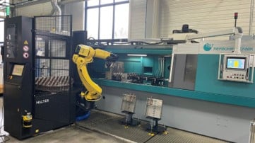

This ultimately resulted in a project that has some special features in terms of the flexibility of the robot cell, a Halter LoadAssistant Universal Premium 35, when loading and unloading the deep-hole drilling machine.
Modified robot cell with modified kinematics
In contrast to the standard solutions from HALTER CNC Automation, the specially designed robot cell in this case loads the machine not with one, but with four raw parts. To do this, the robot must move the axes in both axial and radial directions. “That is why, among other things, the programming of all movement sequences and thus the entire robot kinematics has been adjusted and a gripping station has been installed in front of the machine,” says Florian Hartmann.
The robot arm itself also has a double gripper with workpiece-specific gripper fingers that are also adapted to the shaft diameters to be handled.
Suitable for longer shafts as well

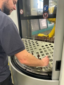

As a material buffer, the robot cell has a standard grid plate for shafts with a diameter of 20 mm to 35 mm and lengths of 75 mm to 250 mm, which can hold a total of 176 workpieces. In addition, a special grid plate for shaft diameters from 35 mm to 50 mm with a capacity of 88 workpieces has been developed, as a result of which the LoadAssistant Universal Premium 35, unlike the standard version, can now transport parts with a length of up to 550 mm.
Higher process reliability through position control
The robot cell was first used in March 2023. “We were well aware that both HALTER CNC Automation and we were entering new territory with this solution, so that we had to make further optimizations during ongoing production,” says Florian Hartmann.
In a continuous cycle, the robot prepares the loading of the already running machine for machining a total of four axes by removing one blank from the workpiece buffer and placing it in the gripping station. Once the four-axis production is complete, the robot removes a finished part with one side of the double gripper. In doing so, it first checks the position of the part in the machine and, if necessary, measures the length of the shaft again via a sensor integrated into the cell in order to prevent a possible collision when the part is placed in the gripping station. Florian Hartmann explains: “Due to the dragging of individual parts when leaving the clamping position in the deep-hole drilling machine, it can sometimes happen that an axis is not in the position intended for the robot gripper after releasing the taper. That is why HALTER CNC Automation integrated the sensor into the robot cell.”
Production preparation running parallel to the processing time
After checking the position of the part, the robot places the finished part in the gripping station, grabs a new raw part and loads the machine to remove another finished part. This happens a total of four times. All motion sequences between the workpiece buffer and the gripping station after loading and unloading take place parallel to the machining time and therefore do not affect the productivity of the deep-hole drilling machine. Once the workpiece buffer is finished, it is automatically rotated so that new blanks are immediately available for production. Meanwhile, the finished parts can be removed from the back of the cell and the material buffer can be loaded with new raw parts.
