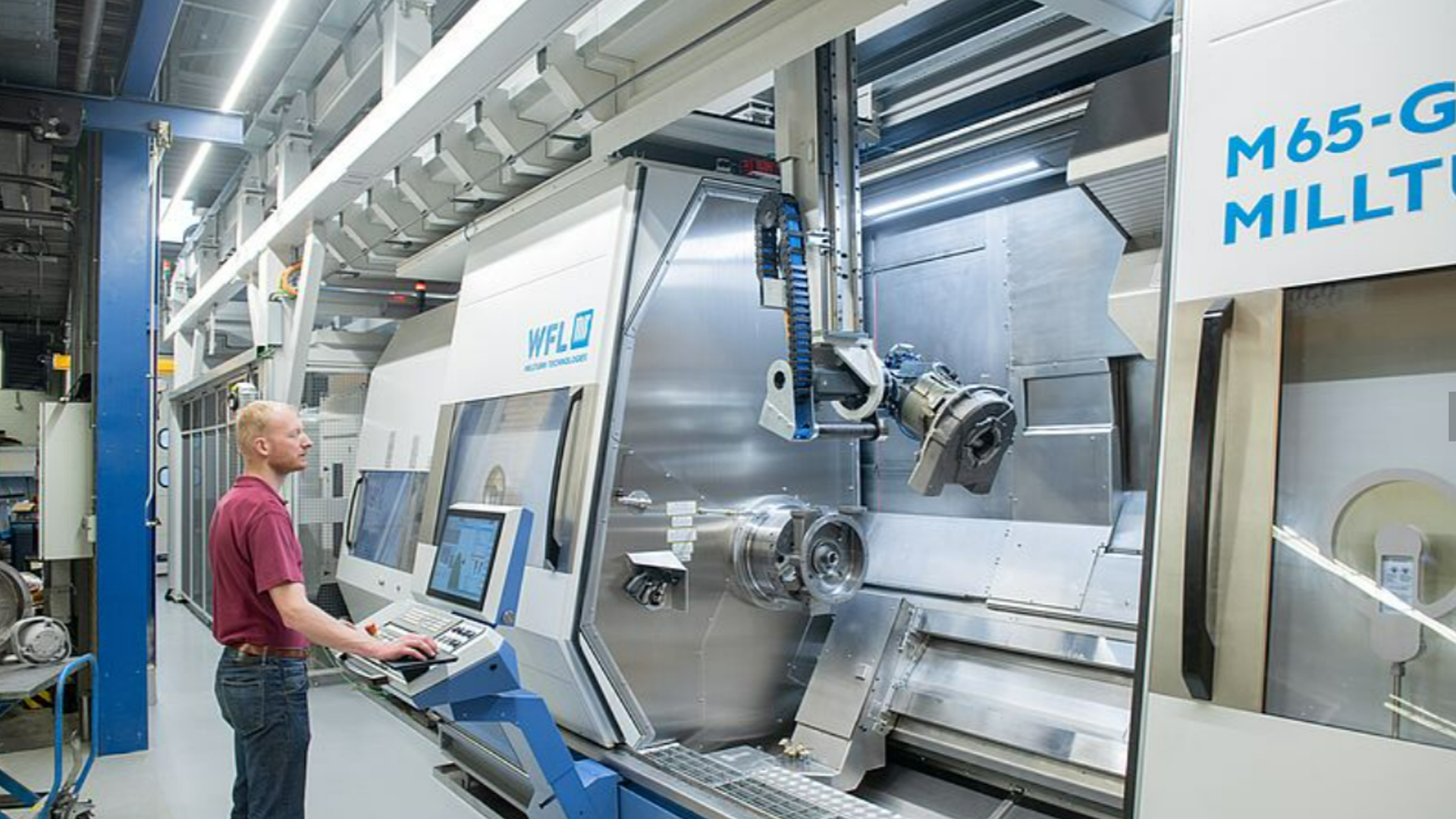

The new WFL M65‑G has a nominal centre distance of 2,000 mm. Both spindles have an output of 56 kW. The two spindles and milling spindle allows for complete machining of workpieces. “In this project we actually focused on unmanned production. The production cell takes the material out of the storage and after machining, places the finished workpiece back in the storage without any human intervention. Here, it is important that various workpieces can be produced interchangeably. In this way, we can produce the different parts of a pump as a set, with the advantage that we can sell and paint faster. To make this possible, the machining centre must have several important elements that not only allow for an unmanned production process, but also a high degree of flexibility.”
Optimisation in the small details
In order to machine a wide variety of parts automatically, Bredel has equipped the turning-milling centre from WFL with a large chain magazine. The magazine has room for a total of 200 tools, while taking up relatively little space, just a few square metres. The magazine’s special feature is that it can accommodate tools with a length of up to 900 mm. This was a particular requirement of Bredel to be able to store long broaching tools. “For this project, we took a critical look at the cutting tools. A working process can always be improved and the tools play a crucial role. Take, for example, combined tools to reduce tool change times or special tools that can perform a process much faster. All these little things help to reduce throughput time and lower the cost of the workpiece. This is the only way businesses in the Netherlands can continue to compete with the rest of the world,” believes Groteboer. In order to machine gearings and grooves, Bredel has developed a special broaching tool in consultation with WFL. Usually, the tool needs a feed force of 100 kN, which was not achievable even with the WFL machine. The adapted version has a feed force of just 30 kN. Whereas previously the shaping of gear teeth in a part took half an hour, the process takes just 1.5 minutes using the adapted broaching tool.
