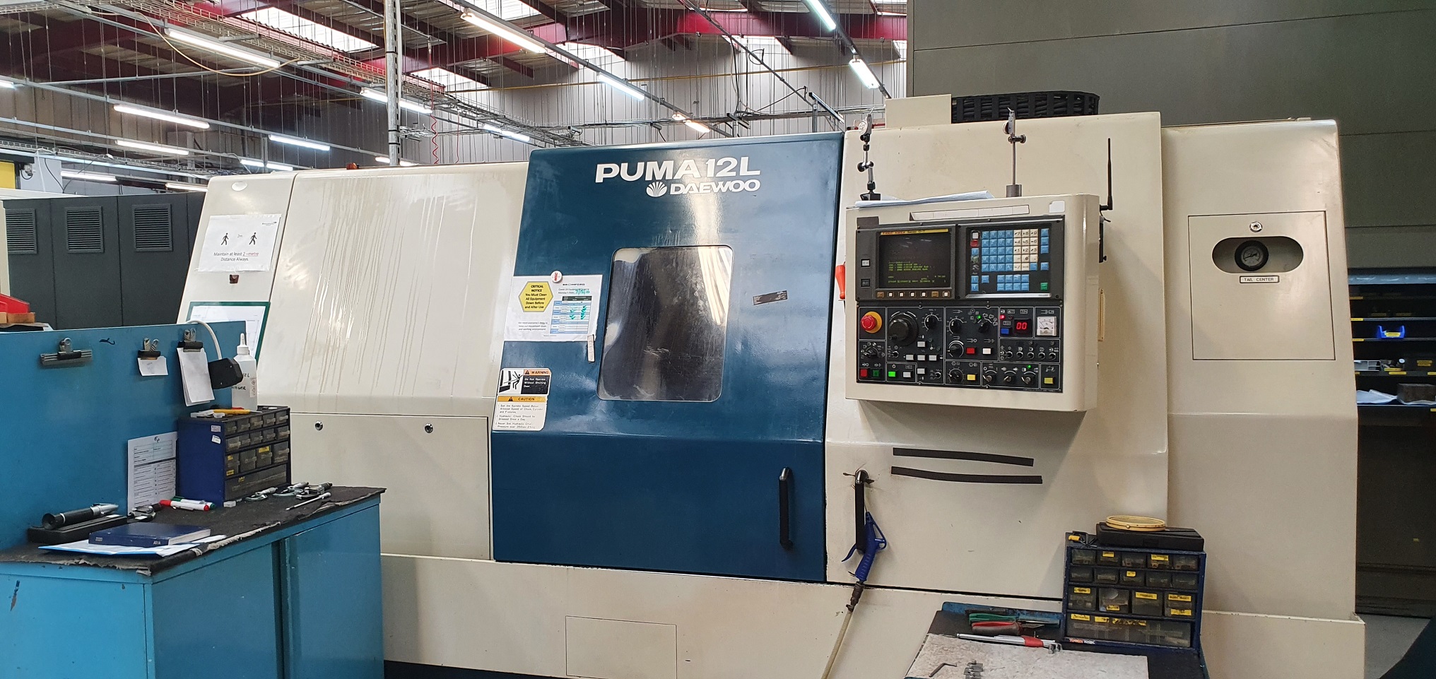

To manufacture the initial batch of four Inconel 718 aerospace engine components for one of these prestigious customers, MSC applied its technical expertise, drawing from the industries largest team of application engineers, to ensure the complex components could be manufactured to specifications, and on time. With cutting tool datasheets from the US being obsolete due to the tools being unavailable, the MSC experts started from scratch and identified a rationalised tooling portfolio from a variety of suppliers, mitigating any special tooling to undertake the three operations to meet the specified deadlines. Machining the four components on a Doosan Puma 12L turning centre, the MSC solution succeeded in meeting the Bromford deadline for the initial tests.
