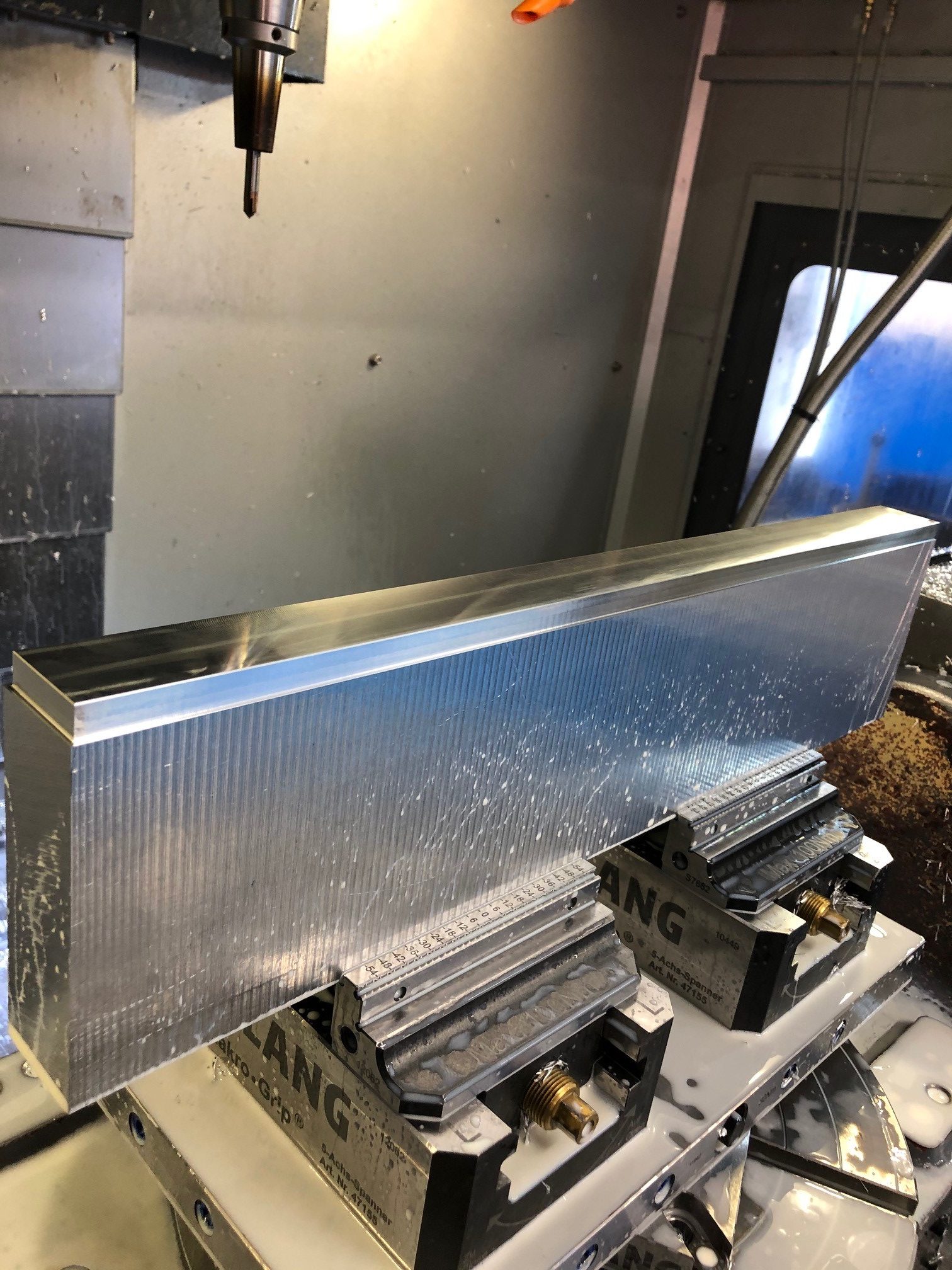

The MSC engineer was given the work envelope and axis movement dimensions of the Leadwell V40i 5-axis VMC and intuitively configured a solution with Lang Technik, the existing workholding provider at Arrowsmith. The solution included the adaptation of the existing zero-point clamping system to add a secondary clamping plate and two Lang vices for clamping the extra-long parts.  Lang Technik assisted MSC to offer Arrowsmith a viable solution; the MSC engineer had managed to theoretically reduce set-ups and subsequently eliminate the opportunity for dimensional error that can occur from multiple set-ups.

The MSC strategy was to face machine the top of the part and add the location features for the zero-point clamping system. The second set-up was to undertake the complete machining of the remaining faces, edges, pockets, chamfers, holes and threads. The tools selected for the process were a Kennametal face mill with three indexable inserts that cost-effectively replaced a previous 6-insert face mill, as well as a solid carbide Accupro Drill and a DC Swiss threading tool. Following the heavy material removal operation, MSC collaborated with SGS and used a series of 2, 3 and 4-flute solid carbide end mills, ranging from 2 to 16mm in diameter. Both square end and ball nose designations were utilised for machining all features, including edge radii, pockets and slots.

By undertaking the project remotely, MSC has seamlessly integrated this complex machining process into the shop floor at Arrowsmith. By adapting the machining strategy to just two set-ups, MSC has guaranteed process stability for critical aerospace components with tolerances across the part tied to less than 50 microns. As well as ensuring process stability, MSC has instigated a machining strategy that is yielding a cycle time of just 2 hours 20 minutes for the extremely complex parts whilst demonstrating exceptional surface finishes. Furthermore, by utilising specific cutting tools from SGS Carbide, Accupro and Kennametal, MSC reduced tooling costs and consumption via improved tool life and greater flexibility and autonomy for all aluminium machining tasks.
