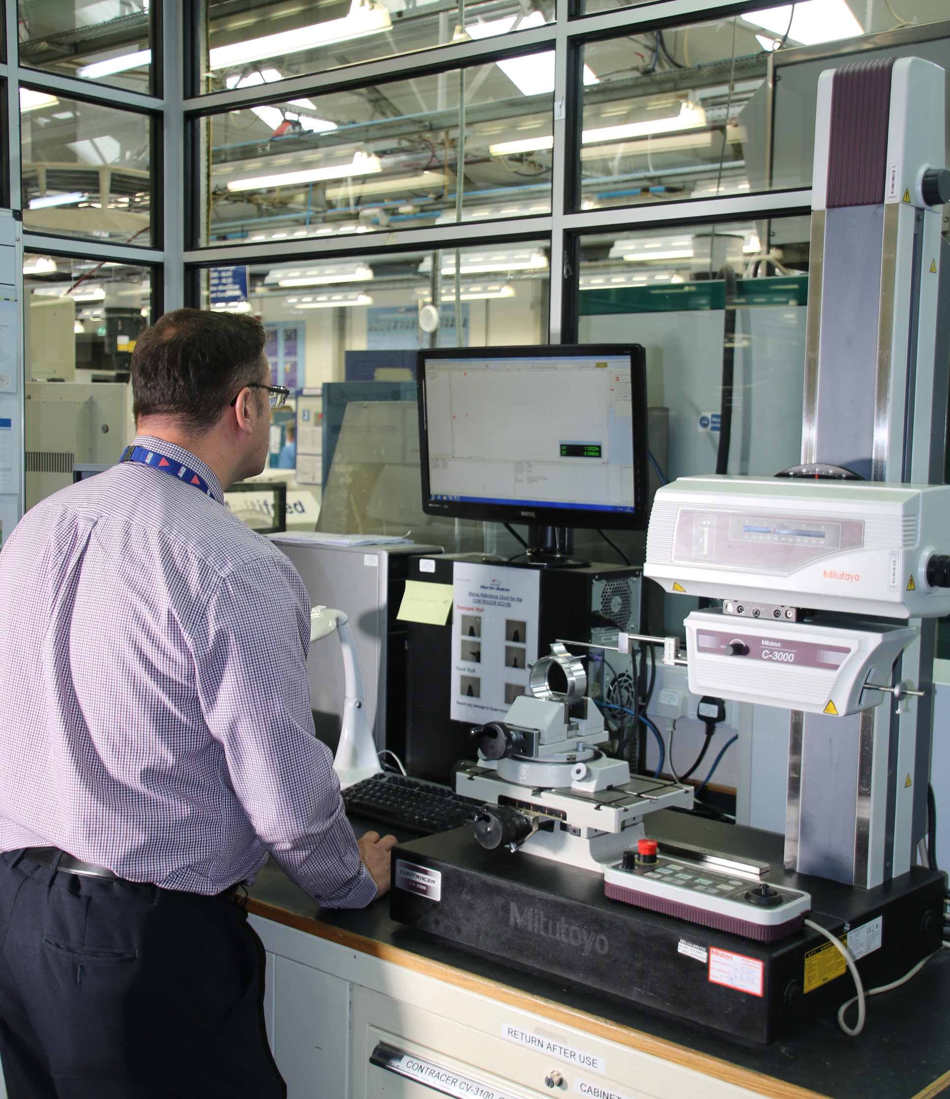

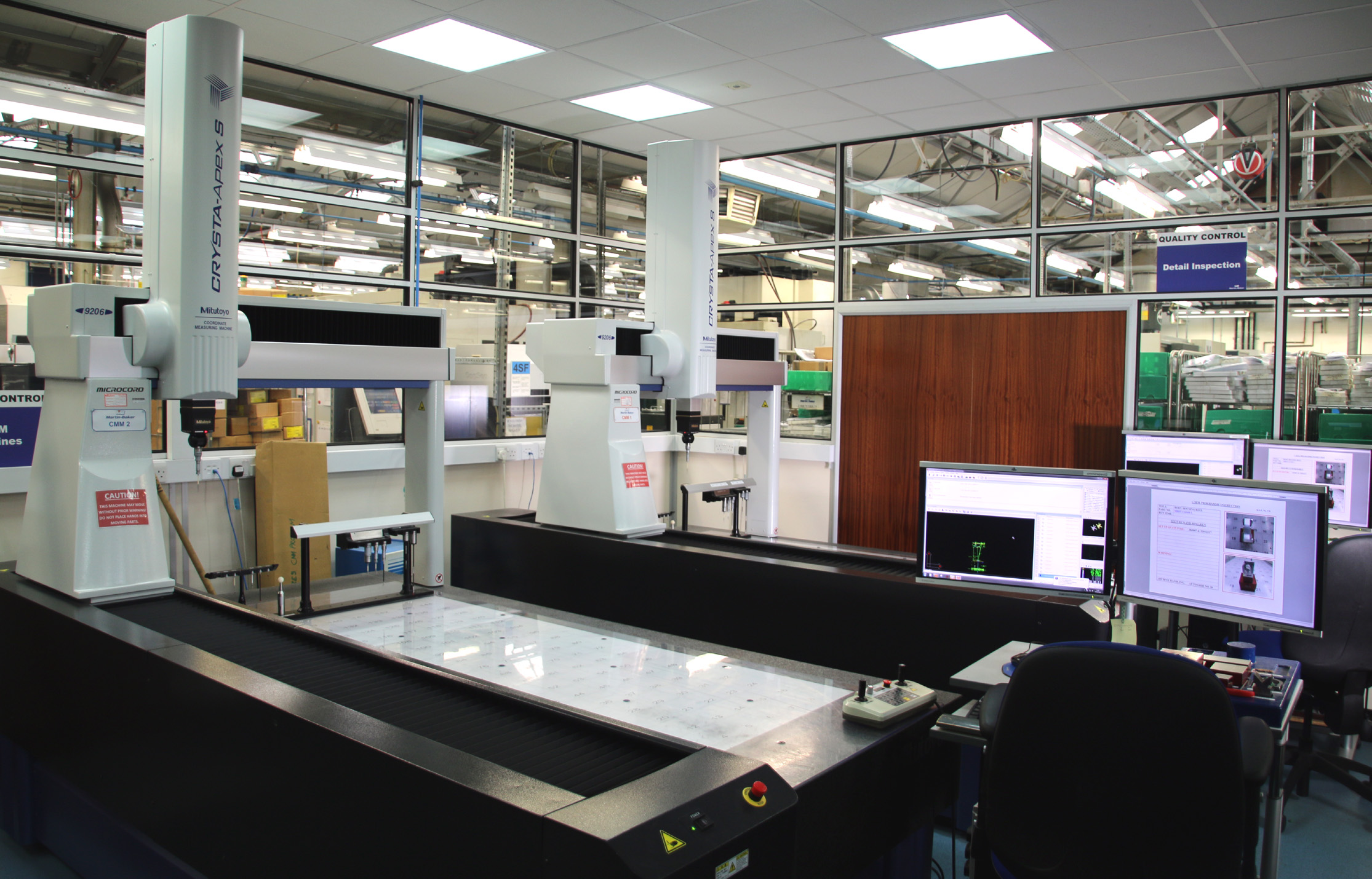

From a hardware perspective, Martin Baker has two Crysta Apex 9206 CMM’s in its inspection department with another checking components at goods-in, whilst a smaller Crysta Apex 9106 CMM sits alongside the DMG Mori production cell on the shop-floor. The West London facility also has two CV3200 Contracer form measurement machines for inspecting contours and profiles as well as three SurfTest Extreme SV-3000 CNC surface roughness measuring machines.

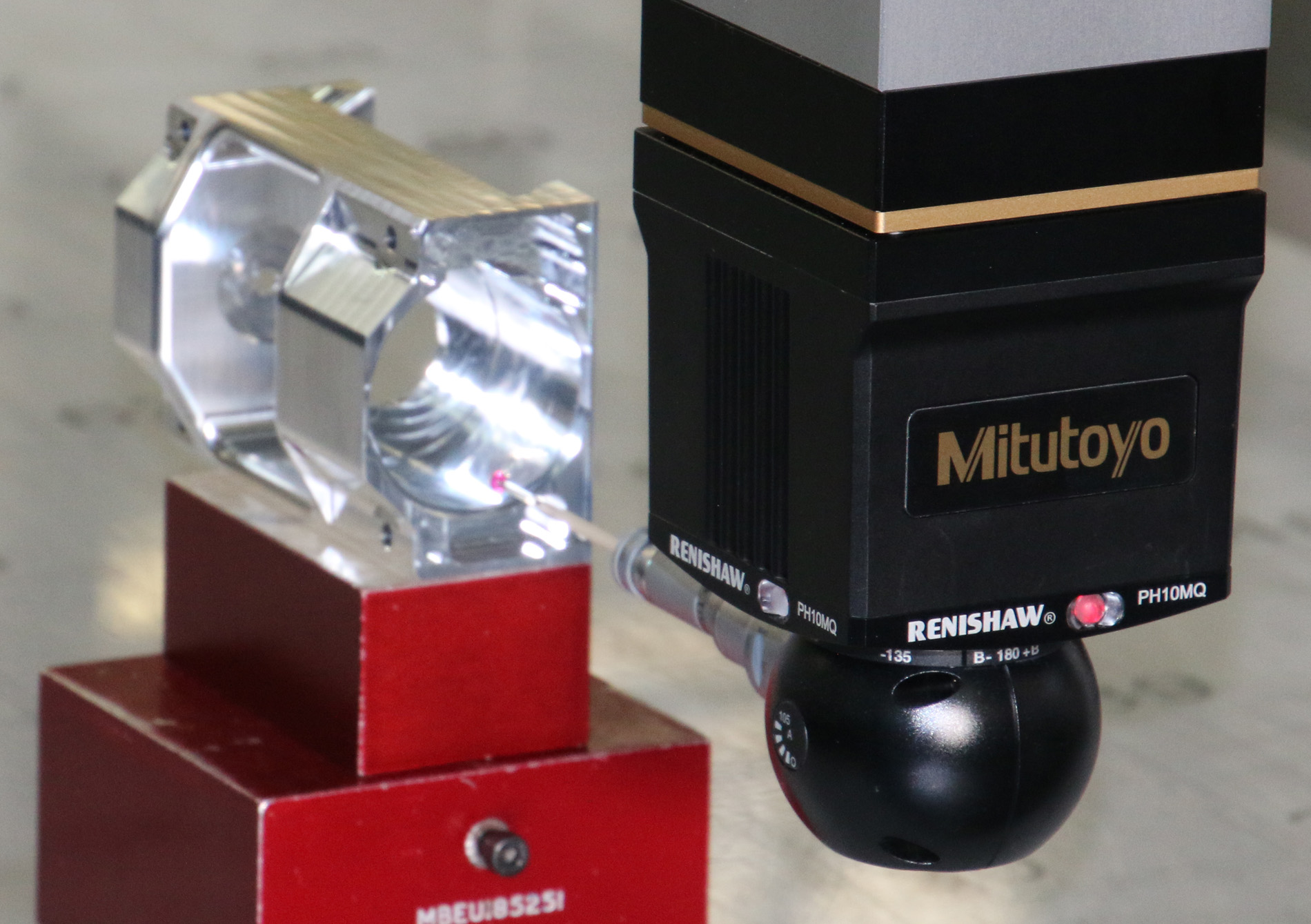

What makes this technology and configuration genuinely impressive at Martin Baker is the investment in peripheral equipment and software that works in complete synergy with the hardware. Each of the CMM’s has a standardised and comprehensive rack of probes and this includes the SP25 analogue scanning probe with the scanning software module that is part of the Mitutoyo M-COSMOS 3 software suite. For Martin Baker, the SP25 probe provides continuous contact with the workpiece and this improves the inspection cycle times whilst giving 100% inspection on free-form shapes. The circularity and concentricity of holes and bores is guaranteed with the constant probe contact that multiplies the measuring points, giving the customer complete confidence in its inspection processes.
