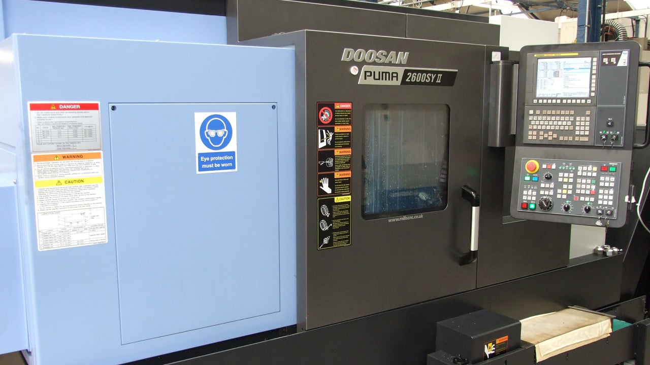

Puma 2600SY Mk II
The 10” chuck/76mm bar diameter Puma 2600SY Mk II is a versatile, multi-tasking lathe with a Y-axis, sub-spindle and driven tools. The Puma 2600SY MK II with its integrated mill/drill capabilities enables Mellish to machine small turned parts, like studs and nuts, to completion in a single set-up.
The machine was supplied with a bar feeder to ensure continuous production.
Says Mark Rattenberry:
“The Puma 2600SY Mk II is a high-productivity lathe that has helped us reduce part cycle times, improve part accuracies (as components no longer need to be transferred between machines), and help avoid production bottlenecks.”
