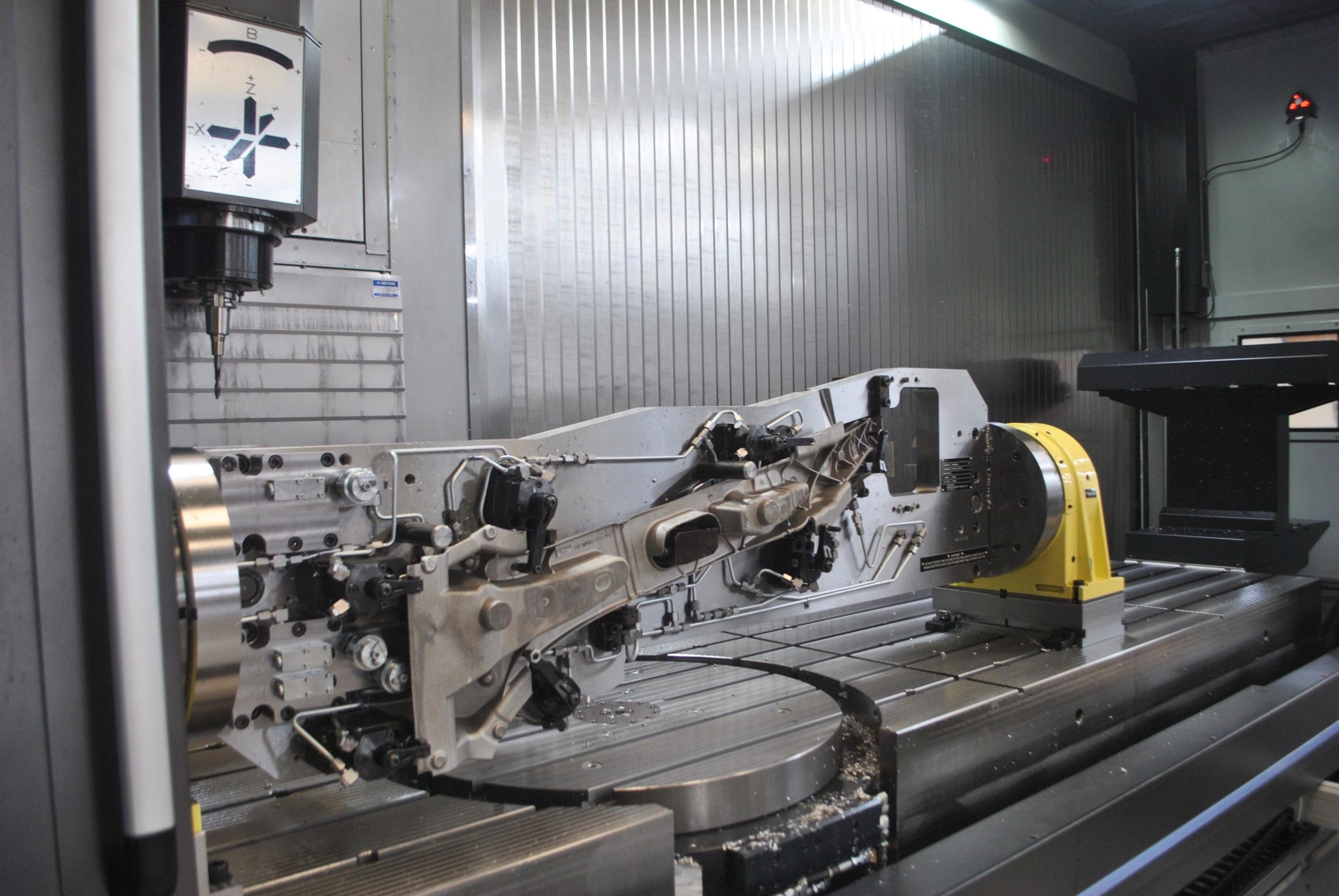

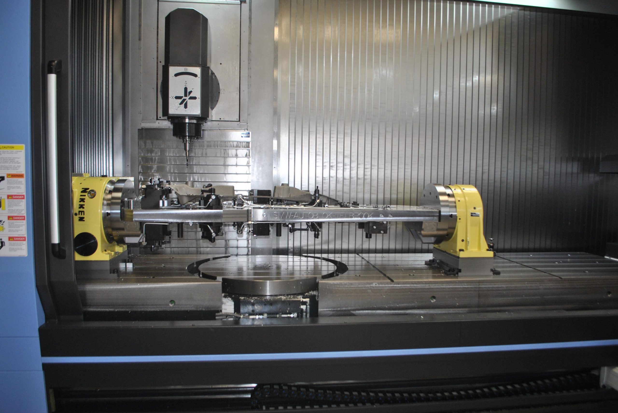

VCF 850LSR and the machining of the B. Pillars
The workholding designed for machining the left and right B. Pillars clamps each part securely in place, enabling high-precision machining operations to occur without deformation.
The B. Pillars are machined individually on the VCF 850LSR. Each part, which is long, thin and curved is held in place by two rotary tables and a trunnion plate.
The part is rotated (indexed) 90 degrees and then locked to allow the machining of each of its four sides (i.e., top, bottom and two sides) to occur.
Only one set up is required for all machining operations to be completed, and the fixture can be used to machine both the left and the right B. Pillars.
An innovative feature of the workholding solution is the ability to machine features through apertures and spaces designed in the trunnion plate.
Says Brandon Davies:
“To ensure we were able to meet our customer’s lead times and to help keep costs down we needed one workholding solution for machining both (left and right) parts, and to machine the parts in one hit.
“It was a tall order – but Mills delivered the goods.”

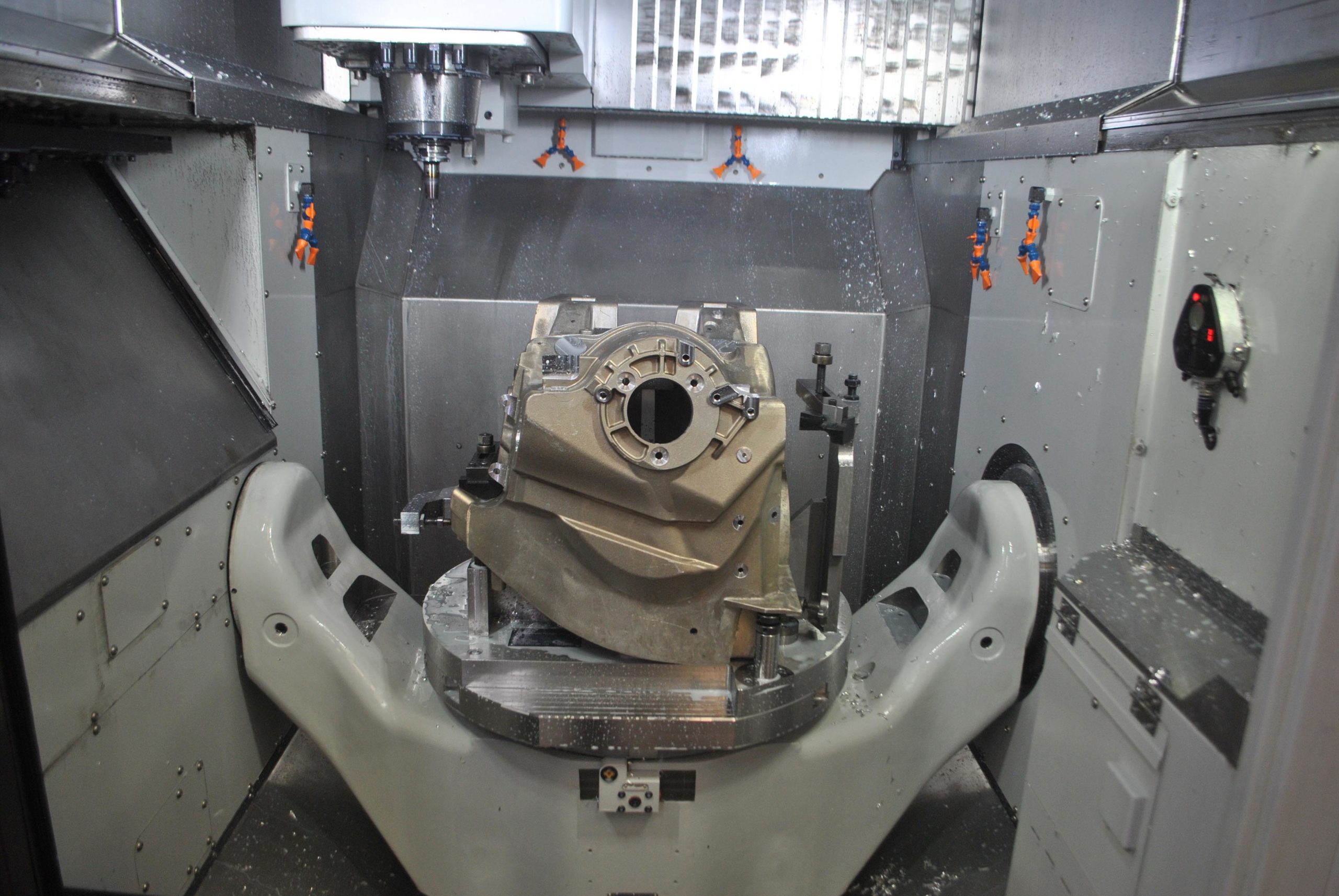

DVF 6500 and the machining of the suspension mountings
It was a similar situation with the DVF 6500 and the machining of the left and right front suspension mountings.
“A similarly innovative turnkey solution was developed for these parts.
“Specific issues that Mills had to take into account with the suspension mountings was the machining of blind and angled holes, and the use of long 300mm tools.
“The solution designed by Mills and its partners involves the use of three separate fixtures…one fixture each for completing first operations on the left and right suspension mountings, and the third (shared) fixture for undertaking the second operations on both mountings.”
