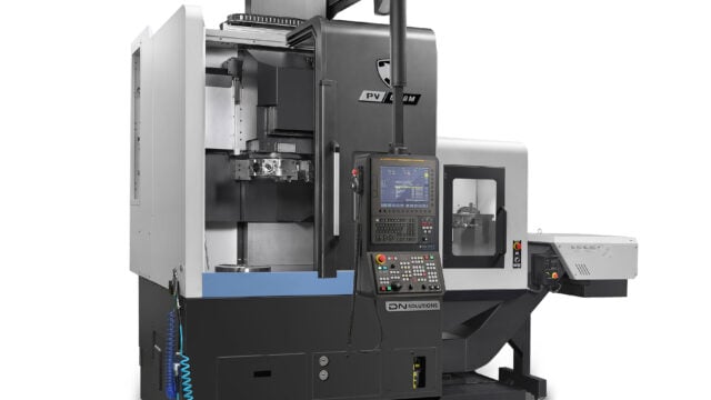

The 12” chuck DN Solutions’ Puma GT 3100 is a heavy-duty machine equipped with a 22kW/2,800rpm high-torque spindle, a 12-station servo-driven turret, a live-centre (MT5) tailstock and the advanced Fanuc 0iTP control with 15” iHMI touchscreen.
The machine supplied to CNC Technology also featured a parts catcher with conveyor, an auto tool setter and a FilterMist extraction unit.
The GT 3100 was installed at CNC Technology’s facility in January 2025 and has been in operation ever since.
Explains Steve Littlehales:
“We are delighted with our latest investment.
“The GT 3100, with its rigid design and construction and its high-torque spindle has allowed us to ramp up speeds and feeds and take more aggressive depths of cut without compromising quality. As a result, part cycle times and overall productivity and process efficiencies have improved.
“We have acquired a powerful, flexible and high-performance lathe that not only meets our immediate requirements but will stand us in good stead in the future – machining jobs for new and existing customers.”
