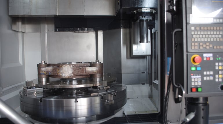

The VTS 1620M
The VTS 1620M is a large, rigidly-built vertical turning centre that has a maximum turning diameter of 2000mm, a maximum turning height of 1556mm, a large 1600mm work table with a maximum table load of 10000kg.
The box guideway constructed machine is equipped with a powerful 45kW/250rpm heavy-duty, high-torque table spindle featuring large diameter cross taper roller bearings and a twin gear drive that delivers high-rigidity and zero backlash for increased accuracy.
The machine weighs 30000kg and features a rigid X type cast Meehanite column structure that reduces deflection.
Says John Mullenger:
“The VTS 1620M is a solidly built machine and was ten tonnes heavier than other competitor machines we looked at.”
The VTS 1620M is also a versatile machine and has driven tooling capability that enables us to machine parts to completion in a single set-up. The machine’s ram rotary spindle (18.5kW/3000rpm) and servo-driven C-axis table enables the VTS 1620M to undertake high-accuracy milling, drilling and tapping operations.

“We’ve been impressed with the machine’s cutting capabilities. Parts can be machined efficiently and the machine’s driven tooling capabilities means we benefit from reduced cycle times. The VTS 1620M has helped us reduce production bottlenecks caused by us having to transfer parts between machines.”
Destec’s final requirement concerned the ergonomic design of the machine – in particular the efficient and safe loading and unloading of workpieces, and good operator visibility of the machining area.
Comments John Mullenger:
“There is good unrestricted access to the VTS 1620M’s working area that facilitates trouble-free workpiece loading and unloading. In addition, the machine’s large door and position of the control console provides good visibility to machine operators.”
