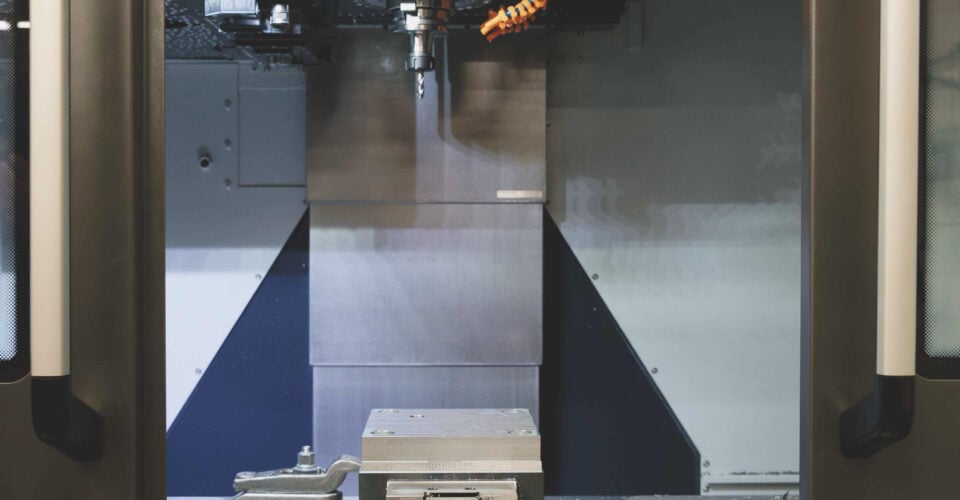

Since being installed, the Mynx 6500/50 II has been (and is being) used to machine valve-type components (for subsea applications), made from Inconel castings, for a long-standing customer and manufacturer of high-performance industrial pumps.
Programmed off-line and machined in small batches, these parts are approximately 400mm x 300mm in size, involve long and intensive roughing and finishing operations to complete each part and are characterised by their tight ‘tied up’ tolerances and stringent surface finishes.
Part processing times with the new Mynx 6500/50 II are significantly faster (up to 50%) than those achieved using the Mynx 540…justifying and vindicating the new machine tool acquisition.

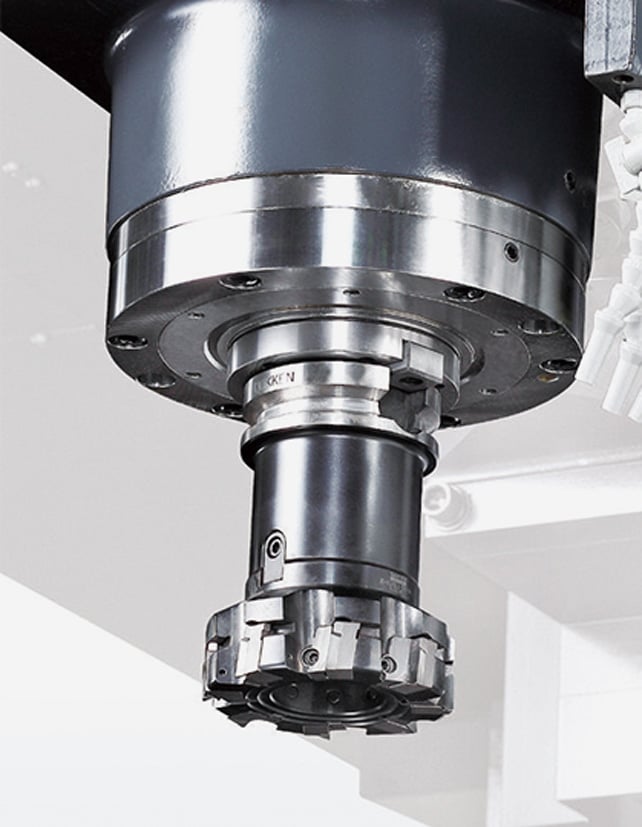

Bronte Precision Engineering’s new Mynx 6500/50 II vertical machining centre is equipped with a high-torque, gearbox-driven BT 50 spindle (30kW/6000rpm/617N-m), a 30-tool servo-driven tool changer with 2.5 second tool-to-tool changeover time, and a 1400mm x 670mm worktable with a 1300kg maximum table load.
The machine was supplied with the advanced Fanuc 0iMP control, 20 bar through-spindle-coolant capability and Renishaw OMP 600 and OTS workpiece and tooling probing systems.
