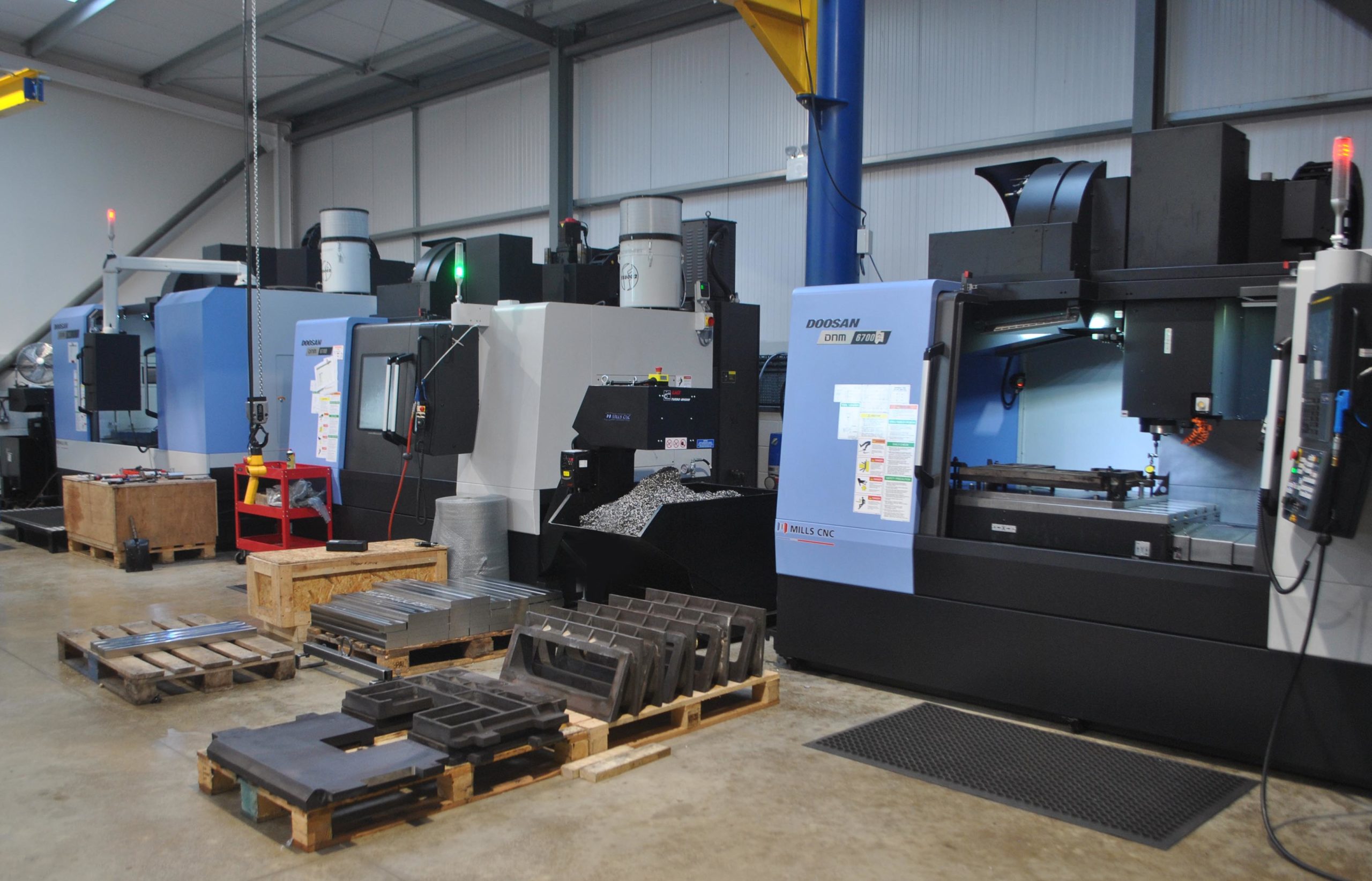

The four machines, now installed at the company’s modern 7,500sq. ft. facility in Market Deeping,
comprise a large-capacity DNM 750 II machining centre and a Puma GT 3100LM lathe equipped with a C-axis and driven tooling capabilities both delivered to the company in March 2019 as part of a turnkey solution, and two DNM 6700 machining centres which were acquired in October 2020 and June 2021 respectively.
The four machines provide PJ Innovations with state-of-the-art machining capabilities and are the centrepiece of the machine shop facility that was established, relatively recently, in 2019 with the primary purpose of enabling the company to machine, in-house, a range of specific parts for its highly regarded and globally recognised heavy-duty Dough Divider Rounder machines*.

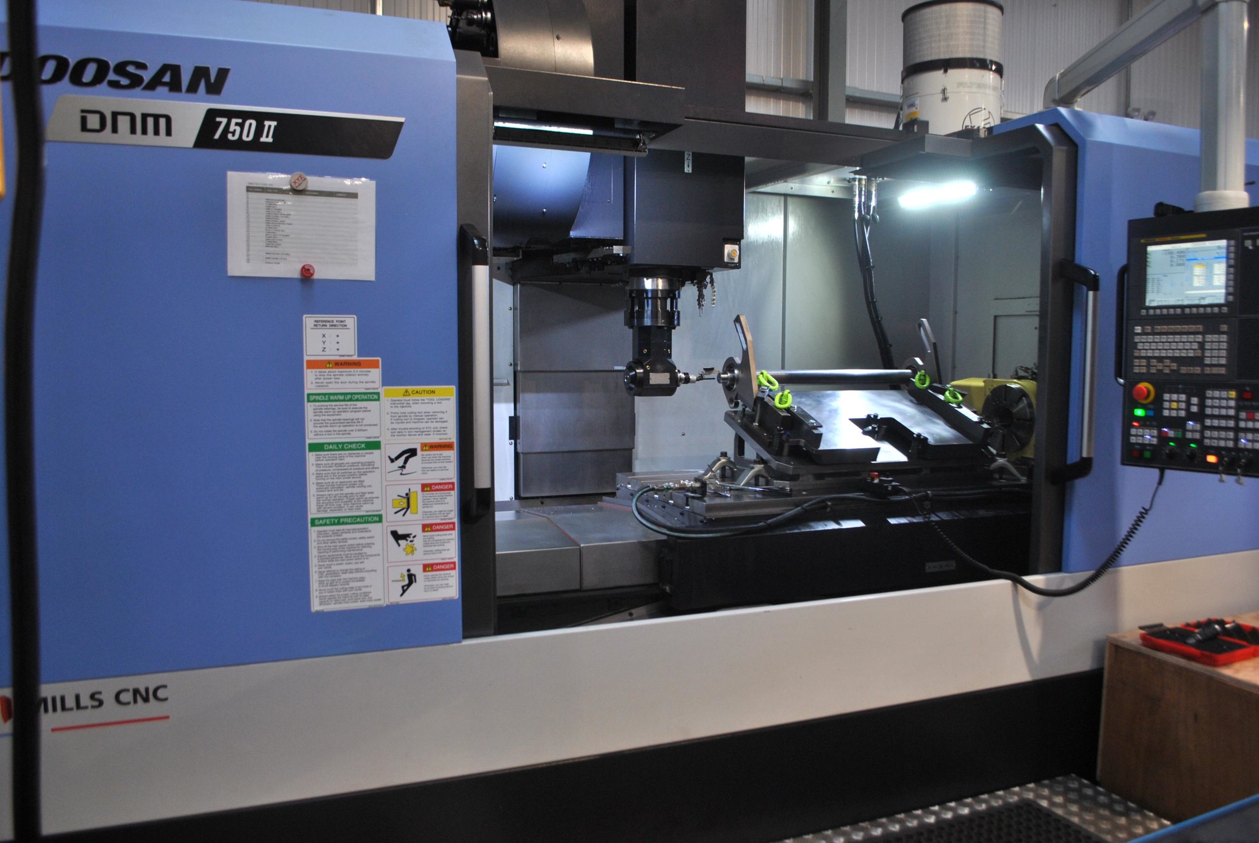

In 2019 a large-capacity, Fanuc-controlled Doosan DNM 750 II vertical machining centre equipped with a 8,000rpm high-torque BT 40 spindle and a Nikken 260 rotary table with a TAT support unit was installed in PJ Innovations’ machine shop facility along with a 12’ chuck Doosan Puma GT 3100LM multi-tasking lathe equipped with a 2,800rpm spindle, a C-axis, driven tooling capability and a hydraulic steady rest.
Both machines were delivered as part of a turnkey solution designed and developed, over a number of months, by Mills CNC’s pre-sales application engineers in conjunction with production staff from PJ Innovations.
Says Nick Lormor:

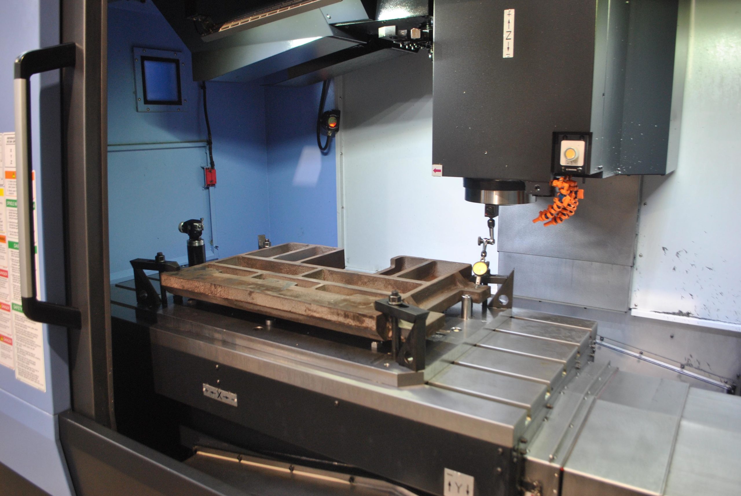

“We use the two Doosans to machine performance-critical core parts of our Divider Rounder machines – namely base plates (part of the top box assembly) on the DNM 750 II, and long shaft/cylindrical part segments (part of the rotating head assembly) on the Puma GT 3100LM.”
The base plates and segments can vary in size and specification, according to customer needs and requirements, but all are made from cast iron or stainless 316 and involve high metal material removal rates achieved though high accuracy roughing operations.
These precision parts are machined to tight to tolerances – typically to a couple of thousandths of an inch.
Continues Nick Lormor:
“Key elements and features in the machining processes, developed with Mills CNC, involved innovative workholding and the use of non-conventional tooling (e.g., bespoke angled head cutters). Mills’ knowledge and expertise has been invaluable in helping design a robust, reliable and repeatable machining process for these parts.”
The success of the first turnkey project and the learning curve travelled by staff (i.e., setting up jobs, programming and operating different machine tools, understanding different machining processes, knowing about the machinability of materials etc., has seen the company increase its headcount and invest in two more Doosan machines in 2020 and 2021 respectively.
The two new machines – both Fanuc-controlled DNM 6700 vertical machining centres with 12,000rpm spindles and 30 position ATCs – are being used to machine different Divider Rounder machine parts e.g., hoppers etc.
