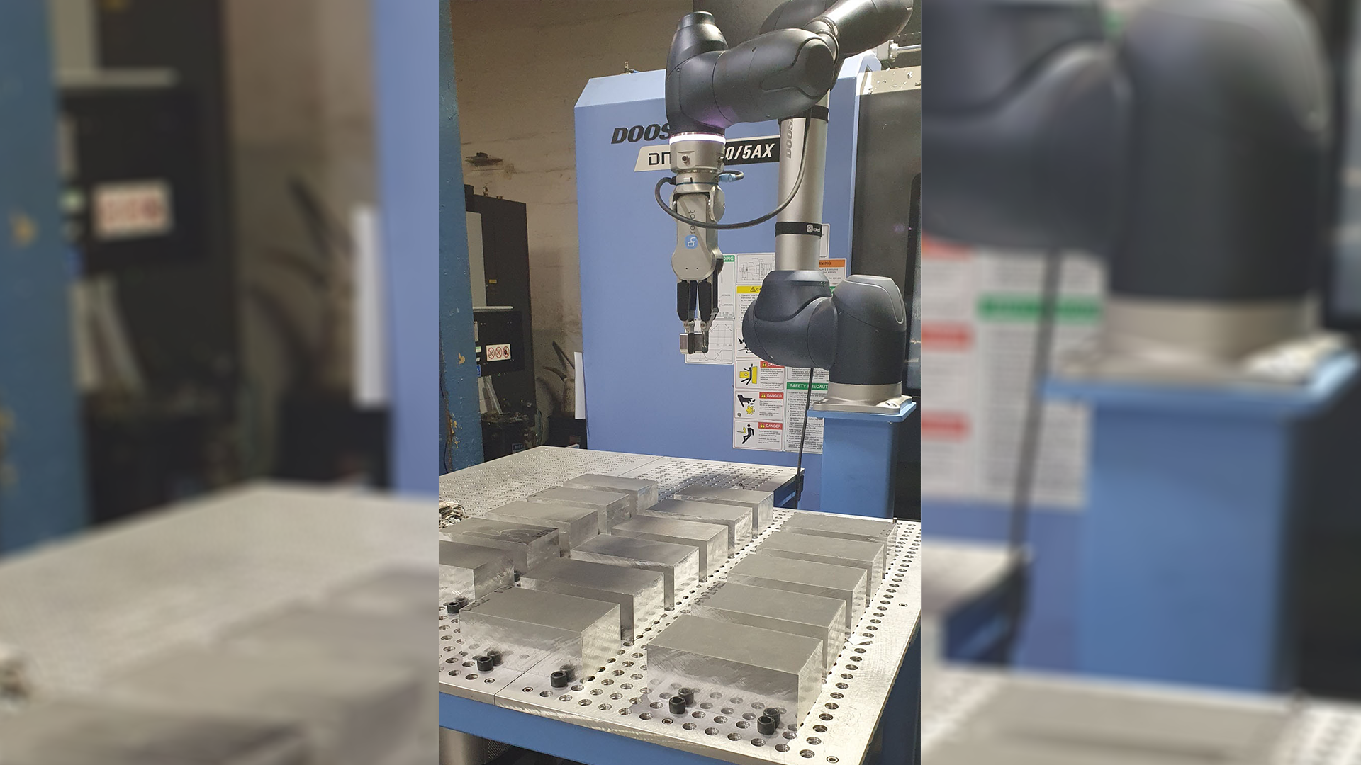

To undertake what are essentially machine tending operations NPI worked alongside Mills CNC Automation engineers to identify the right cobot for the job. The cobot selected (based on the dimensions and weight of parts machined on the DNM 350 5AX) was the M1013 model.

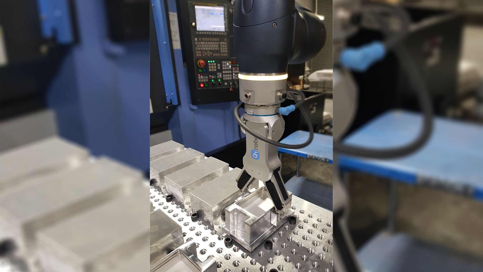

The M1013 has a 10kg maximum payload and a 1.3 metre reach. The cobot also features six high-torque sensors that provide ‘best-in-class’ collision protection and was supplied to NPI with a controller, a teach pendant, a RG6 (OnRobot) gripper and a Schunk workholding package.
Situated adjacent to the DNM 350 5AX which, as part of the installation was fitted with an automatic door opening/closing facility, the cobot is programmed to pick up blanks positioned on a peg table and load them, in turn, into the machine where they are machined to completion.
Once machining operations have been completed the cobot takes the finished (machined) component from the machine and places it back on the peg board in its predetermined position. This cycle is then repeated, with no operator intervention, until all the parts have been machined.
Parts machined on the DNM 350 5AX are typically made from aluminium. They vary in size i.e. 15mm x 15mm x 15mm at one end of the spectrum through to 150mm x 150mm x 20mm at the other.
Cycle times can be as short as 2 minutes or up to 60 minutes depending on part size, complexity and features.
