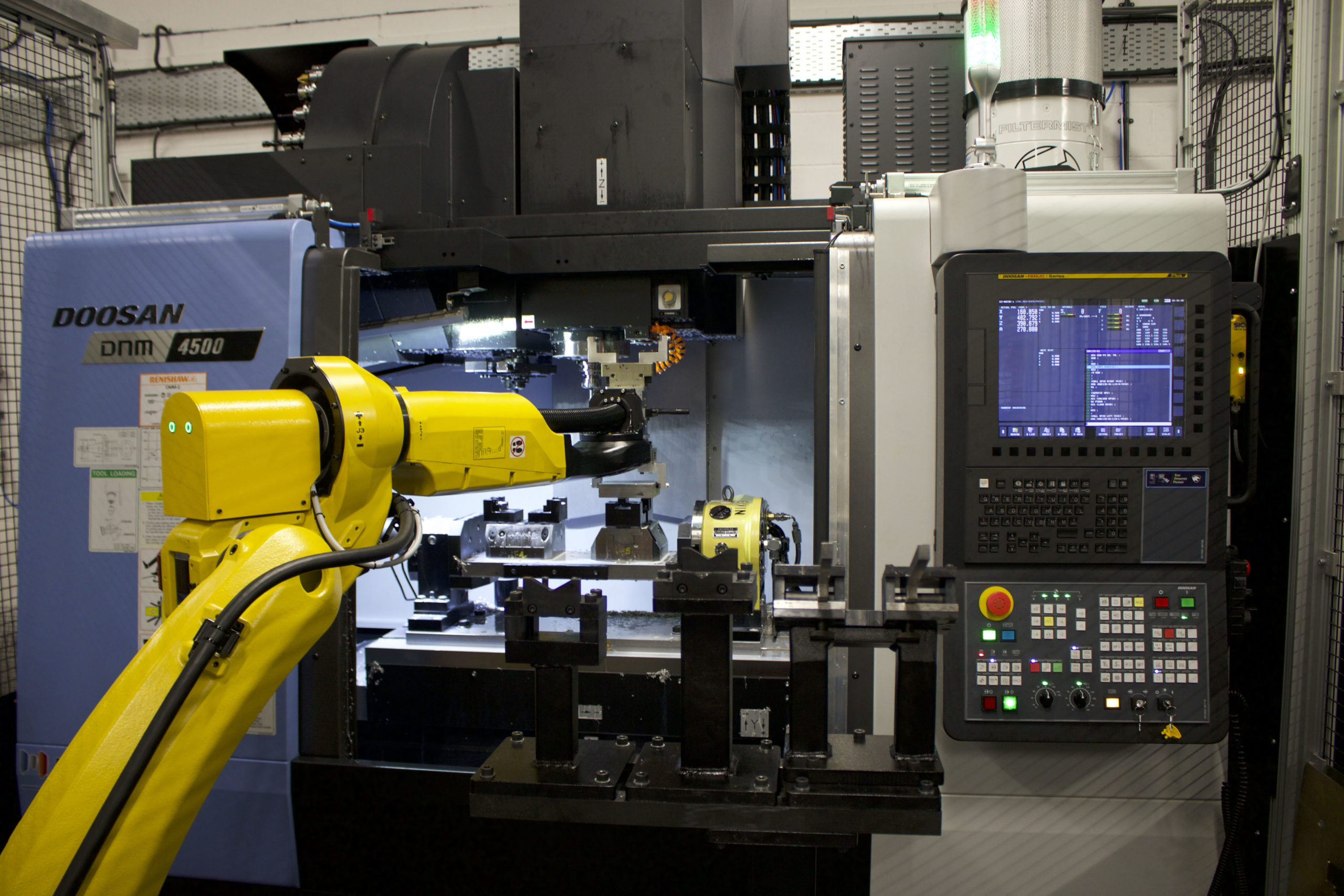

The automation cell comprises a new Puma 2600SY lathe and a DNM 4500 vertical machining centre. Both machines are equipped with the latest Fanuc I Plus controls and have automatic door open/door close capability.
Puma 2600SY II lathe:
The 10” chuck/81mm bar capacity box guideway Puma lathe is equipped with a +/- 52.5mm Y-axis, a 22kW/4000rpm built-in main spindle, a 15kW/6000rpm sub-spindle, and a 12-station (24-station indexing) servo-driven turret with 5,000rpm driven tooling capability.
The machine was supplied with Hydrafeed MSV 80 bar feeder to increase, and capitalise on, the lathe’s flexibility and productivity potential.
DNM 4500 machining centre:

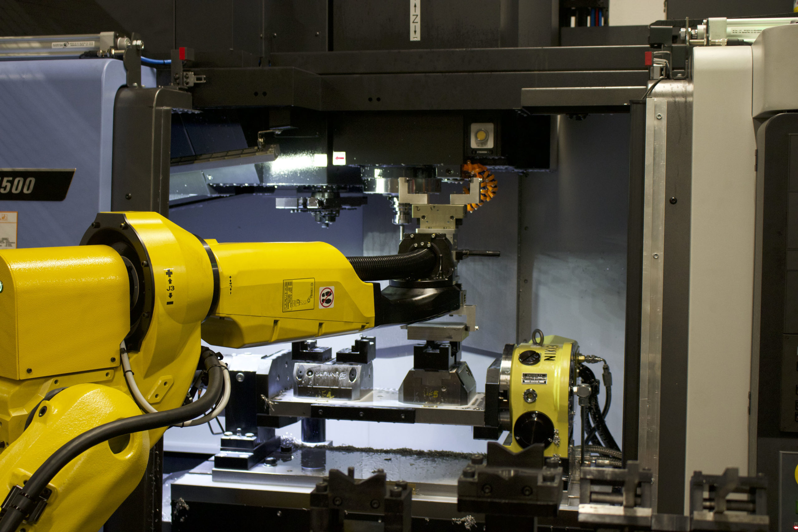

The machining centre features an 18.5kW/12,000rpm spindle, a 60-position automatic tool changer and was supplied with a Nikken 4th-axis unit for precision indexing and Renishaw probes for in-process measurement and inspection.

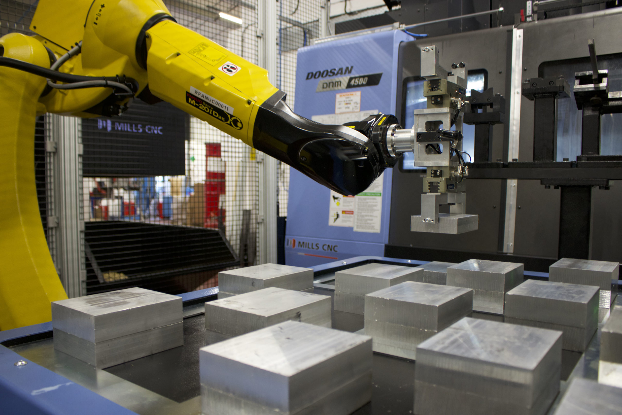

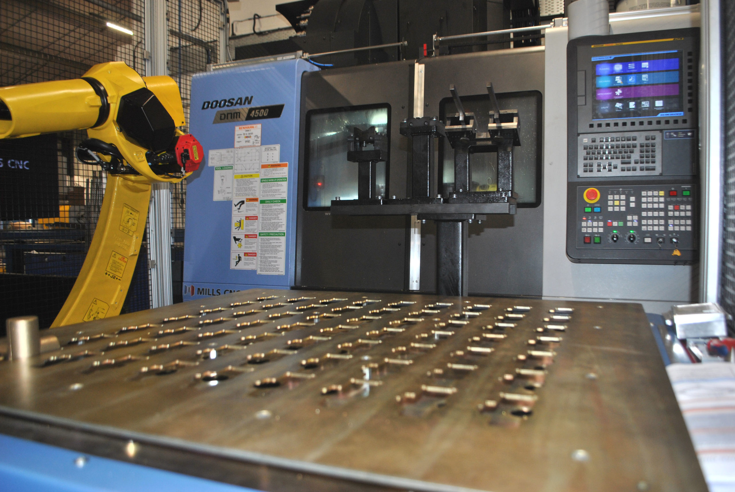

The automation element is provided by a heavily customised SYNERGi Sprint system comprising a Fanuc industrial robot (25kg payload) and a 900mm x 900mm grid plate to hold the brass blanks and aluminium billets (waiting to be machined), and machined valves and enclosures.
A robot linear rail, running between the Puma lathe and the DNM machining centre, enables the robot to service both machines.
Other cell features include:
– Safety caging and gates that a) enclose the cell within the machine shop; b) isolate the Puma from the robot and the DNM machine enabling it to be used, independently, for either chucking or bar fed work; c) enable the robot and DNM 4500 to be used for automated machining of the enclosures – i.e., operating, on occasions, as a cell within a cell.
– Different end-effectors (pneumatic grippers) to hold and transfer the pre-machined parts from the grid plate to the machine(s), and the machined parts back onto the grid plate.
– Pre-cut (laser machined) multi-socket inserts that hold both the blanks and machined valves, and the billets and machined enclosures securely, in place, on the grid plate.
– A part repositioning stand that a) enables the robot to take the valve parts from the Puma 2600SY II lathe, place and reorient them, and transfer them over to the DNM 4500 for machining features that include pressure switch ports etc., and b) take the enclosures out of the DNM 4500, reorient them on the stand and return them back to the DNM for machining the enclosures’ reverse sides.
